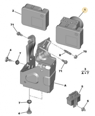

So the parts are no longer available new from Peugeot - but there are 2:
Item 1 in the diagram:
4541 Z3 or
4541 Z4
The difference being one is pre-configured to the vehicle and the other is configured afterwards - but I've supplied both.
4541 Z3 or
4541 Z4
