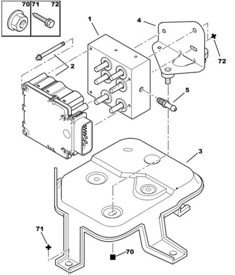

So the parts are no longer available new from Peugeot - but there are 2:
Item 1 in the diagram:
4541 Z3 or
4541 Z4
The difference being one is pre-configured to the vehicle and the other is configured afterwards - but I've supplied both.
4541 Z3 or
4541 Z4

Re: Peugeot 207 ABS pump
Yes, if there’s nothing wrong with your ECU best to keep,it then you can just attach it to the new block and refit,
454142 is the block part number.
