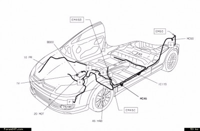

For this C4 model, there were several parking ECUs depending on build date, but unlike the C5, the one you currently have for rear only would seem to be configurable for front and rear parking options and would not appear to require another ECU.
Obviously you will need the relevant sensor supports and trim in addition to the sensors.
It would also seem that you already have the supplementary front harness in place according to your VIN to answer your question.
See the second diagram for the harness which is item (1). The second harness (2) is for AFIL only.

Harness number (1) has a part number of 6568 86. This is the harness that should be fitted to your car already.
