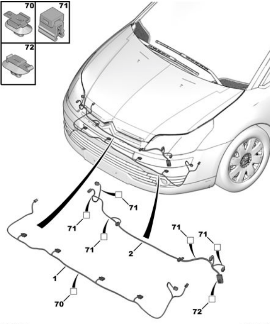

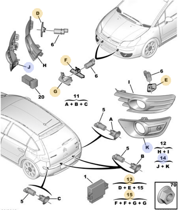

For this C4 model, there were several parking ECUs depending on build date, but unlike the C5, the one you currently have for rear only would seem to be configurable for front and rear parking options and would not appear to require another ECU.
Obviously you will need the relevant sensor supports and trim in addition to the sensors.
It would also seem that you already have the supplementary front harness in place according to your VIN to answer your question.
See the second diagram for the harness which is item (1). The second harness (2) is for AFIL only.

Harness number (1) has a part number of 6568 86. This is the harness that should be fitted to your car already.

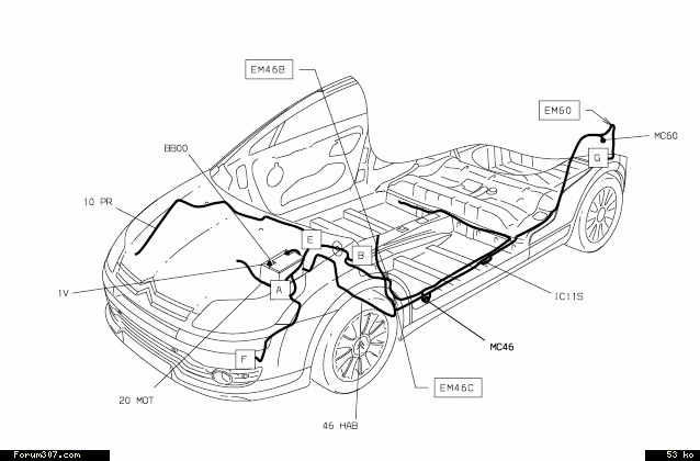

There are loads of harnesses - Engine, Supplementary, Front, Fascia, Intermediate, Seat Belts, Rear, Tailgate and others - so I can't tell you which one of these you need unfortunately. It would be a hell of a job to change the harness now - that's why they do a repair kit as they are not easy to replace once the car is assembled with all the trim in place.
Just to make it harder, the harnesses are fifferent for left and right hand drive models and again on 3 / 5 door models and again on the build date.
If I had the VIN from a C4 of the same model, engine and year with the Front & Rear factory fitted Parking Assistance system already fitted - I would at least be able to compare the harness part numbers and see which ones are different.....

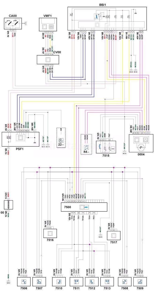

Re: C4 VTS - Adding front parking sensors
There should I think be a wiring harness diagram which gives details of which harness each circuit connects through (on a car with the option fitted), this would at least tell you which harnesses and connector blocks to inspect.
