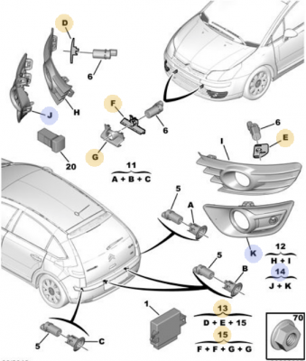

My 2006 2.0 16v C4 VTS has rear parking sensor. I want to add front parking sensor. IIRC I read in a forum that in C4 VTS the harness for front parking sensors is installed and only the sensors should be installed as well as configuring the BSI . How can I know if the harness in installed ?

For this C4 model, there were several parking ECUs depending on build date, but unlike the C5, the one you currently have for rear only would seem to be configurable for front and rear parking options and would not appear to require another ECU.
Obviously you will need the relevant sensor supports and trim in addition to the sensors.
It would also seem that you already have the supplementary front harness in place according to your VIN to answer your question.
See the second diagram for the harness which is item (1). The second harness (2) is for AFIL only.

Harness number (1) has a part number of 6568 86. This is the harness that should be fitted to your car already.

I checked online at Citroen service it my car includes that harness

So once you have the parts you just need to reconfigure the Parking Assistance ECU for Front and Rear. You may also need to configure the Head Unit ECU also to account for the change. I'll check later.

Can the Harness (6568 86 ) be seen through the grill of the front bumper , I looked for it through the front bumper gill and didn't find it

I doubt it, the harness is probably tucked up behind the bumper - and as you don't already have the front obstacle detector sensors fitted, there won't be any reason for the wiring to be dropped down at each sensor point - so the sensor wiring drop down wires may be clipped / tied to the main loom. A bit of investigation work will be involved.
