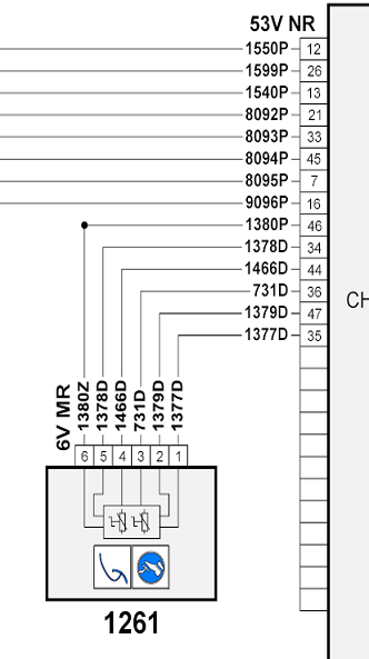

So the Throttle Position Sensor 1261 (built into the Accelerator pedal) should have a brown 6 pin connector. This goes to the Engine ECU, 53 Pin Black connector as shown below with pins:

Wiring
1380Z: + 5 volt accelerator pedal position indicator power supply
1378D: Accelerator pedal 2 position info
1466D: accelerator pedal 2 position earth
731D: accelerator pedal point of resistance / signal
1379D: accelerator pedal position earth
1377D: Accelerator pedal 1 position info

Thats great - thankyou. I have an auto electrician coming to go through it soon. I wonder if you have access to similar chart for the throttle position sensor also? The expected voltages / resistance etc of each would be a great help. ( Sorry I know its a big ask.)
x 6957
Re: 2015 C5 DW10FD WIRING DIAGRAM NEEDED
That is the throttle position sensor - it is built into the accelerator pedal. This then goes direct to the Engine Management ECU.

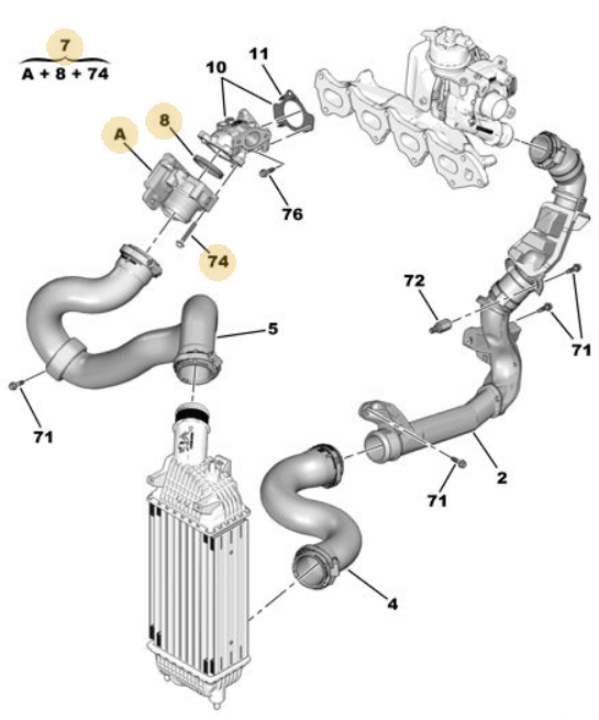

Hi Marc, I'm talking about the butterfly throttle on the intake. Theres a throttle position sensor on it with a 5 pin pigtail connecter. Its the 3 parts required for throttle response. Accelerator, Throttle position sensor on intake and of course the ECU. I have replaced all 3 so just need to fathom out wiring between each now. (I actually suspect wiring from intake most -as after fiddling one time there -it behaved for a while.)
x 6957
Ok, so we refer to that as the Air Doser, part of the Turbo air piping, hence the confusion.
Part A in the diagram.
As for the diagram - I will be sending you a PM shortly.
