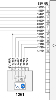

So the Throttle Position Sensor 1261 (built into the Accelerator pedal) should have a brown 6 pin connector. This goes to the Engine ECU, 53 Pin Black connector as shown below with pins:
Wiring
1380Z: + 5 volt accelerator pedal position indicator power supply
1378D: Accelerator pedal 2 position info
1466D: accelerator pedal 2 position earth
731D: accelerator pedal point of resistance / signal
1379D: accelerator pedal position earth
1377D: Accelerator pedal 1 position info
Wiring

Thats great - thankyou. I have an auto electrician coming to go through it soon. I wonder if you have access to similar chart for the throttle position sensor also? The expected voltages / resistance etc of each would be a great help. ( Sorry I know its a big ask.)
- x 6948
Re: 2015 C5 DW10FD WIRING DIAGRAM NEEDED
That is the throttle position sensor - it is built into the accelerator pedal. This then goes direct to the Engine Management ECU.

Oh ok. Seems i’m on the wrong track then? My code reader is saying discrepancy between the two potentiometers from the throttle position sensor. So perhaps I should concentrate on replacing connectors and wires from accelerator to ECU - as your diagram 1261 above.
I do appreciate the help you’re giving me.
