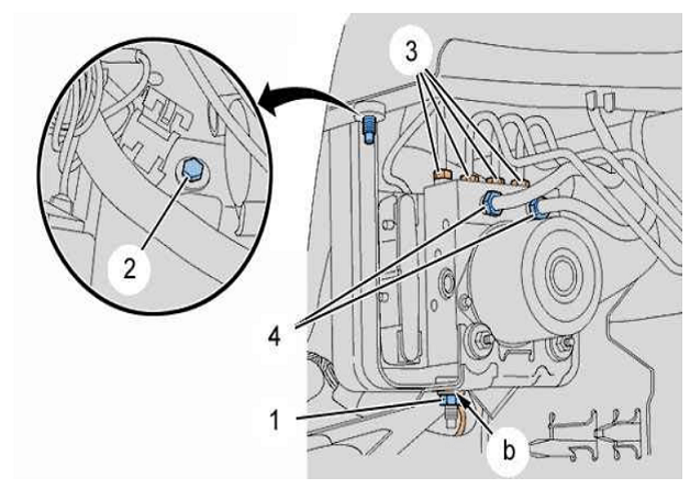

So you have a C4 PICASSO ESTATE - LEISURE 1.6 HDI 115 (DV6C) piloted manual gearbox 6.
So the correct Part Number for your Picasso is: 4541WP, item (1) below:

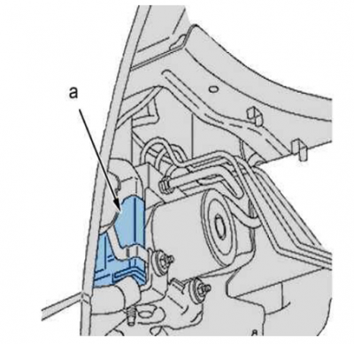

You'll need to remove the front left hand (passenger side) wheel, and splash guard to access it:
A word of warning - make sure you record or take a screenshot of all the existing parameters in the ABS / ESP ECU before replacing the unit! There are several options when reconfiguring - if you get the wrong ones, it will not function. This mist be done before removing the old unit.

No worries - using the diagram you may be able to get a photo of the label without touching the unit with a bit of luck. Once we have that, it should be a lot easier to get the exact one.
At the end of the day, you really don't want to be messing with all the hassle of replacing these and the bleeding procedure to have to do it all again if it's not right. Best to get the correct one before you start. I just hope it's that and not a connection to one of the wheel sensors that is causing a wobbly.
