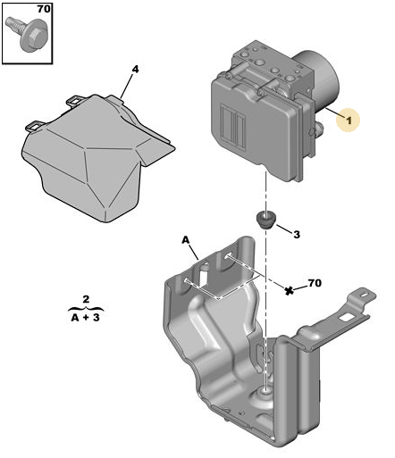

So you have a C4 PICASSO ESTATE - LEISURE 1.6 HDI 115 (DV6C) piloted manual gearbox 6.
So the correct Part Number for your Picasso is: 4541WP, item (1) below:

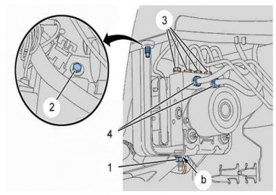

You'll need to remove the front left hand (passenger side) wheel, and splash guard to access it:
A word of warning - make sure you record or take a screenshot of all the existing parameters in the ABS / ESP ECU before replacing the unit! There are several options when reconfiguring - if you get the wrong ones, it will not function. This mist be done before removing the old unit.

There are 2 different systems -
An ESP System and ESP with ASR+ which is a later traction control, so the unit must be correct. 4541WP is the correct one - but unfortunately as is common with ebay sellers they tend to rope together the part numbers as they haven't got a real clue what the differences are and why they are different parts. So I can't give you an alternative number - but if you can take a picture of the label on your unit, it will have the correct long number on it starting '96**** etc'
The modules changed several times and the one you need is from build date 12383 (4th October 2010). If you get the long number beginning '96******' then that will help ensure you get the correct replacement.

No worries - using the diagram you may be able to get a photo of the label without touching the unit with a bit of luck. Once we have that, it should be a lot easier to get the exact one.
