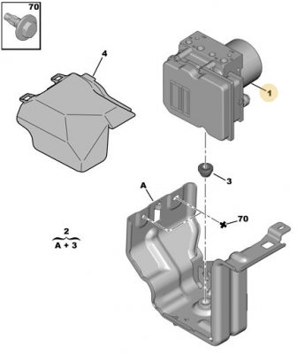

So you have a C4 PICASSO ESTATE - LEISURE 1.6 HDI 115 (DV6C) piloted manual gearbox 6.
So the correct Part Number for your Picasso is: 4541WP, item (1) below:
You'll need to remove the front left hand (passenger side) wheel, and splash guard to access it:
A word of warning - make sure you record or take a screenshot of all the existing parameters in the ABS / ESP ECU before replacing the unit! There are several options when reconfiguring - if you get the wrong ones, it will not function. This mist be done before removing the old unit.

There are 2 different systems -
An ESP System and ESP with ASR+ which is a later traction control, so the unit must be correct. 4541WP is the correct one - but unfortunately as is common with ebay sellers they tend to rope together the part numbers as they haven't got a real clue what the differences are and why they are different parts. So I can't give you an alternative number - but if you can take a picture of the label on your unit, it will have the correct long number on it starting '96**** etc'
The modules changed several times and the one you need is from build date 12383 (4th October 2010). If you get the long number beginning '96******' then that will help ensure you get the correct replacement.

No worries - using the diagram you may be able to get a photo of the label without touching the unit with a bit of luck. Once we have that, it should be a lot easier to get the exact one.
At the end of the day, you really don't want to be messing with all the hassle of replacing these and the bleeding procedure to have to do it all again if it's not right. Best to get the correct one before you start. I just hope it's that and not a connection to one of the wheel sensors that is causing a wobbly.
