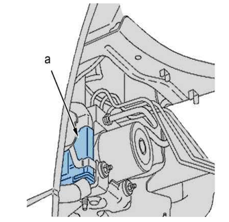

You'll need to remove the front left hand (passenger side) wheel, and splash guard to access it:
A word of warning - make sure you record or take a screenshot of all the existing parameters in the ABS / ESP ECU before replacing the unit! There are several options when reconfiguring - if you get the wrong ones, it will not function. This mist be done before removing the old unit.

No worries - using the diagram you may be able to get a photo of the label without touching the unit with a bit of luck. Once we have that, it should be a lot easier to get the exact one.
