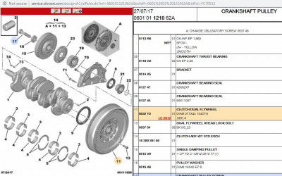

GiveMeABreak wrote: ↑17 Apr 2019, 22:28 None of those are correct. Never use your registration, only 60% reliable at best. Always get the ODM part number and use that to ensure you get the correct parts.
The Flywheel is actually 277 as you can see under part number 11.
The first part numbers are the OEM ones and where there is another > 3 yrs that means an equivalent part for older cars that is generally cheaper. Parts with ‘RP’ in front of them are the later replacement part numbers that have superseded the original part number.

From your VIN:
C5 II 5 DOOR ESTATE 2.0 HDi 138 particle emission filter Manual gearbox 6
RPO no.=10581
For the DMF, replacement is 0532T0*** (shown as available): This is dimensioned at 277mm diam.
And for the Clutch Kit, you have a choice of two as shown (and both available): ________________
*** Alternative to this part is listed 0532X7 + 2052P3 : 2052P3, though, shows up as a Clutch Kit, fitted to several vehicles, eg As 0532T0 is shown as available, this looks to be the one to go for, otherwise be guided by your Citroen parts counter.
Cannot vouch for alternative makes or aftermarket units, especially in this case where more than one unit seems to have been fitted over time.
Apologies for any overlap with Marc's information. It's had two of us doing some delving.
Edited to correct 5032X7 to 0532X7

Thank you very much. As said the 0532-X7 is the new replacement for 0532-T0. Somewhere there is a typo, becuse also you wrote 5032X7 now, like I did earlier, and found nothing. But with 0532X7 I find flywheels on various auto-part sites.white exec wrote: ↑18 Apr 2019, 16:27 From your VIN:
RPO no.=10581
________________
*** Alternative to this part is listed 5032X7 + 2052P3 :
I can find no listing for any vehicle for that first number.
but it might need to be twinned with 5032X7 (whatever that is).

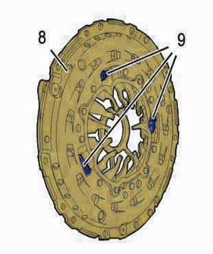

So this story is continuing. The LuK RepSet requires some special LuK tool that I don't think my friend mechanic has. It states in the article info that special LuK tool is required. Price of tool is 500 €. I think it has something to do with the RepSet beeing self-adjusting.

It's because the LUK clutch has an automatic wear adjustment device that requires a special tool for refitting.
(8) Automatic play adjustment mechanism.
(9) Compensation springs.
Your engine code is RHR - so make sure it is compatible if getting something else.
