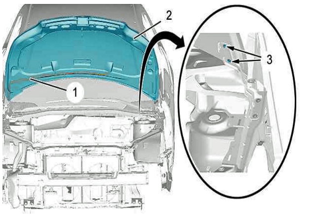

Re: Hood hinge replacement
Ok, this is to remove the bonnet only:
Uncouple the windscreen washer hose ( 1).
Slacken the bolts (3).
Remove:
The bolts (3)
The bonnet (2)
The other part I was looking at concerning the centring was for the side wing supports.
