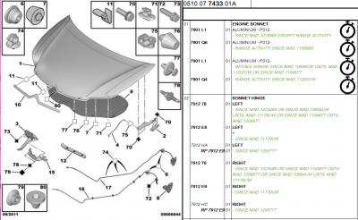

The diagram is below - the bonnet hinges are item number 2 - HOWEVER - for your build date, they do not list this as a part.
Your DAM number (build date) is 10181. None of the parts listed are for your vehicle as you can see, so I'm not sure what the significance of this is. Perhaps they were welded on to your car? When I use your VIN, item 2 is not available.

yes, those look like they are the part No 2 in my diagram with the bonnet stay shown. They look to have 3 bolts holding them on (part 70), but odd that they are not shown as available separately for your model.
