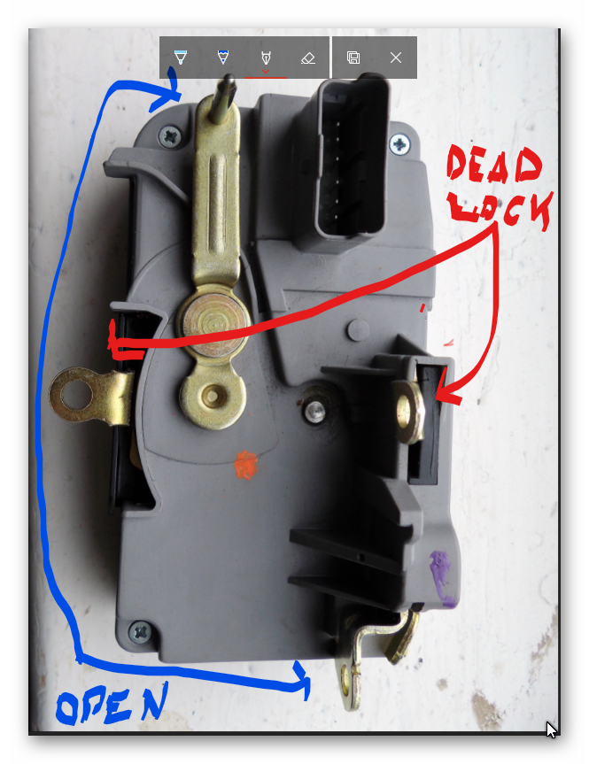

Re: door lock failure
This is a C8/Synergie RH door lock but the picture might help the dead lock levers are pulled down to lock and up to unlock
- Posts: 8186
- x 2943
Incidentally the lock pictured is new and sitting on my shelf if anyone needs it, Part number 9136.J7 Synergie and Dispatch from RPO 08561 maybe others.

- Posts: 8186
- x 2943
I knew they were different Mark, just thought that the levers to pull might be the same, as he's already got the trim off it might help.
- Posts: 42019
- x 6955
Righto - a good close up of the mechanism anyway Gibbo.
