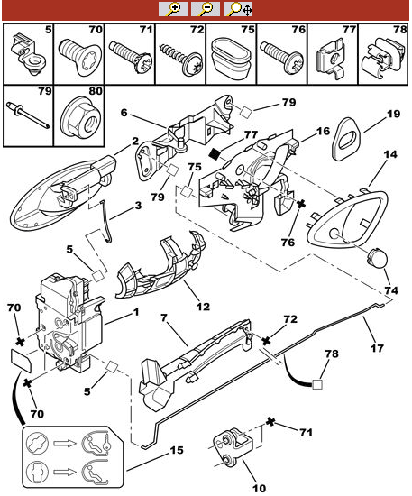

Here's the diagram from a MK I C5 Saloon. It may help with identifying the internals.

Re: door lock failure
This is a C8/Synergie RH door lock but the picture might help the dead lock levers are pulled down to lock and up to unlock
I knew they were different Mark, just thought that the levers to pull might be the same, as he's already got the trim off it might help.
- x 6945
Righto - a good close up of the mechanism anyway Gibbo.
