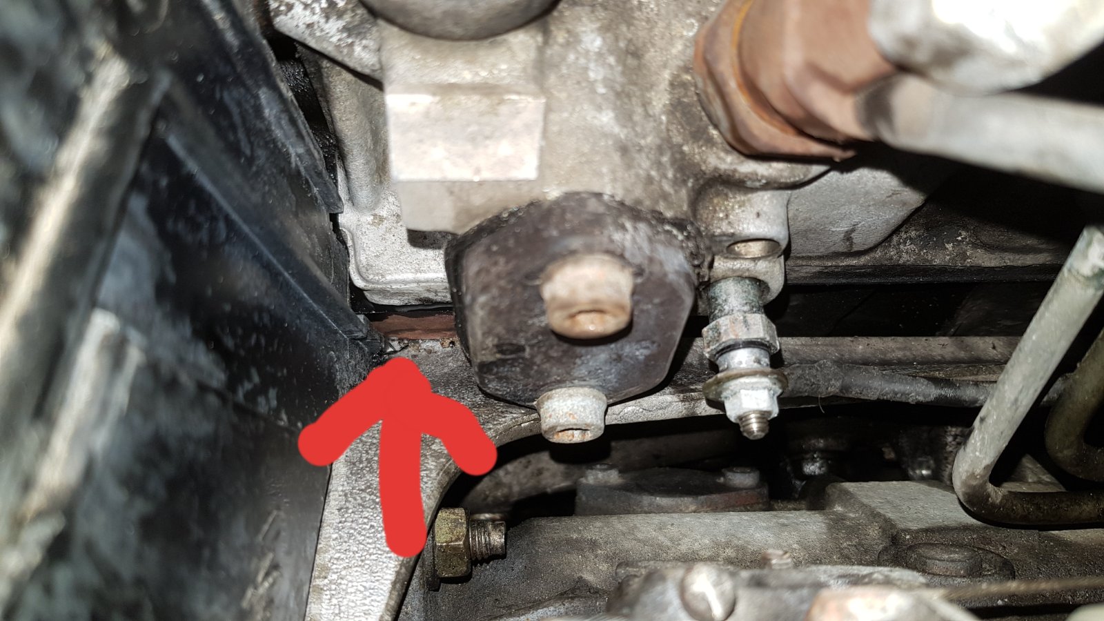

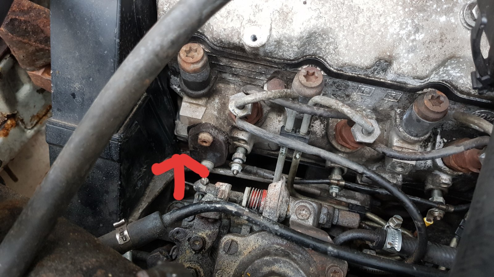

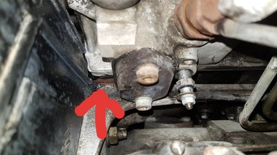

Weeping oil in the area behind the fuel pump, cleaned it off for a better look, here's the pic I took after a couple of minutes idling. Any suggestions of possible cause/remedy appreciated.

There is an oil gallery right by there so it could be a failure of the head gasket causing it... It's not common but I have seen it once before...
Just before you condemn the gasket though, slip off the cambelt covers and check the camshaft oil seal is good and the oil is not coming from these and creeping down and exiting where you see it...

IIRC, there's an O-ring sitting in the head gasket, right in that corner. It's the high-pressure oilway that takes oil to the camshaft and valvegear. As the HG ages, the O-ring can bake hard and go leaky.
Overheating of the cylinder head doesn't help, which is why coolant level and thorough bleeding are important, to eliminate air pockets (=hotspots) in the head.
If removing the head, get it checked for flatness before refitting.

Urgh, I have a feeling the guys who fitted the engine overheated it - would explain my leaking heater matrix. Better have another cuppa before I go and have a look under the cam cover.

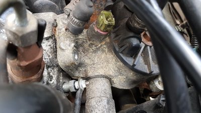

the structure of the vehicle itself to the left of the second (Overview) pic looks somewhat less than pretty. Just a mention to make sure the van's structurally sound before potentially chucking loads of money at it.

Head gasket, almost certainly
Leak from there was the end of my first Xantia TD.

Just removed the cambelt cover, camshaft oil seal is fine. looks like the head gasket.

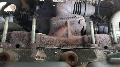

Ok, how do I remove the exhaust manifold studs?

Locknut two nuts on the end of the studs and undo with spanner

Struggling to remove this, thermostat housing?
Removed 2 6mm Allen bolts it rocks but won't pull out, is it a case of pull harder or am I missing something?
