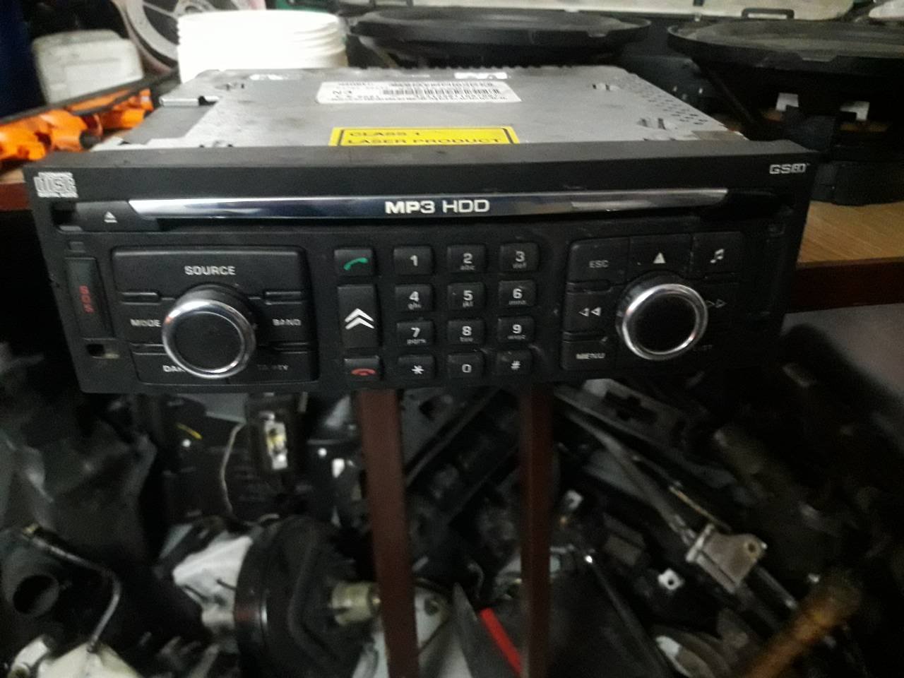

Thnks m8 bur now am confused seller sent me this and i dont know is it rt4 or rt5
EDC5
Posts: 1218
Joined: 01 Jul 2017, 21:48
x 130
Re: Rneg Myway to Navidrive
Unread post by EDC5 »
RT3ev is infact a RT4, so no bluetooth I'm afraid :oops:
