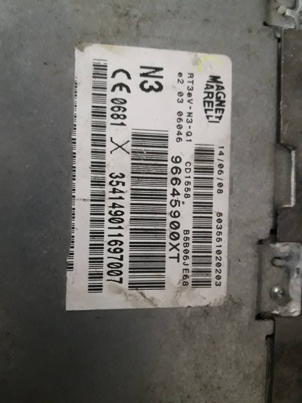

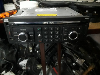

Thnks m8 bur now am confused seller sent me this and i dont know is it rt4 or rt5
EDC5
Posts: 1216
Joined: 01 Jul 2017, 21:48
Location: N. Wales
My Cars: Citroen C5 RHR AM6
x 120
Re: Rneg Myway to Navidrive
Post by EDC5 »
RT3ev is infact a RT4, so no bluetooth I'm afraid :oops:

damm it was just 100 eur :(
