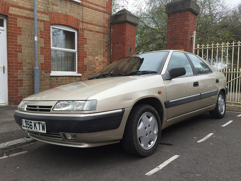

Hi, sorry about the delay. Yes the very first Xantias have a much heavier pattern in the glass - quite a distinct look. It really does also correspond to the low performance of the early lights. Jim is right, the later Mk1 glass swaps with these very first ones - the headlight is identical in every way except the glass. I'll try and find a photo of the early pattern versus the later more common Mk1. My Xantia has its early headlights as standard although it had the later type fitted - I swapped them back! Why? because I quite like the look of the proper early patttern even if the output on dip isn't great (I don't find them too bad to be honest) I just want my Mk1 sinker to be almost pure! (.......except for the peugeot wheels... :-D )

Here's a (bad) photo of Auld Katy (viewed from a 2CV) with the correct early Mk1 RHD lights. You can see the distinctive heavy patterns in the glass - deleted from later (possibly 1995?) cars.
Image20170812_132737 by Graeme McNulty, on Flickr
Not sure how clear it is but here's a pic of the same car taken by the previous owner, with the later, incorrect Mk1 lights
Imageimage1 by Graeme McNulty, on Flickr
