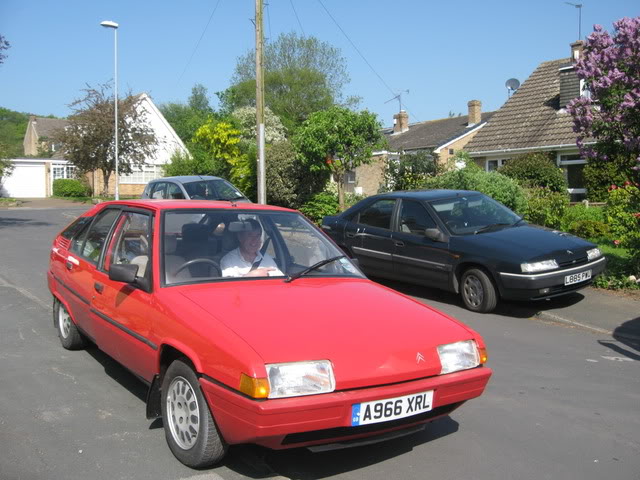

Currently looks like this..
i can take some more/better photos when weather improves. But at the moment this is my most recent photo- despite the BX being more in focus :oops: .

beautiful bx there Phill
