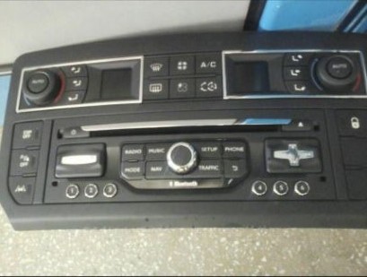

Hello everyone.
I have the following system on my car:
My wish is to switch to a big display, so I found this player and its display, from the same seller:
Can anyone please tell me what model I have and what model is this founded? And if it is possible to be mounted in the car without big effort and activate the USB and Parking, which are already present on my car?
Thank you,
Vlad.
Thank you,
Vlad.

Post up your VIN as there are several versions of the RD4 /RD45 unit. The unit you have above is the RT6 (eMyWay unit).
If you are planning on installing this, you will need a new fascia surround for the dashboard (there are 2 sizes for the multi-function screen - one is slightly larger). Also, did you check that the screen is from the same vehicle the eMyWay came from? There are 2 types of large colour screen - only the correct one will work with the RT6 (eMyWay).
There is a guide on the forum here that you should look through before undertaking the work so you are prepared. Also the unit will need VIN coding to the car and enabling in the BSI / configuring using Diagbox.

Here is my VIN Code: VF7**************[VIN obfuscated, can be read by forum staff]GiveMeABreak wrote: ↑28 Sep 2017, 10:01 Post up your VIN as there are several versions of the RD4 /RD45 unit. The unit you have above is the RT6 (eMyWay unit).
The unit of RNEG2 that you saw on my second photo is from the seller. He has also the display from this unit and the frame from the dashboard. All of the parts are from the same car, which is dismantled.
So, my question would be: Shall I buy the parts from the seller? I have also Lexia, so I can activate what is needed, but would after replacing my steering wheel commands, parking sensors and USB port work?
