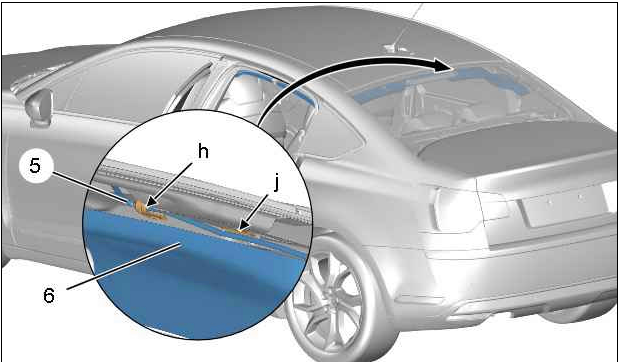

Depends on the system / options, Dual tuner, GPS, GSM and now of course DAB.
For the Adapter (No. 10 in the diagram), there are no less than 8 versions of this depending on the head unit, and no less than 20 different versions of the aerial cable (Part 5) to give you an idea of the combinations.
What about the antenna on the roof?

Nope, mine is a completely smooth roof, no 'sharks fin' or anything. I was kind of curious if I could fit the appropriate amplifier box that had a take off for DAB if that was possible.
Although finding the correct part number would be a nightmare as you say with that many different combinations

Well so far I've seen 3 specific combos of roof aerial on the X7 saloons:
1 - none at all
2 - the small 'bee sting' aerial (I have this one)
3 - a standard longer aerial
So one has to assume that for some systems, the aerial is primarily screen-printed onto the rear window.
So in your case Elis, it would seem to go from the rear left passenger side quarter up to the ceiling corner and crosses over to the rear right hand passenger side into the kit and from there into the screen printing:
1 - none at all
