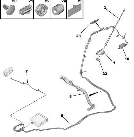

That's because the aerial is powered via the amplifier in the rear quarter, part 10 in the diagram.

Refer to the diagram here:
viewtopic.php?f=48&t=48421&start=240#p548825
Remember that amplifier is for a 2004 Peugeot 607, they had different systems / options back then. I have 3 aerial connectors in my head unit, so apart from the FM, it has to contend with GPS and GSM (for the internal telephone), even though I use Bluetooth mainly.

Depends on the system / options, Dual tuner, GPS, GSM and now of course DAB.
For the Adapter (No. 10 in the diagram), there are no less than 8 versions of this depending on the head unit, and no less than 20 different versions of the aerial cable (Part 5) to give you an idea of the combinations. :wink:
What about the antenna on the roof?

Well so far I've seen 3 specific combos of roof aerial on the X7 saloons:
1 - none at all
2 - the small 'bee sting' aerial (I have this one)
3 - a standard longer aerial
So one has to assume that for some systems, the aerial is primarily screen-printed onto the rear window.
So in your case Elis, it would seem to go from the rear left passenger side quarter up to the ceiling corner and crosses over to the rear right hand passenger side into the kit and from there into the screen printing:
