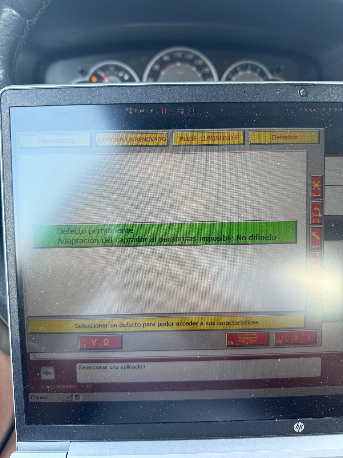

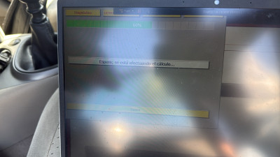

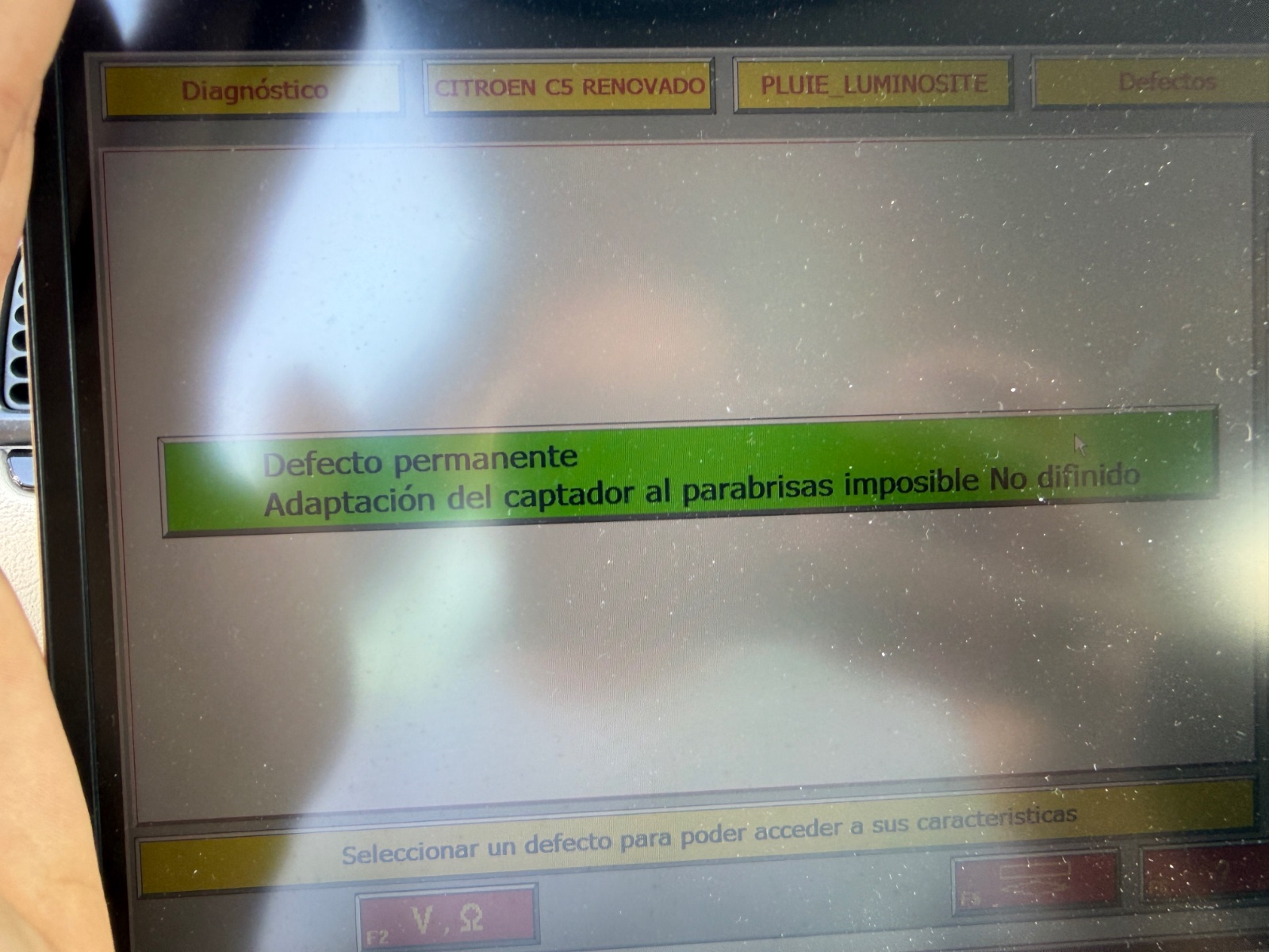

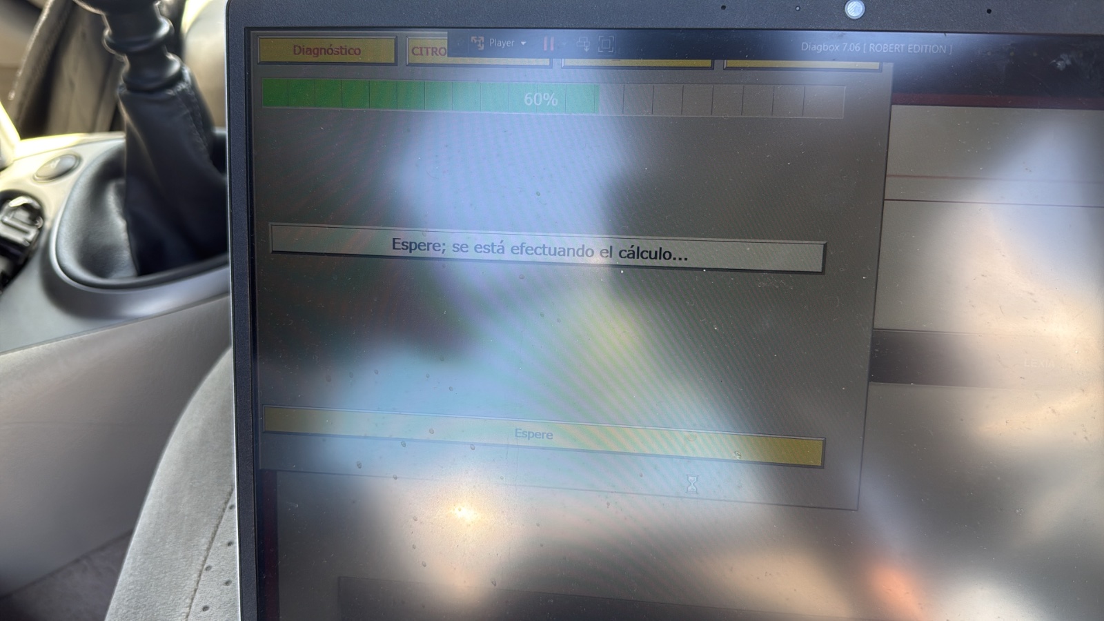

Hello, I have a 2006 Citroën C5 (RHR Exclusive, 2.0 HDi 136 FAP). A few months ago, the windshield was replaced, and the light and rain sensor stopped working. They tried to initialize the sensor using both Texa and Lexia diagnostic tools; with Lexia, the process gets stuck at 60% and won't proceed any further. A second sensor was tested using the same procedure, but without success; the error persists in Lexia (I’ve attached an image of the error). The light sensor works, though it is slower than it was before the windshield replacement. When the automatic wipers are engaged, they perform a sweep every 5–10 seconds, even when it isn't raining. Has anyone else experienced this or know how to fix it? It seems the rain sensor is no longer available, and neither is the replacement gel.

I'm afraid I cannot understand the error picture as it appears to be in Spanish!

mickthemaverick wrote: 18 Sep 2026, 18:37 I'm afraid I cannot understand the error picture as it appears to be in Spanish!![]()
Sorry
