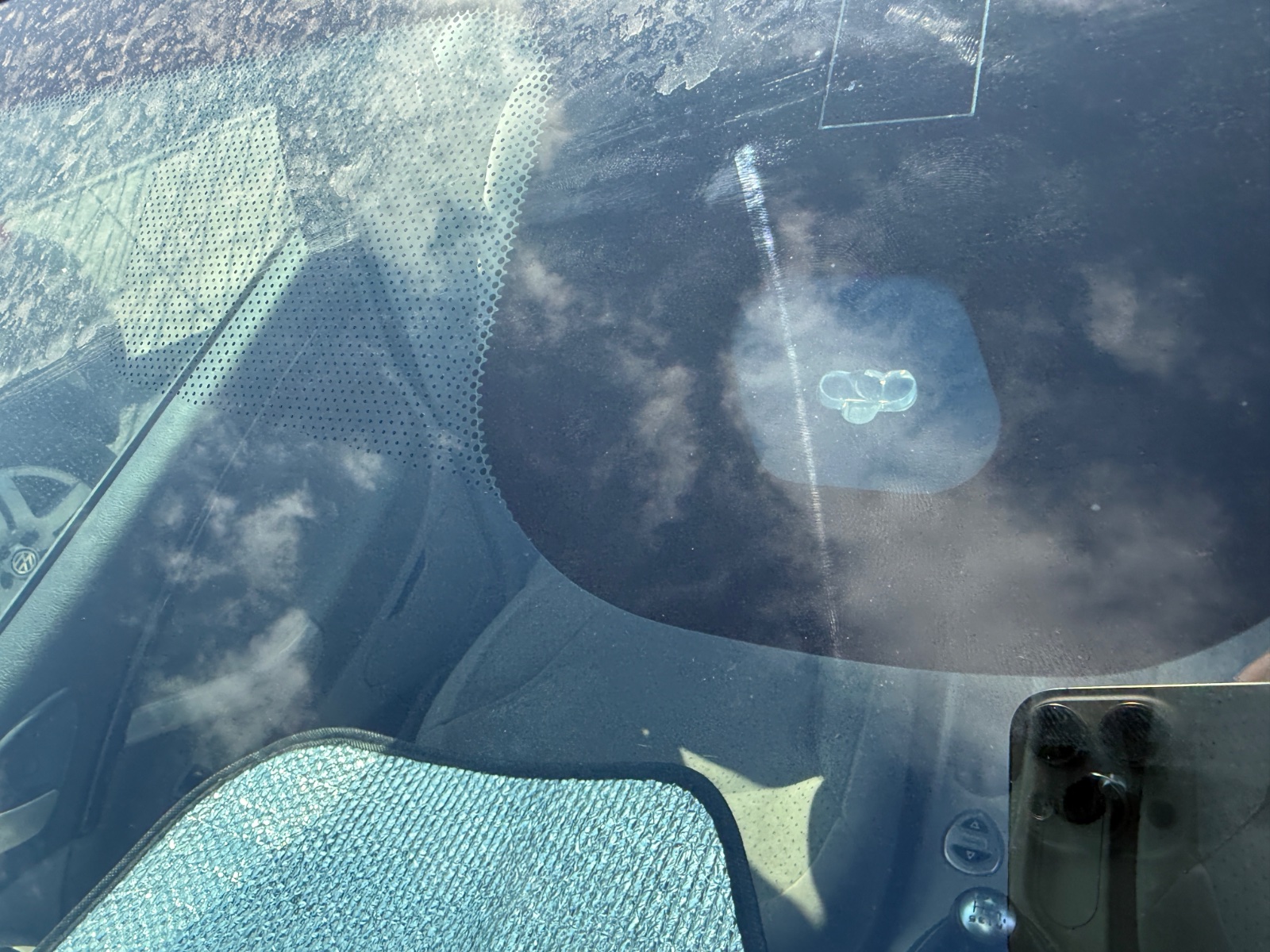

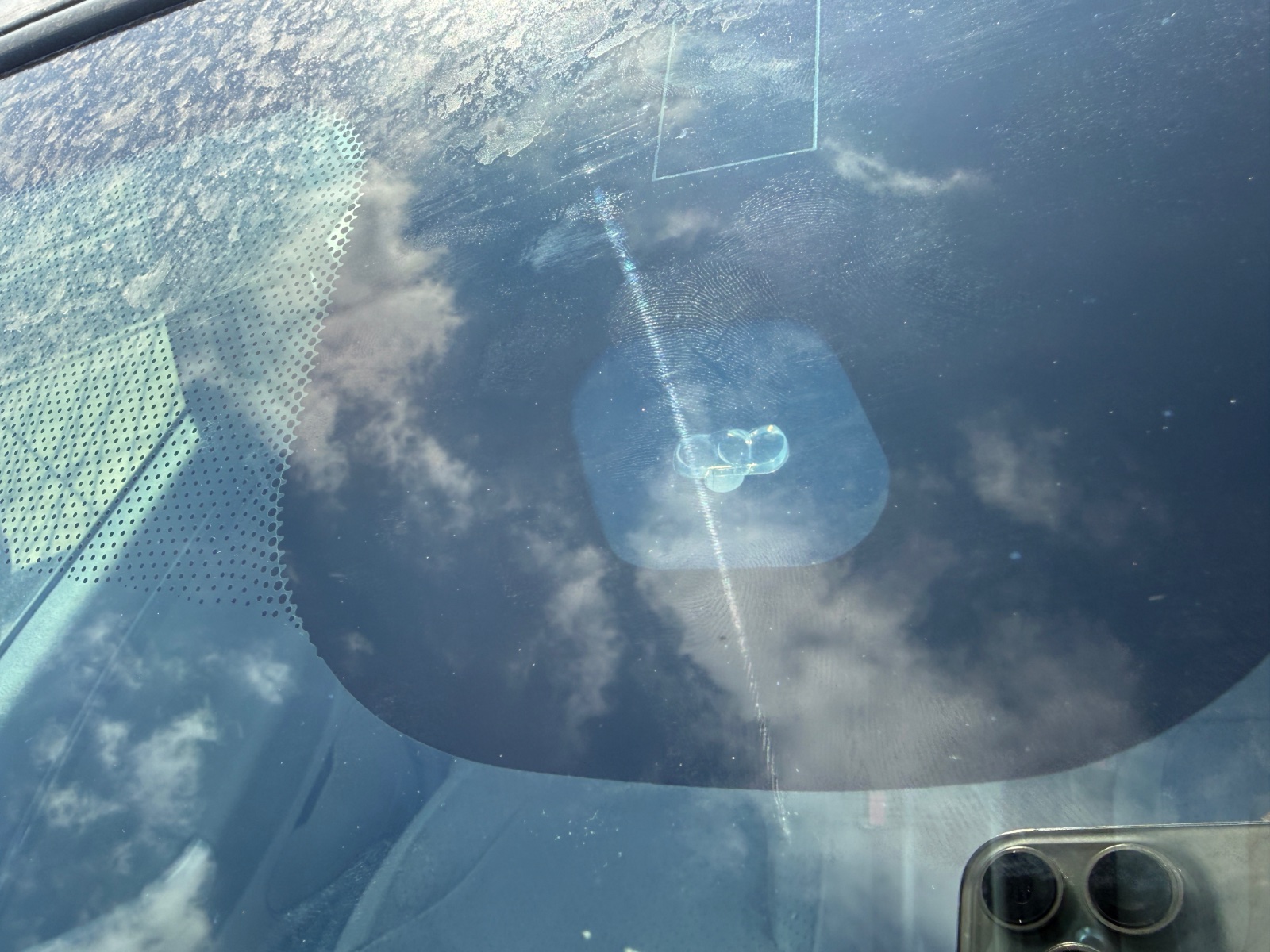

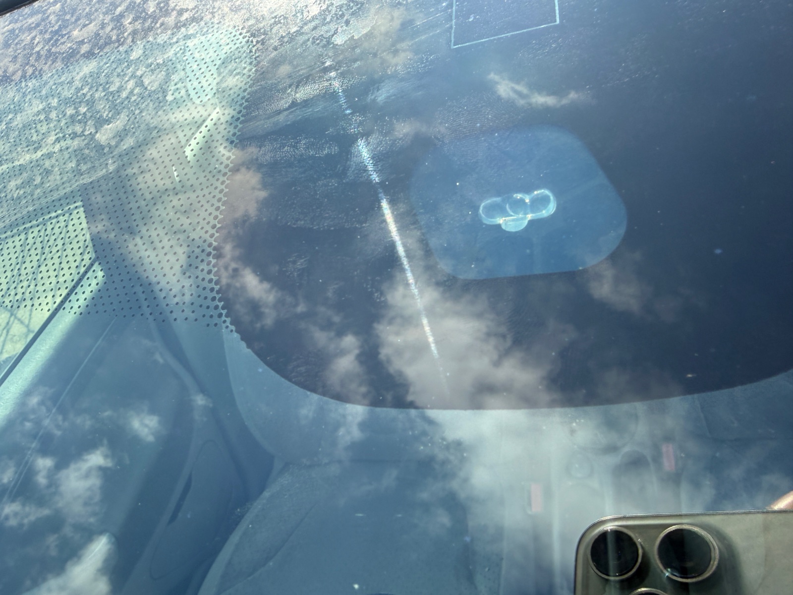

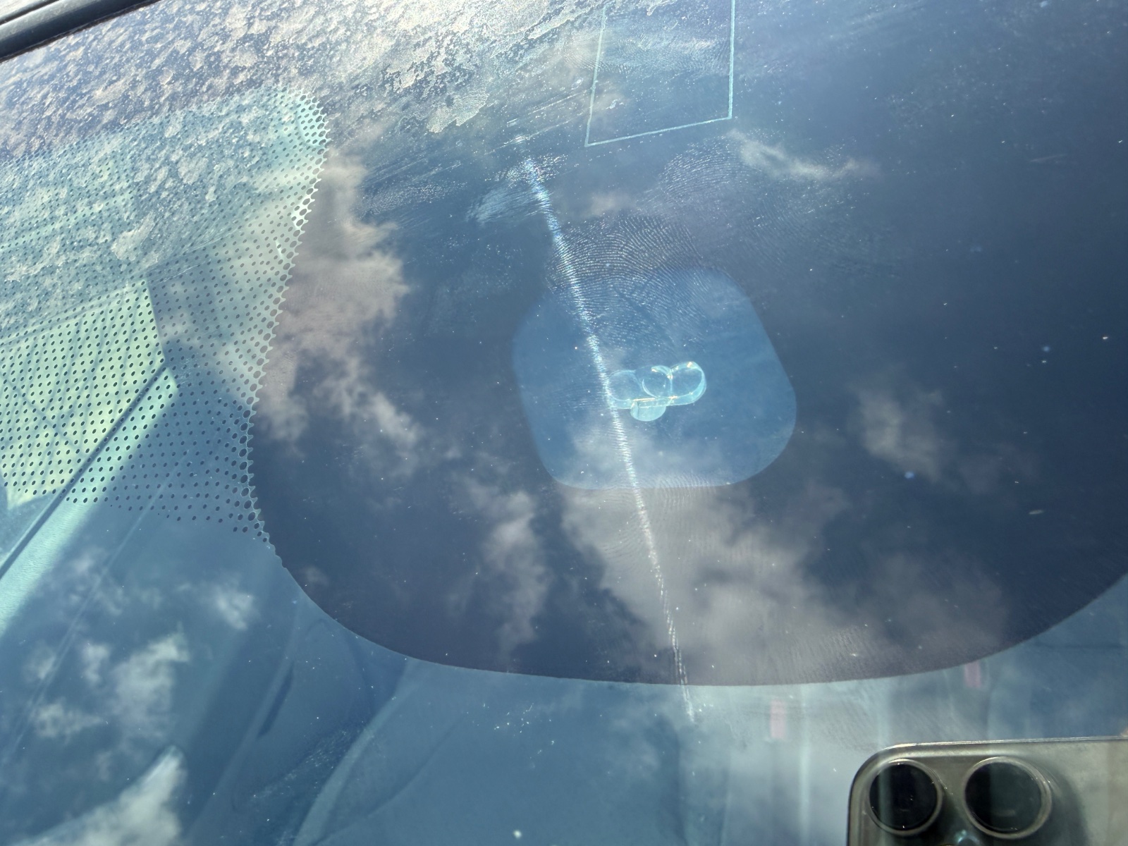

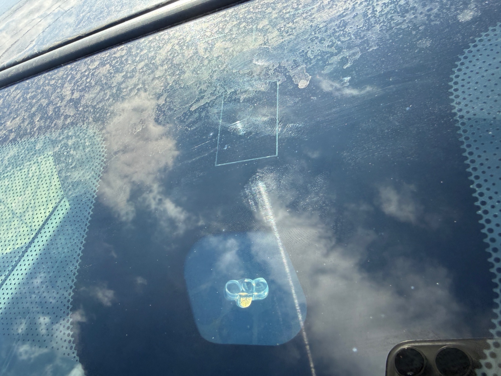

Hello, I have a 2006 Citroën C5 (RHR Exclusive, 2.0 HDi 136 FAP). A few months ago, the windshield was replaced, and the light and rain sensor stopped working. They tried to initialize the sensor using both Texa and Lexia diagnostic tools; with Lexia, the process gets stuck at 60% and won't proceed any further. A second sensor was tested using the same procedure, but without success; the error persists in Lexia (I’ve attached an image of the error). The light sensor works, though it is slower than it was before the windshield replacement. When the automatic wipers are engaged, they perform a sweep every 5–10 seconds, even when it isn't raining. Has anyone else experienced this or know how to fix it? It seems the rain sensor is no longer available, and neither is the replacement gel.

Re: Problem CITROEN C5 II EXCLUSIVE RAIN/LIGHT SENSOR
Replace new sensor and same problem….
Paul-R wrote: 25 Sep 2026, 09:45 There's an interesting thread a few years (ten!) ago about a rain sensor on an X7. It's unfortunate that Marc's photo is not displayed as he was using Photobucket at the time.
viewtopic.php?t=55067
It's a pity that the photos in the first post of this thread only show the back of the rain sensor, not what it looks like from outside where it seals to the windscreen.
The sensor is properly attached; in fact, the error message in Lexia indicates a problem.
