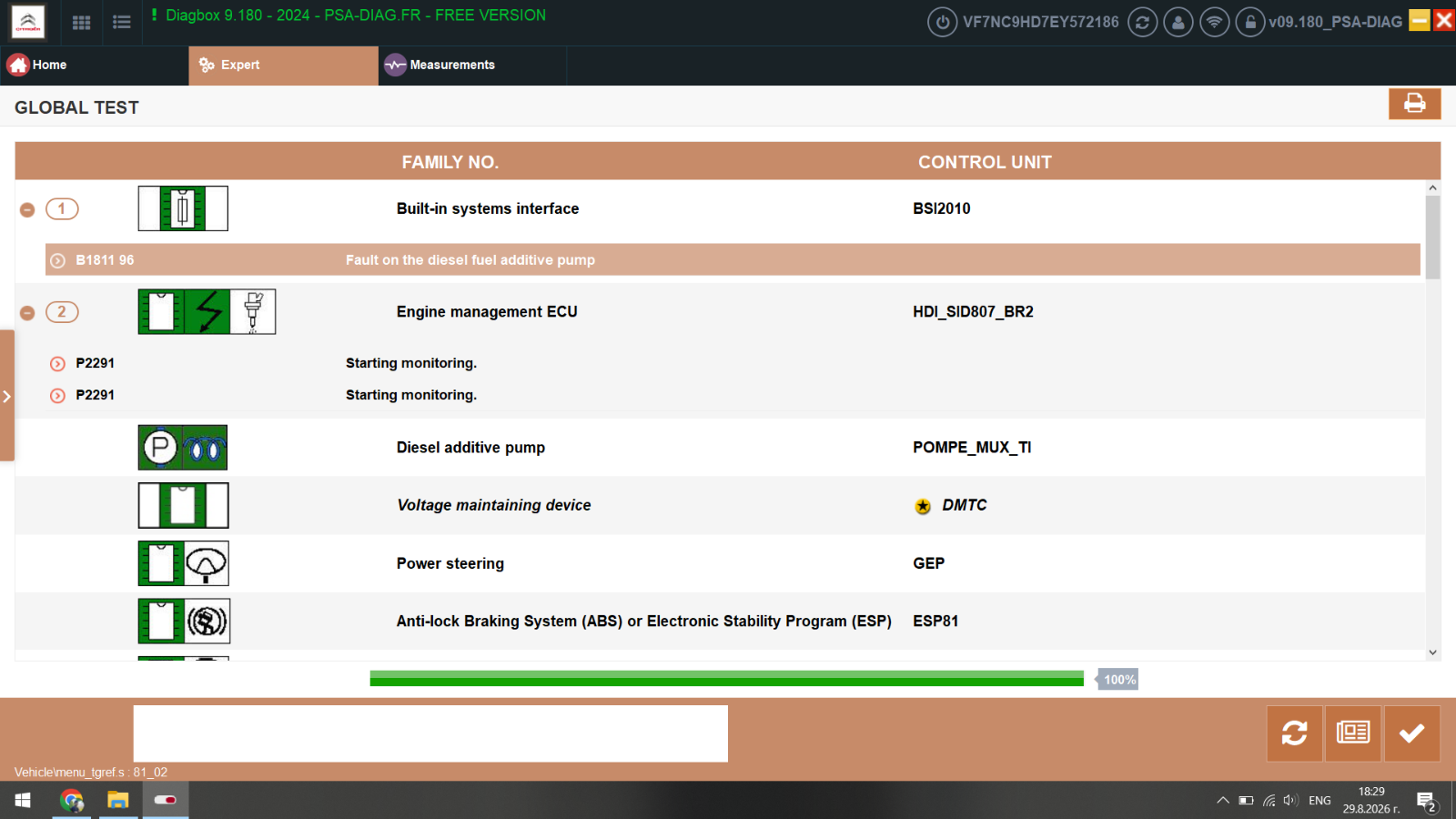

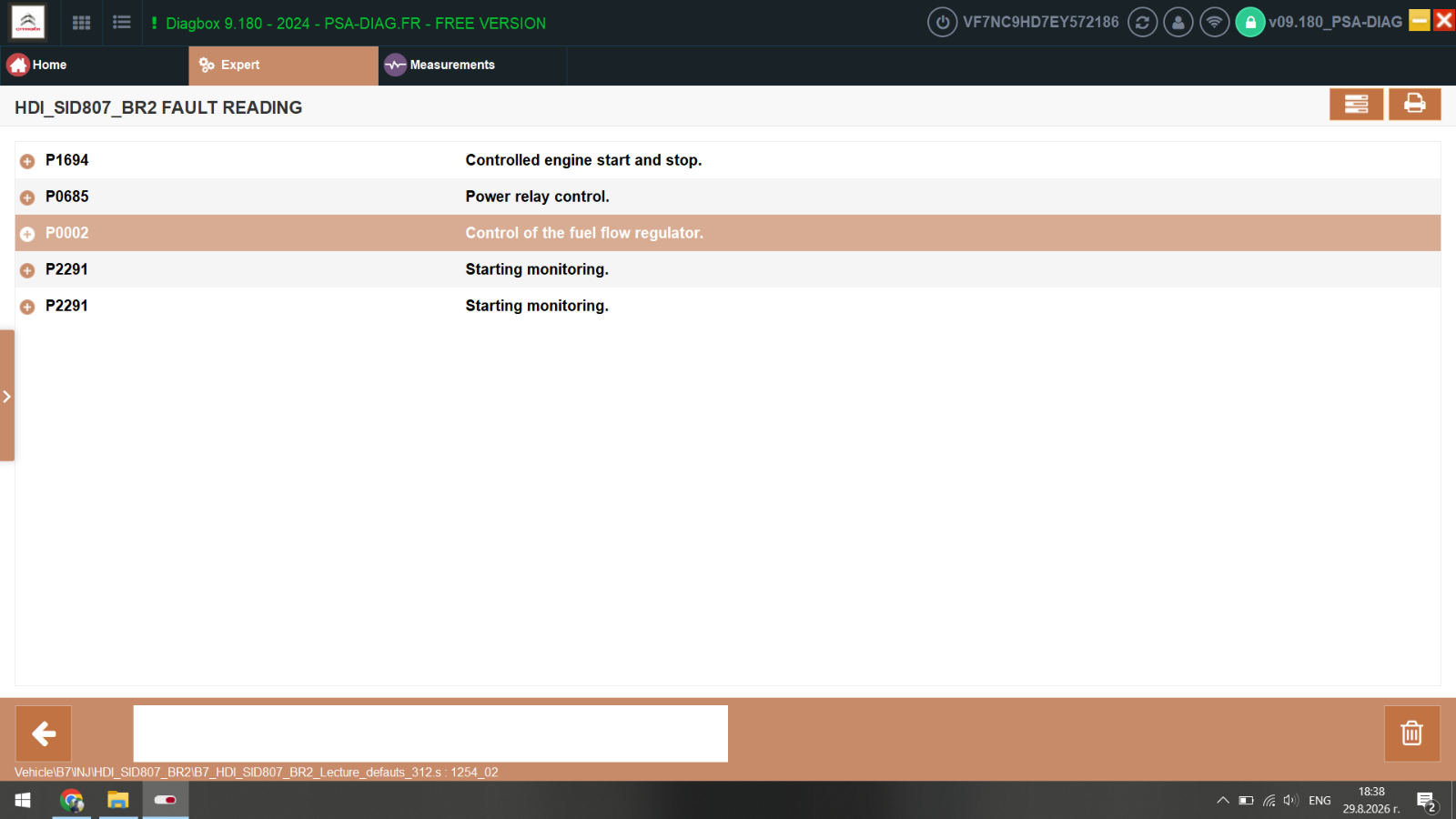

I have C4 B7 1.6eHDI 2014. It is not driven every day but once a week. It was running noraml until one day the battery was dead. I recharged it and everything was back to normal. A few weeks later i tried to start the car again and the engine was cranking but it was not starting. Checked the battery it was OK. I hooked it to another car to try to start it and it didnt start. Checked the fuses and were OK. Connected it to Diagbox and there were lot of errors but non of them were leading to probable cause but only to dead battery. Tried another battery and again nothing. Tried to manualy pump fuel with the button on the filter and it was hard as rock. Changed the fiel filter. Filled up the system with fuel again with the button and nothing again. Changed BSM, nothing again. Checked engine RPM when crancing - 280. Checked pump preasure ~300 bars. No fiel on the injectors. There was 12v on the pump and there was nothing on the presure valve BUT when i gave 12v from the battery to the presure valve i felt some clicking inside. And after everything there are no mistakes in the BSM, BSI or ECU. What could be the issue? I tried searcing the net and talking to the AI friends and the AI was leading me to broken wire somewhere. Could it be ? I am out of ideas.

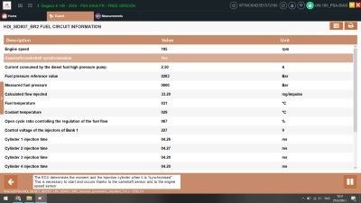

Look in live data and see if cam / crank synchronisation changes to yes when cranked. It needs to see this, plus fuel pressure above 200 bar and engine rotating before it will fire the injectors.

Just checked that and there was no indication on the dashboard. I cheked on my Hyundai and when i leave the key in the ignition switch and open driver door, immediately start an alarm to indicate the forgoten key. On the citroen there was nothing. Tried to crank it, left the key, opened driver door and nothing. But why then there were 288rpm engine speed and 271bars on the fuel presure live data if the keys are not recognized?

mostcho wrote: 24 Aug 2026, 19:59 But why then there were 288rpm engine speed and 271bars on the fuel presure live data if the keys are not recognized?
Because that's how fast the engine is being turned over by the starter. As you have fuel pressure then the pump is running ✅

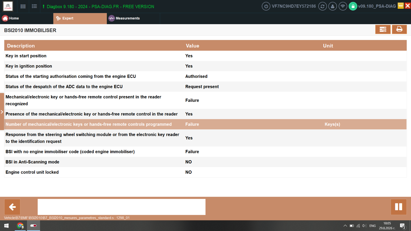

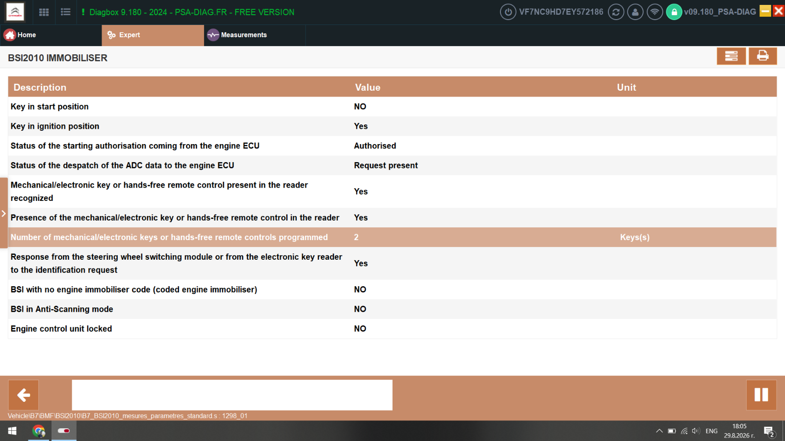

I think it is not the imobiliser and i do not know what is it.
after Actuators Test -> Test with engine stopped -> fuel pressure curcuite test -> valve for regulation the flow in the high presure pump
errors before Actuators Test -> Test with engine stopped -> fuel pressure curcuite test -> valve for regulation the flow in the high presure pump
while traying to start
before trying to start
