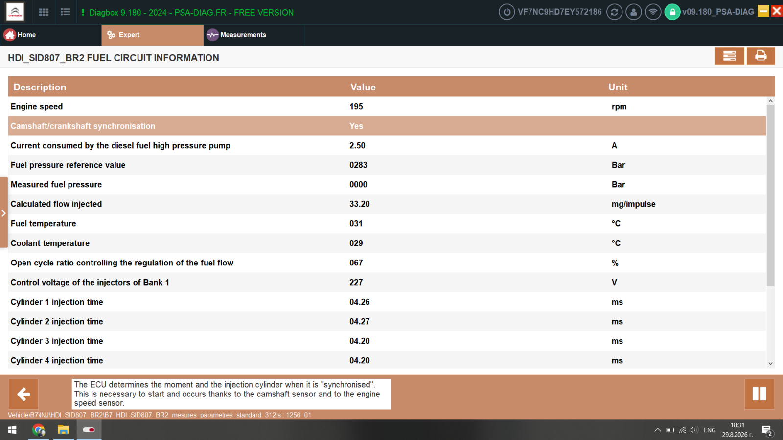

I think it is not the imobiliser and i do not know what is it.
after Actuators Test -> Test with engine stopped -> fuel pressure curcuite test -> valve for regulation the flow in the high presure pump
errors before Actuators Test -> Test with engine stopped -> fuel pressure curcuite test -> valve for regulation the flow in the high presure pump
while traying to start
before trying to start

Last one says measured fuel pressure 0 - that's why it won't start. Either the fuel pressure really is 0, or the rail pressure sensor or wiring has failed.

Looking at the fault screens, on the third one down on the immobiliser it says Failure on recognising the key, as well as the key being in position. I am not an expert on diagnostics but does this mean the immobiliser is preventing the car from starting, as well as the lack of fuel pressure ?

PaulC5 wrote: 30 Aug 2026, 12:25 Looking at the fault screens, on the third one down on the immobiliser it says Failure on recognising the key, as well as the key being in position.
Yeah there is some conflicting info on the live data however i would expect to see the ECU locked if the correct key was not detected.
