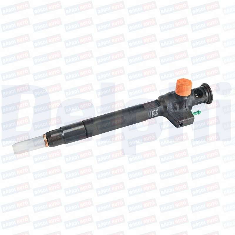

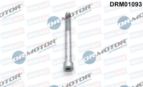

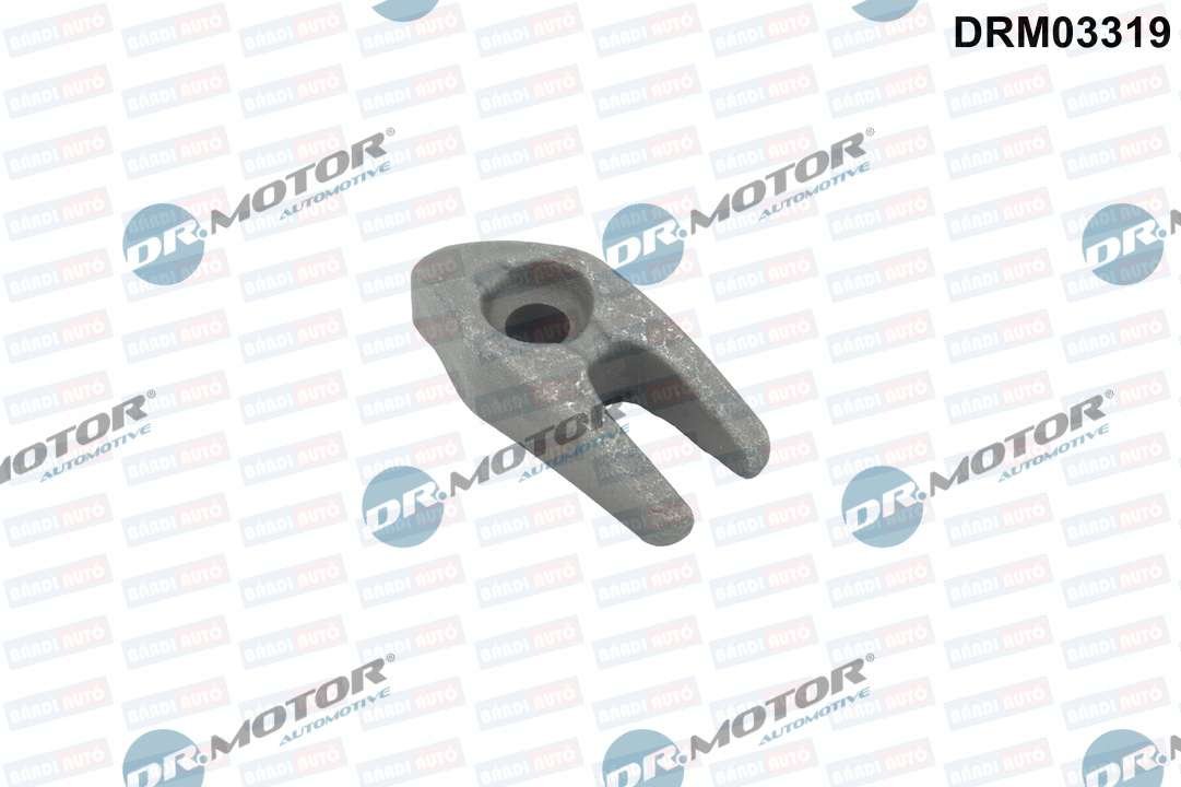

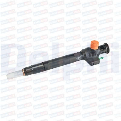

How to tighten the injector clamping screw of a 2015 Citroen c4 picasso 2.0 HDI, or how many Nm should I tighten it with?
Screw size M8
Delphi injector
Engine DW10FD

I read somewhere that the Delphi injector must be pre-tensioned with a minimum torque ("X" Nm), and then secured to the appropriate degree with a protractor. The difference, according to my information, is that the Bosch works with lower pressure. That's why there is a different procedure.

DW10FD (2.0 BlueHDi – modern Delphi)
Clamping bolt torque: ? 7–9 Nm + 65–75° tightening
(typical: 8 Nm + 70°)
DW10TD (older 2.0 HDi)
Clamping bolt torque: ? 7 Nm + 60–65° tightening
Unfortunately, what I know is not official...
