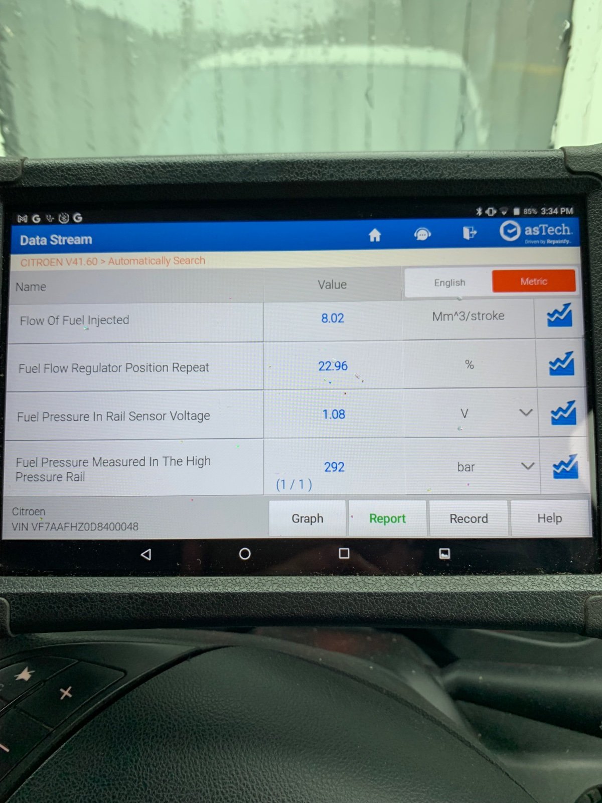

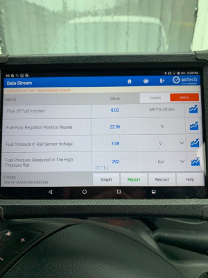

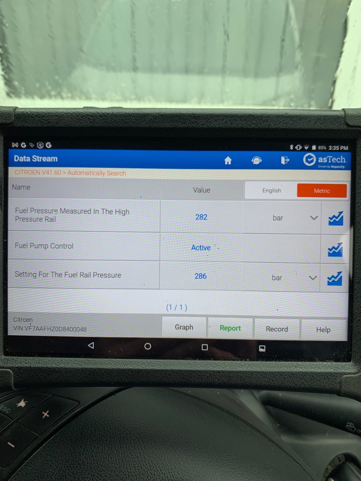

It does do live data what is considered normal and in the list am i looking at pls?
gsc1ugs
- Posts: 104
- Joined: 17 Jul 2024, 17:04
- x 3
Re: Odb code p1206 citroen nemo
Ive took these readings

PaulC5
- Posts: 2624
- Joined: 06 Jun 2023, 15:26
- x 683
I do not know much about fuel pressures but about 300 bar may be right at tick over.
If you can find the freeze frame data on the code reader see what that shows when the fault was recorded.
