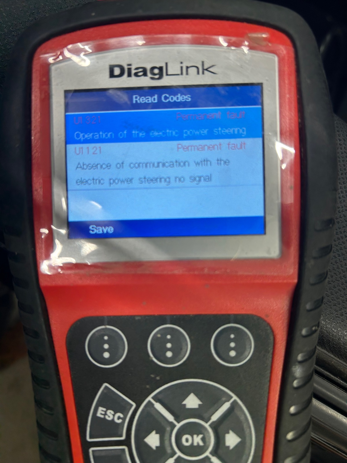

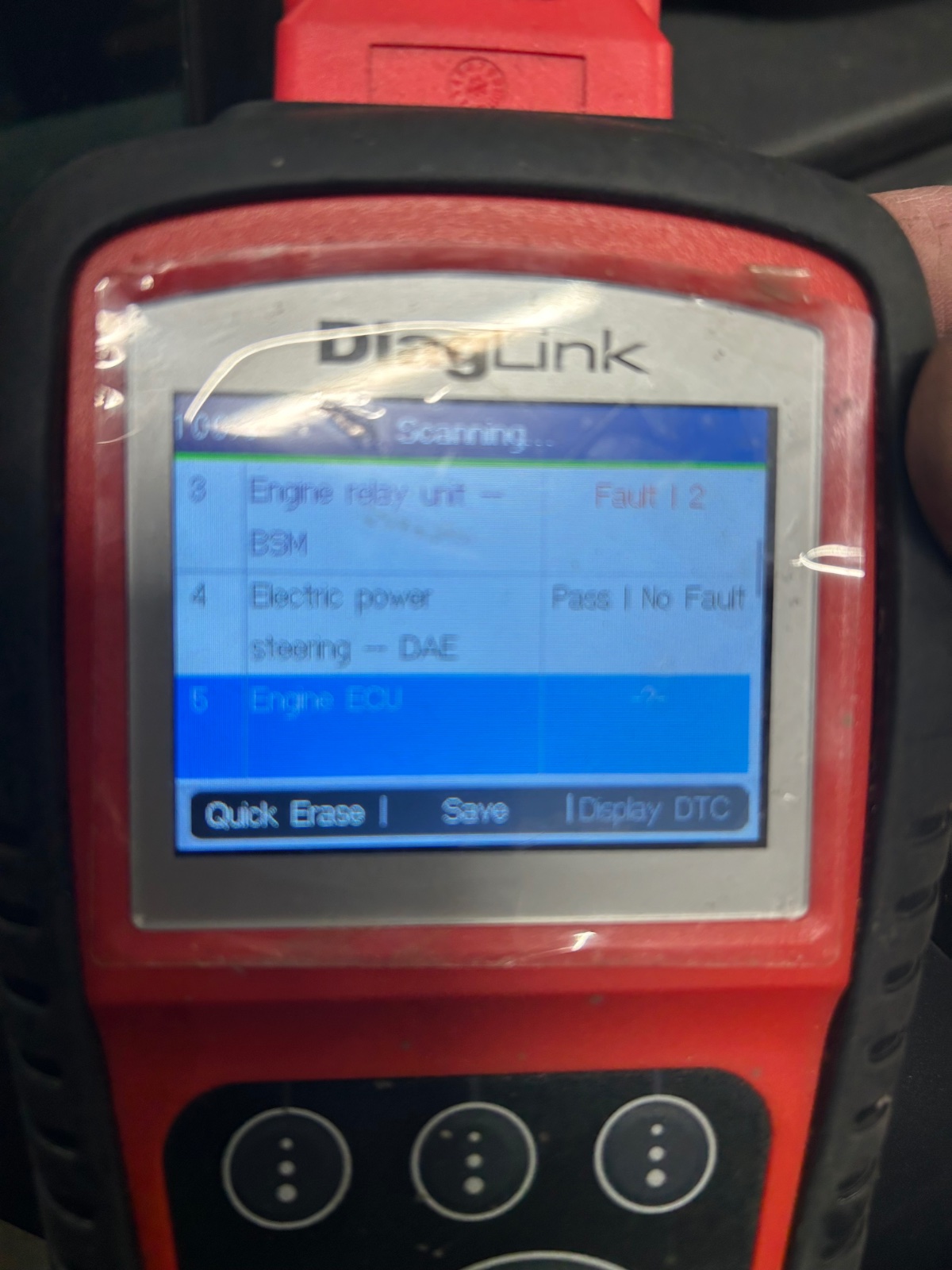

Since fitting the replacement rack, the steering itself is perfect, however we now have an ABS warning light on the dashboard. When scanned, it shows fault code U1121 – Absence of communication with the electric power steering.

This topic was on here last year and it was because the wrong steering rack had been fitted, using a used one from an older car. From memory the solution was to get the right steering rack. The used one may well have fitted mechanically but its electrics are not correct.
