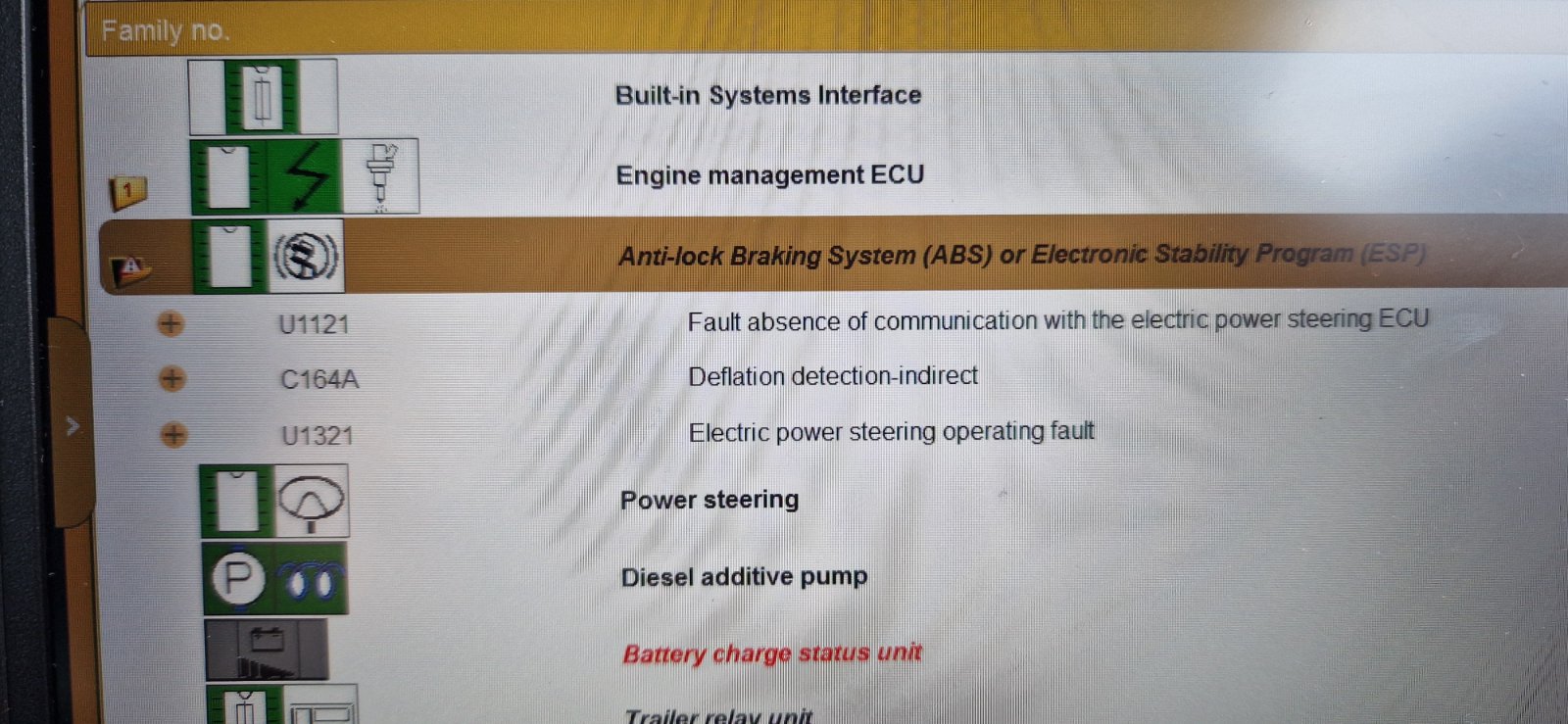

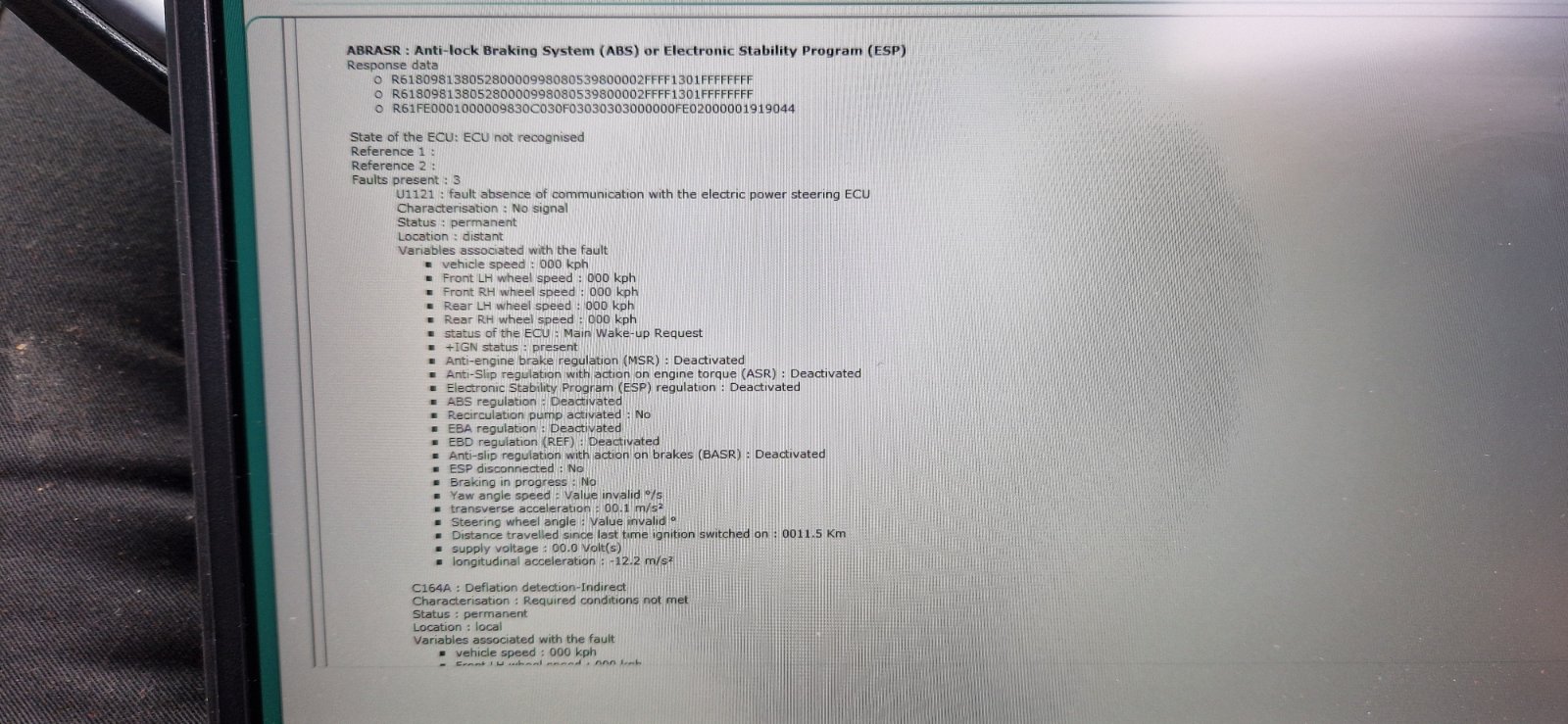

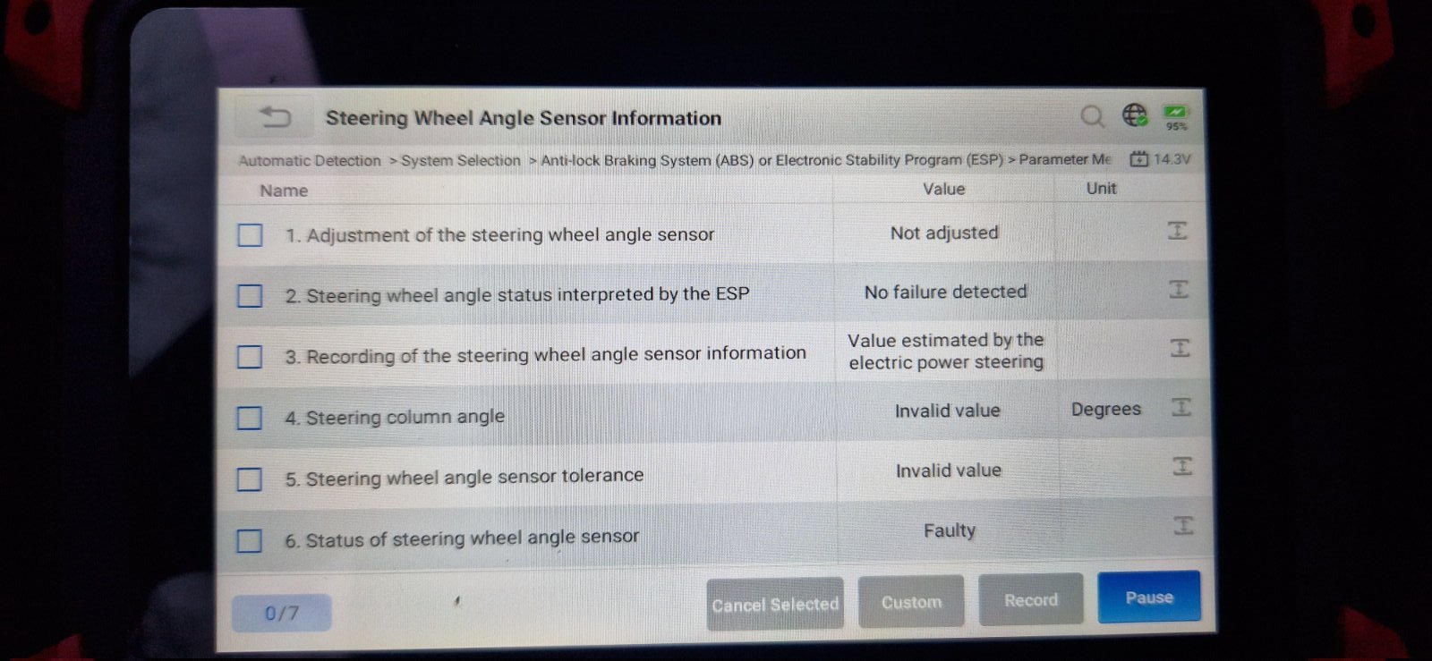

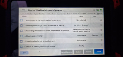

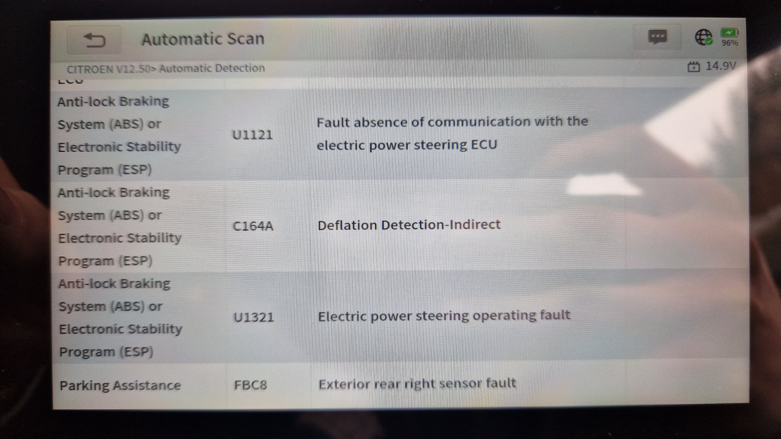

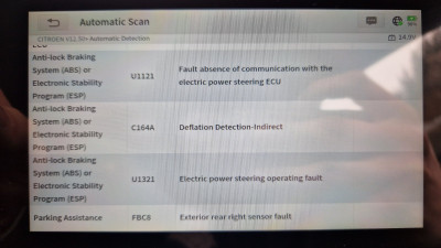

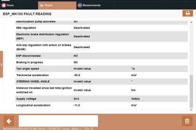

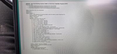

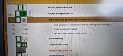

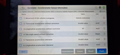

Had an issue where car didn't drive straight after many alignments.
Replaced the rack and tracking adjusted so now drives straight, issue is now esp is on. Read the codes and are attached below.. did a calibration on the steering angle sensor and the live data shows it's working but still displays as faulty and esp remains.
The replacement rack was from 2009 model 1.6d and put on a 2015 model. So not sure that would matter too much.
Any suggestions please. DS3 1.6hdi 2015

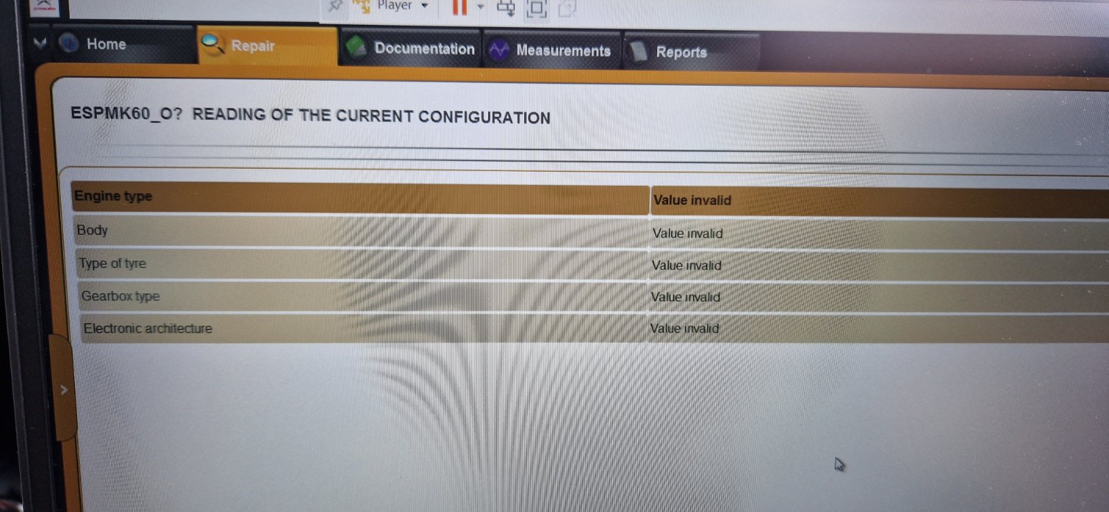

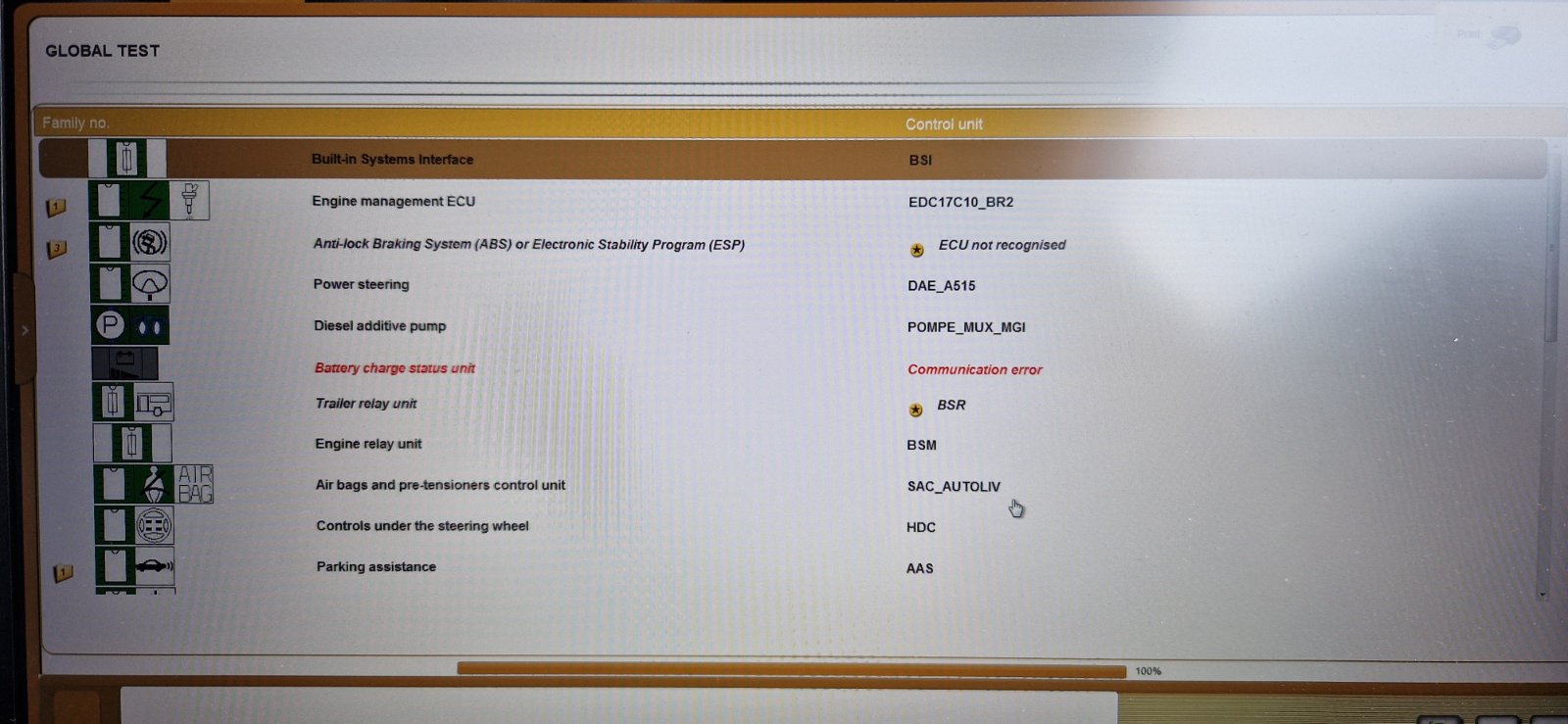

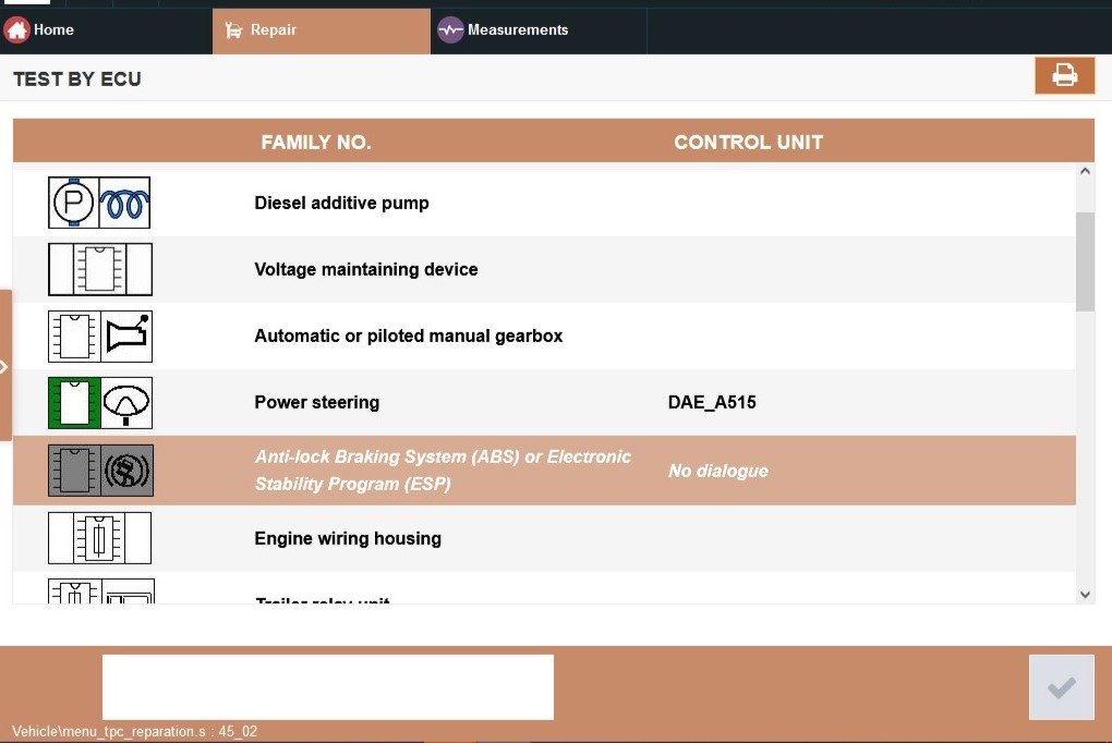

Re: Steering Rack replacement

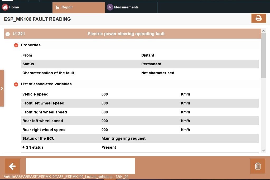

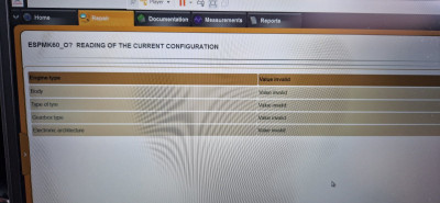

Got the diagbox v7.83
Pics attached if this helps... but unable to configure or figure out how this diagbox helps in anyway compared to a regular professional scanner
Hope someone can help... I'm determined to find a solution lol

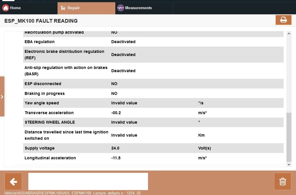

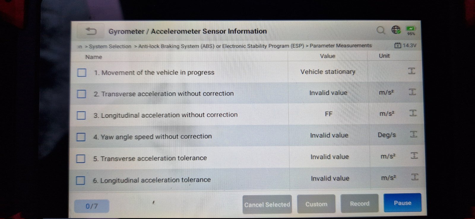

Just want to bump the thread.
I have someone who can do online telecoding but still having some slight trouble with the cars steering rack.
Again the car drives perfect aside from these issues ESP/ASR Faulty. Which disables the ESP.
Checked all the wiring again, all is as it should be. Why is the supply voltage at 24v?

Edit: Looking at the attached images there is different software reference numbers to that of the rack fitted to the car.
Old: 96 670 397 80
New: 96 717 322 80
Im not sure how Diagbox works entirely when coding so whether a newer software version can be downloaded?
