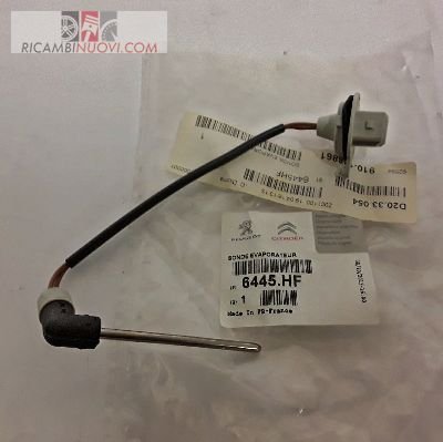

Hi,
could anyone help me locate the evaporator sensor on my 2000 xsara? The part number is 6445HF.
I've looked under the glove box and behind the central console, but I was only able to find 2 interior temperature sensors (654464W).
Thanks in advance!

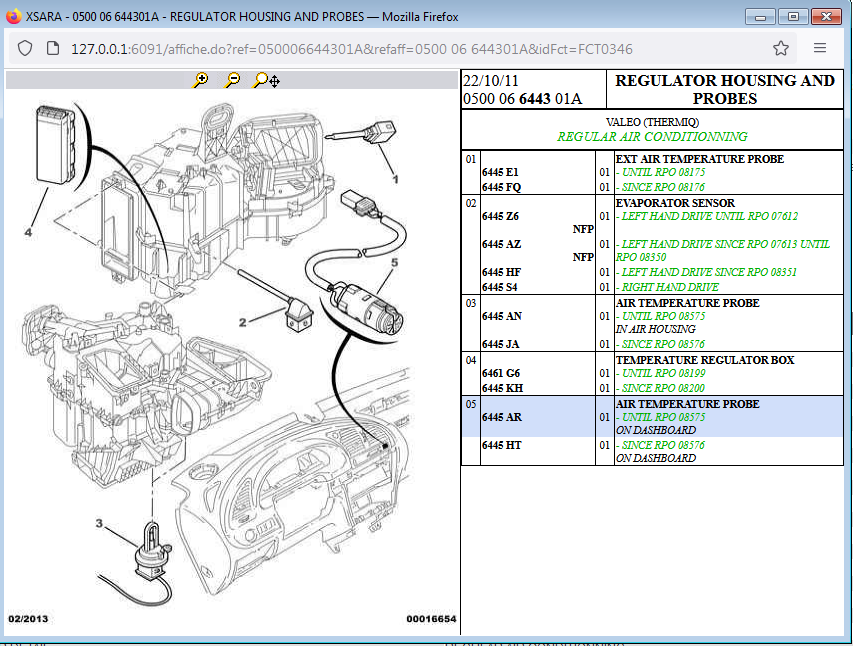

Re: Evaporator sensor replacement
Unread post by xantia_v6 »
The best I can find is:
The shape of the connector implies that it clips into the housing somehow, maybe you need to remove the housing to get access?
