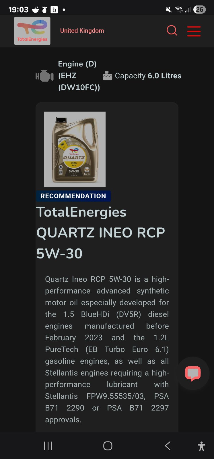

Uberderv
Posts: 20
Joined: 01 Jun 2014, 10:47
x 1
Re: DW10FC Engine oil
Unread post by Uberderv »
JimmyTulip wrote: 20 Aug 2025, 08:51
Uberderv wrote: 26 Jul 2025, 16:33 The listed oil for this engine (in the stickys) is incorrect. It has changed from 0w-30 to 5w30 FPW9.55535/03, PSA B71 2290 or PSA B71 2297 approvals.
Hello,
I wanted to verify, if this is a confirmed information!?
Is there any official proove on that?
DW10FC is the BlueHDI180 engine right?
I am asking for the specific engine identification "AH01", which I cannot find in the sticky list.
I used the "Total Quartz INEO First 0W-30" till today.
The mentioned specification seems to be the "Total Quartz Ineo RCP 5W-30".
I find a lot of information, that the BlueHDI130 with DV5R engine has been moved to the Total Quartz Ineo RCP 5W-30 oil. (timing chain, etc. has been mentioned as reason)
But not for the BlueHDI180?
Thank you!
Total Energies which is Peugeots preferred oil supplier recommends 5W-30.
