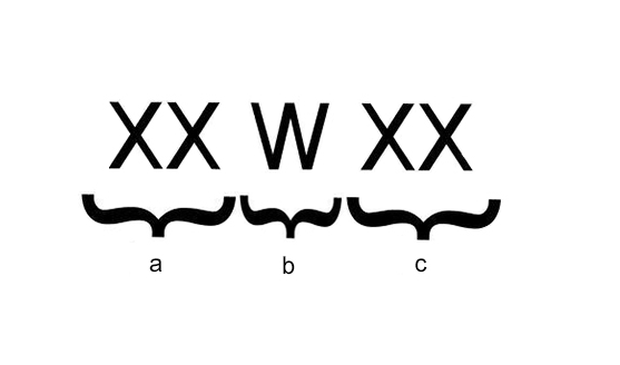

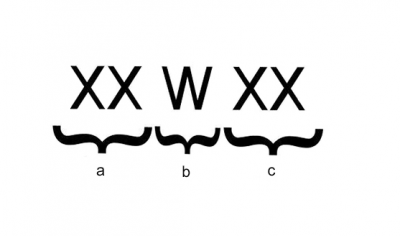

Grade of Engine Oil
The grade of the engine Oil is defined by the standards of the SAE (Society of Automotive Engineers).
The Grade of an Engine Oil is Represented by XX W XX
Key
  1. Figure or number corresponding to the cold grade of the engine oil (the small the number, the easy cold starting will be).
  2. Letter W for winter.
  3. Number indicating the hot grade of engine oil (the higher the number, the more the engine oil will resist high temperatures and remain viscous).
An engine oil is developed to perform well over a wide temperature range (0W30 applicable between -45 and 45°C)).
An engine Oil is developed to be highly efficient over a considerable temperature range (for example: 0W30 applicable between -45 and 45°C).
Note: The grade of an engine oil is not linked to its performance against aging, clogging and wear.
Example: A 5W30 Oil is not necessarily more effective than an 0W30 Oil and vice versa.

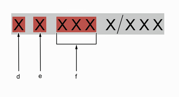

Identification of the Engine Specifications
"d" Vehicle family.
"e" Body style.
"f" Engine (Legislative code).
  • Note the country in which the vehicle is used (Group "A", "B" or "C" in the tables below)
  • Identify the engine legislative code on the vehicle Identification plate (At "f")
  • Make a note of the engine legislative code
  • Refer to the section "Presentation of country groupings" and then the section "Oil recommendations per group of countries"
