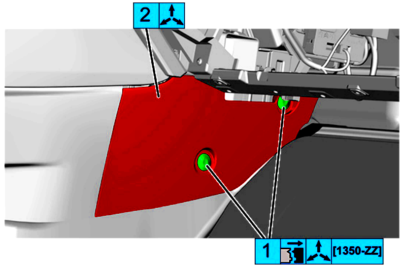

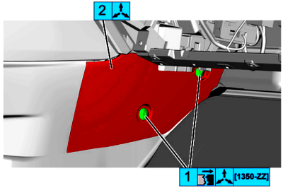

As for the filters, they are located inside the heater unit. To get to this you will need to remove the lower driver's side trim and side panel of the central console at the driver's footwell:

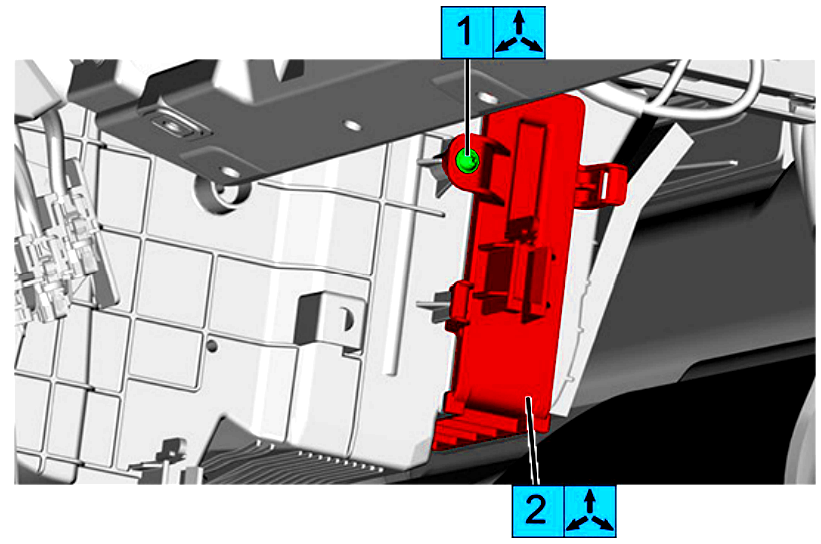

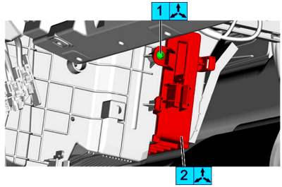

Once you have the area visible you are looking for this panel that locks them in - unscrew it:

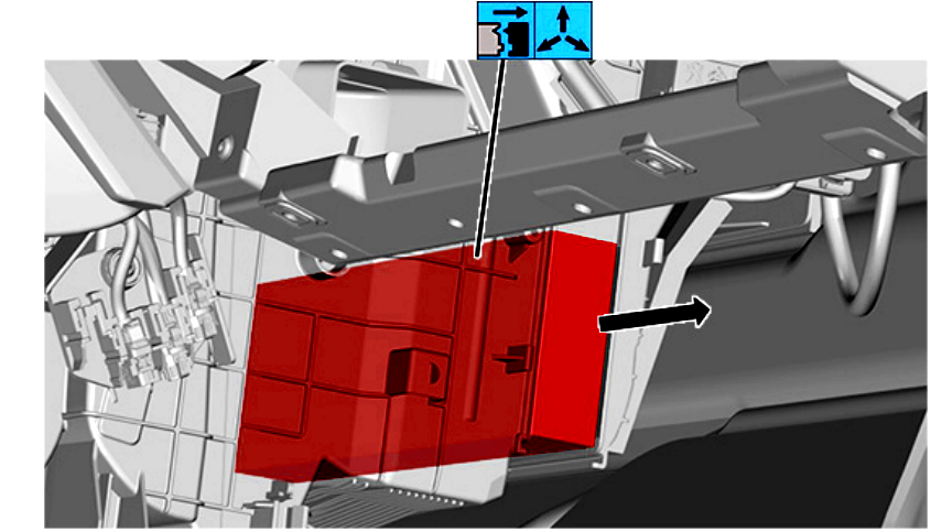

Then pull both filters out to the right (there are 2).

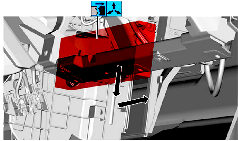

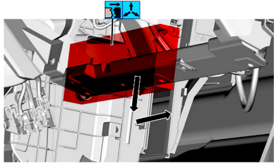

The pull then down:
