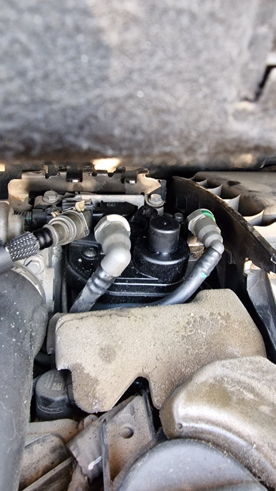

Hello, Im trying to figure out a possible issue with fuel filter and loss of fuel pressure. I have code p2291 and just doing some visual checks when I saw that I have a leak from the fuel filter cap, specifically at the button that is used as pump(correct me if Im wrong about the pump). Is this normal or it should be dry.
All around this button there was fuel

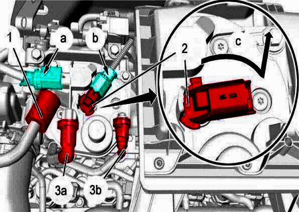

You need to check the unions are on tight as there shouldn't be any leaks. Second make sure it's not from the water bleed screw (2):
Failing that it may need replacing. P2297 does include the Fuel Filter as a Suspect for this fault code:
