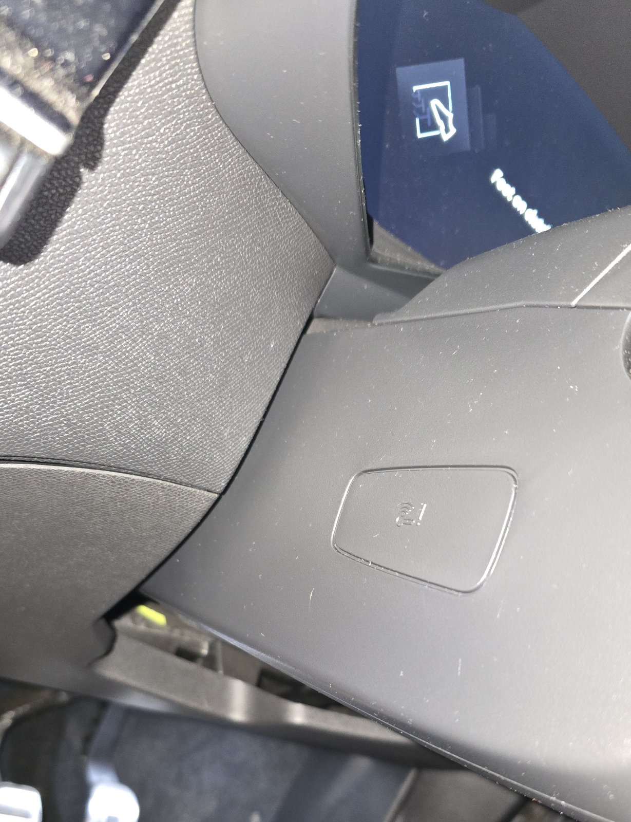

Hello. By the look of it Immo is preventing from starting. Had similar situation when my car wouldn't start after he picked up some faults. I am afraid that you have to scan with diagbox to see what's what. Your car can be lock and unlock from remote? Try to put your remote near this place on your steering wheel (coil from immo), then press start button, but you have to tilt your steering wheel to the left or right because steering wheel lock could kick in and prevent steering wheel from moving. Fault code (LVDC are correlated with no power), rest would be more easy to have it in English, unless ask Marc (Givemeabreak) for help

I tried starting with the key fob in the reader beside the steering wheel, but I didn't try turning the steering wheel. I will try tomorrow and see what happens and it helps. Thanks for the suggestion!Djandree wrote: 17 Feb 2025, 06:56 Hello. By the look of it Immo is preventing from starting. Had similar situation when my car wouldn't start after he picked up some faults. I am afraid that you have to scan with diagbox to see what's what. Your car can be lock and unlock from remote? Try to put your remote near this place on your steering wheel (coil from immo), then press start button, but you have to tilt your steering wheel to the left or right because steering wheel lock could kick in and prevent steering wheel from moving. Fault code (LVDC are correlated with no power), rest would be more easy to have it in English, unless ask Marc (Givemeabreak) for help
