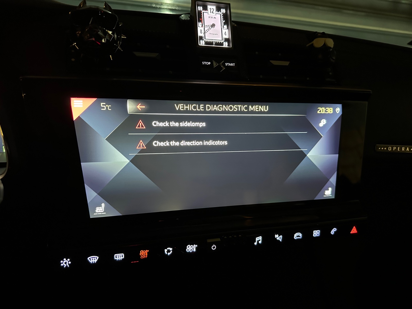

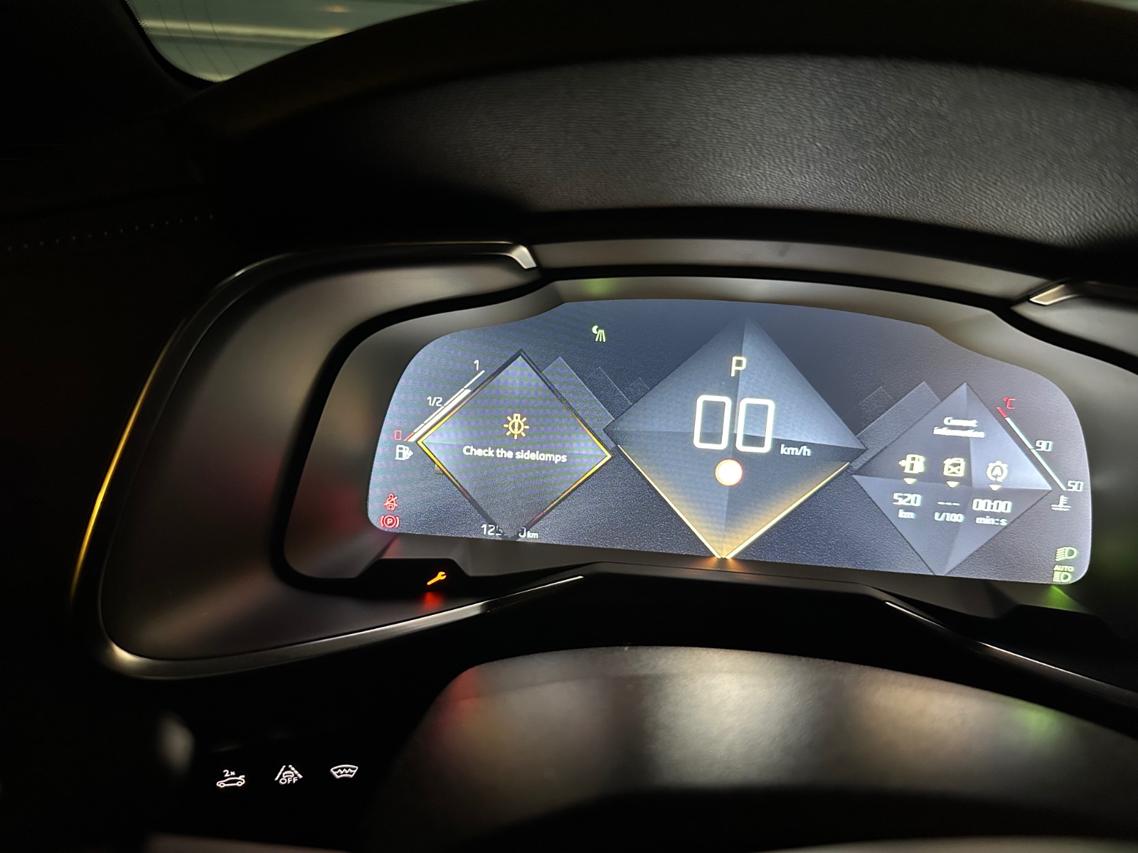

Update,

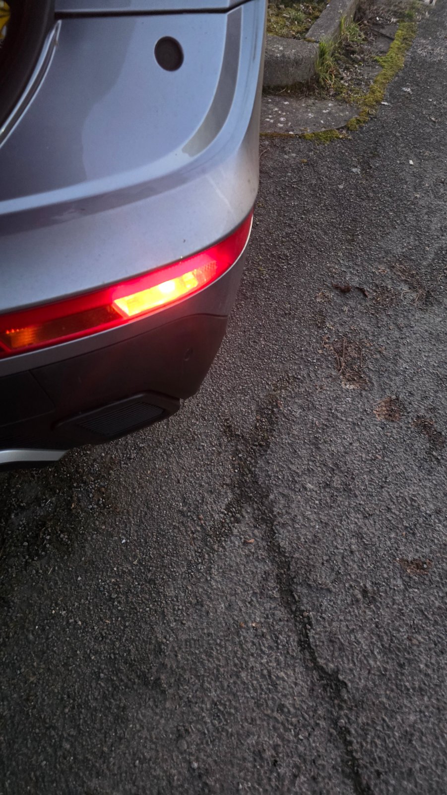

Now, after battery change (Varta AGM), I got wrench icon on dash, and saying “check side lamps”.
Especially it is triggered when I switch right indicator.
Everything works, every single led lamp/indicator.
The only thing that actually looks like not working are two orange indicators on bumper, that should be lighting up (hazard lights) when fifth door (boot) is opened UP, to take from main side indicator swiping (floating) led lights.
We tried opening boot and using hazard lights but they are not lighting. Service guy managed to pull one module from the bumper and all lights are ok.
It is really indicative that both orange lights in the bumper stopped working (not signaling) after battery change…
Really strange for me.. they told me to drive a few days to see if it will settle it self on its own…
Currently start/stop is just blinking 3-4 times green and nothing, guess that one also needs settling to communicate back/forth.
Any ideas would be really appreciated… I am desperate, as now apart from side mirrors not tilting in reverse, after battery change new issues introduced… crazy…
Thank you
Thank you

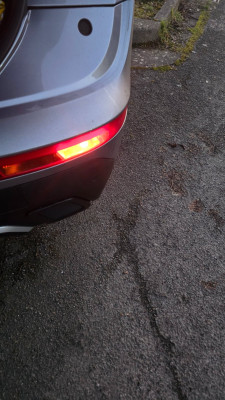

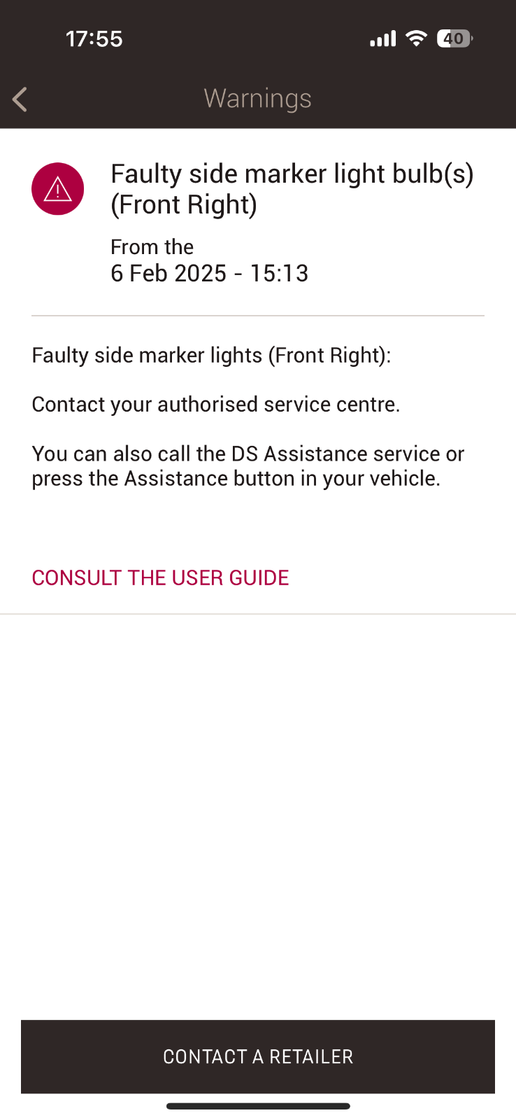

GiDrA
- Posts: 16
- Joined: 24 Mar 2024, 23:09
- x 1
Re: DS7 2018 weird seat/side mirror memory issue
Thank you,
I will check attached files once I am on my laptop.
Regarding start/stop it is now working normally, I read in “Scan MyDS” app it is normal for it not working on first trip from service shop, as it was in my case.
I am still with this same side marker lights (front/back rear), nothing changed on that field, even with 3-4 car starts and driving a bit.
I havent still tried BSI reset procedure, preparing myself for that “surgical”
procedure.
Regarding their (service shop) diag tool, really dont know what are they using. I know it is offline version without token (they have also token/online version for some other procedures). And I think they could not see that error that DS7 was showing on dashboard.
I am just hoping that BSI didnt get damaged or something like that… in some way.
Currently this is what I see in MyDS app as an error:
Attached screen shot
Basically now I see that second error disappeared actually. There was second one as “rear right side indicator light”, now I just see this one, front right side marker light.
In reality, I know that on rear bumper these two orange lights are not getting lit up, and also I think break lights left and right. But rear fog lights are working (on bumper as well).
I am emphasizing rear bumper lights (all of them are classic bulbs), as these are “backup” lights when tailgate is raised/opened and thus main rear led lights are up in the air.

The “only” issue is with normal bulbs in rear bumper. And not all of them, orange one are not lighting up and I think far left/right ones, that should be break lights - according to Scan MyDS app.
I think that only 2 rear fog lights (red) are working. The others that are depended on tailgate being opened are not. So that is the connection in someway, these bulbs that should take over when tailgate is opened.
I was thinking to check fuses below steering wheel and secondly to perform BSI reset procedure (hopefully right), as I dont know if I did it correctly or not…

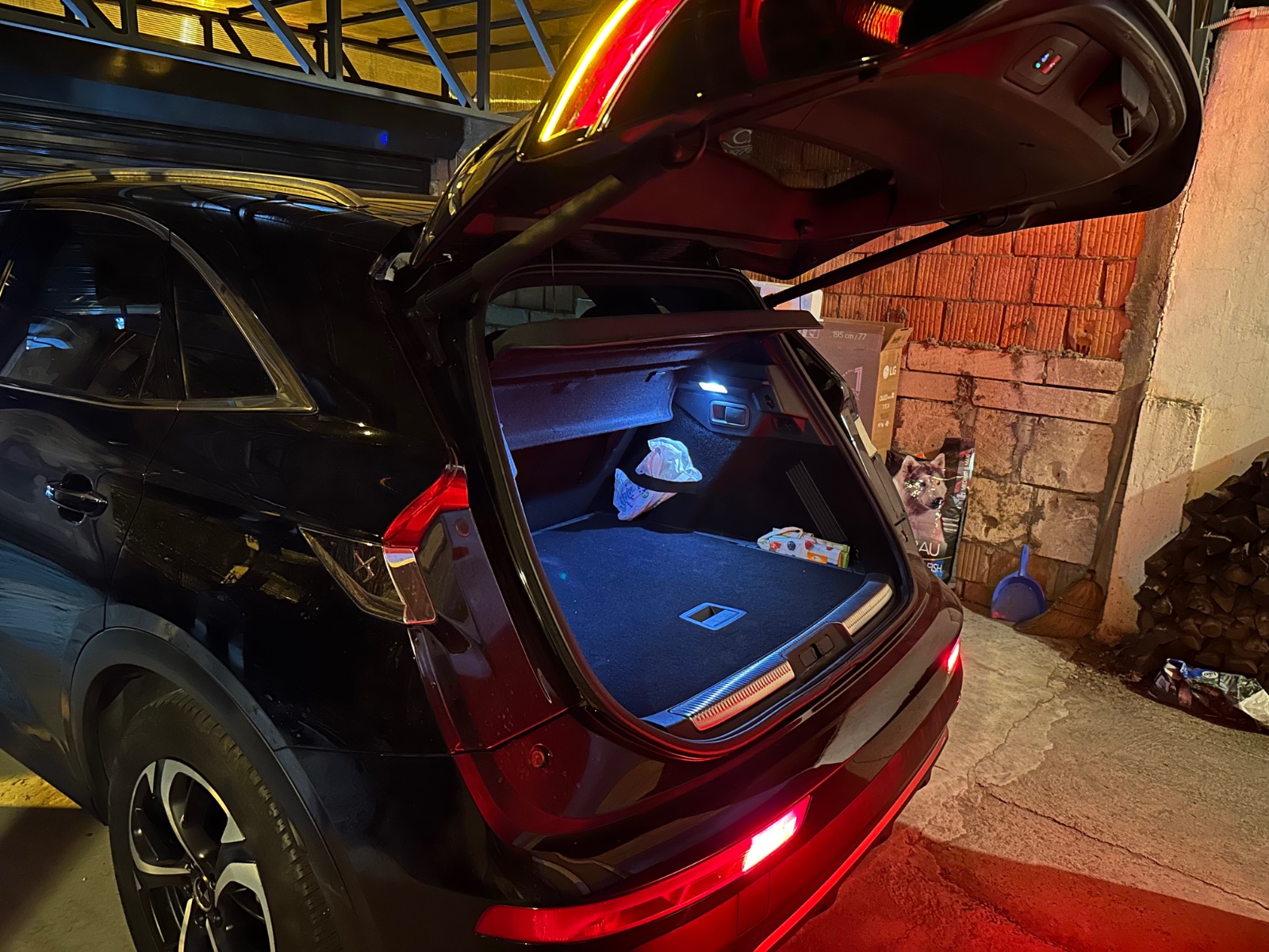

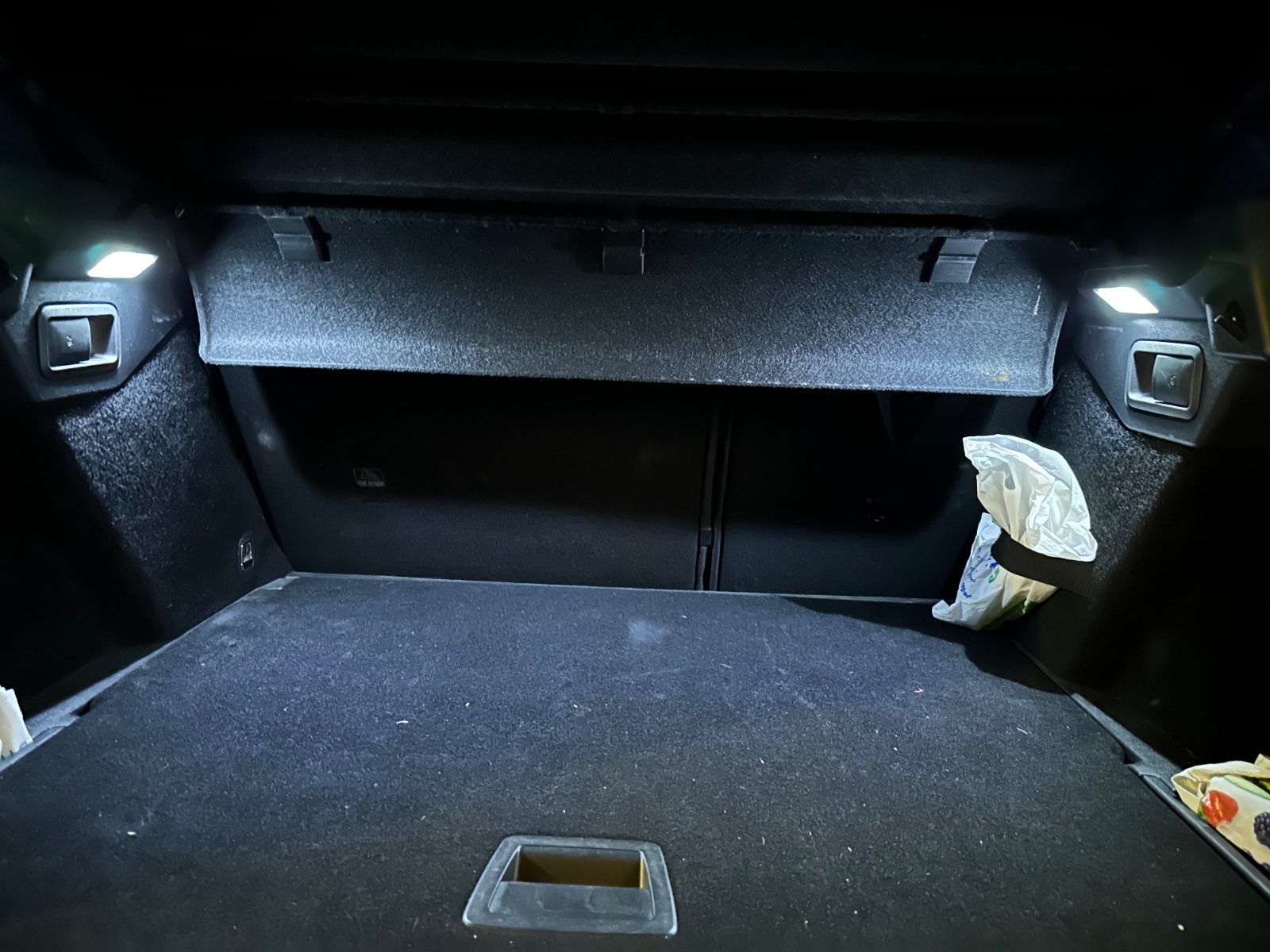

GiDrA
- Posts: 16
- x 1
GiDrA
- Posts: 16
- x 1

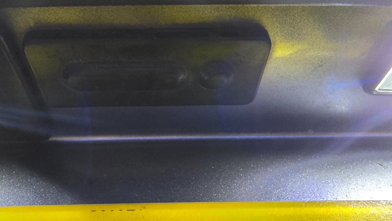

Opening/closing the tailgate works both with button or kicking under rear bumper. Lights inside are active.
Regarding bulbs on rear bumper, only fog ones are lighting up… I even clicked hazard lights and raised tailgate, but sweeping ones (led) are still working up there, but none on the bumper, neither position ones, just 2 fog ones.
Also, now when I used lock button on the tailgate it did lock (needed to hold a bit longer), but now car is looking it self every 30sec to 1 min or so, dont know what is going on, like deadlocking it self, even I think I hear windows trying to shut even more (like holding lock on key fob).
Definitely I will need to perform BSI reset.
One last thing, curtesy lights do not light up under each of side mirrors, the ones with DS logo projecting on the ground… must be connected to this issue.
Attaching few screen shots
