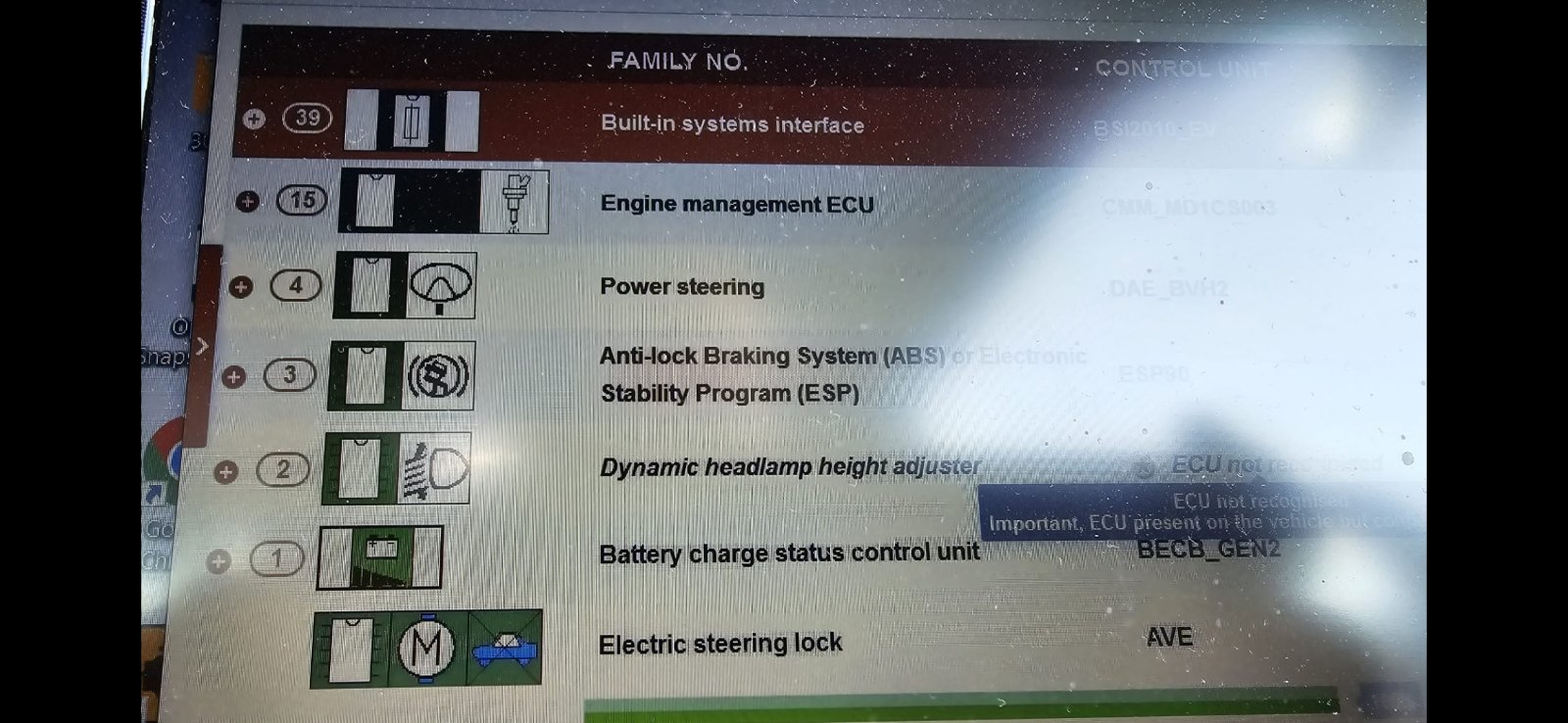

Had a better one). Left on charger for a while, I put a lights on while cleaning dashboard, after a while switched off. After charging I was trying to start it up, but car was behaving strange.. Starter was running, got engine malfunction icon, suddenly another message pops up - put a handbrake on... Couldn't started at all. Diagbox showed 89 faults. After clearing it engine started up as usual.....
