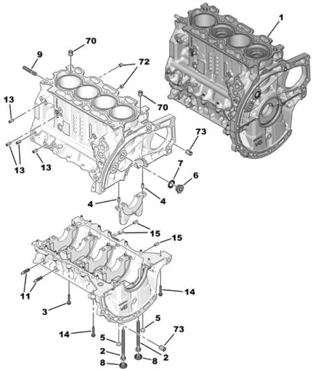

Hello yet another request whree can i get the caps that cover the mainbearing bolts ( flywheel end knock on metal cap over bolts x2 part number if possible ) Many thanks yet again Phil .

Can't help with the torques, but let me know what part numbers you need for any items on the diagram: once you have these you can order them from your dealer or elsewhere if available.

Re: Help needed with BHZ Engine
Not wanting to stand on Marc's toes,
The metal caps are on the diagram for engine block,

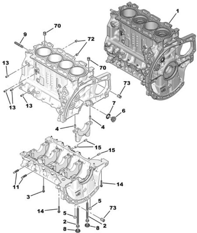

Thanks Steve - Engine Block Diagram too:

Thanks to all . Steve have you a part number for items 2 and 8 in the last diagramme . Thanks Phil .
Hi Phil
Numbers I have are not guaranteed to be up to date, The Mods / admin will have access to latest data.
But
Number 2. 0132 54
Number 8.0167 82
So that part number for (2) is out of date Steve.
(2) MUL Hex Head Machine Screw, part: 9813900780, £3.19
(8) Well Cap on Cylinder Block, part: 016782, £2.46

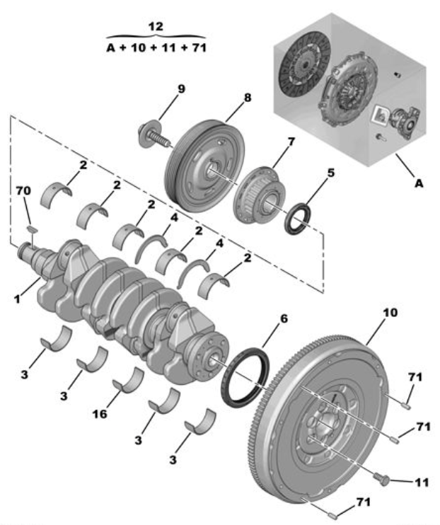

Hello the story goes on . i am now after a con rod as the bearings have spun and damaged the inner face .
So my question is are the rods all the same i have a BHZ engine ( Vin supplied in this earlier post ) can i have a part numer if possible are all the (B) engines the same internally ?
