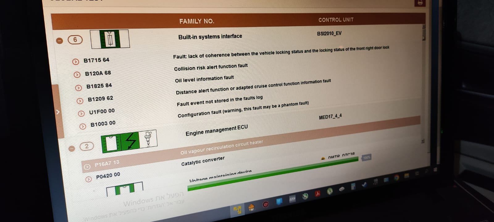

there is a check engine light and the code is p0420 catalytic converter, and p16a7 13 oil vapor recirculation system.

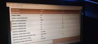

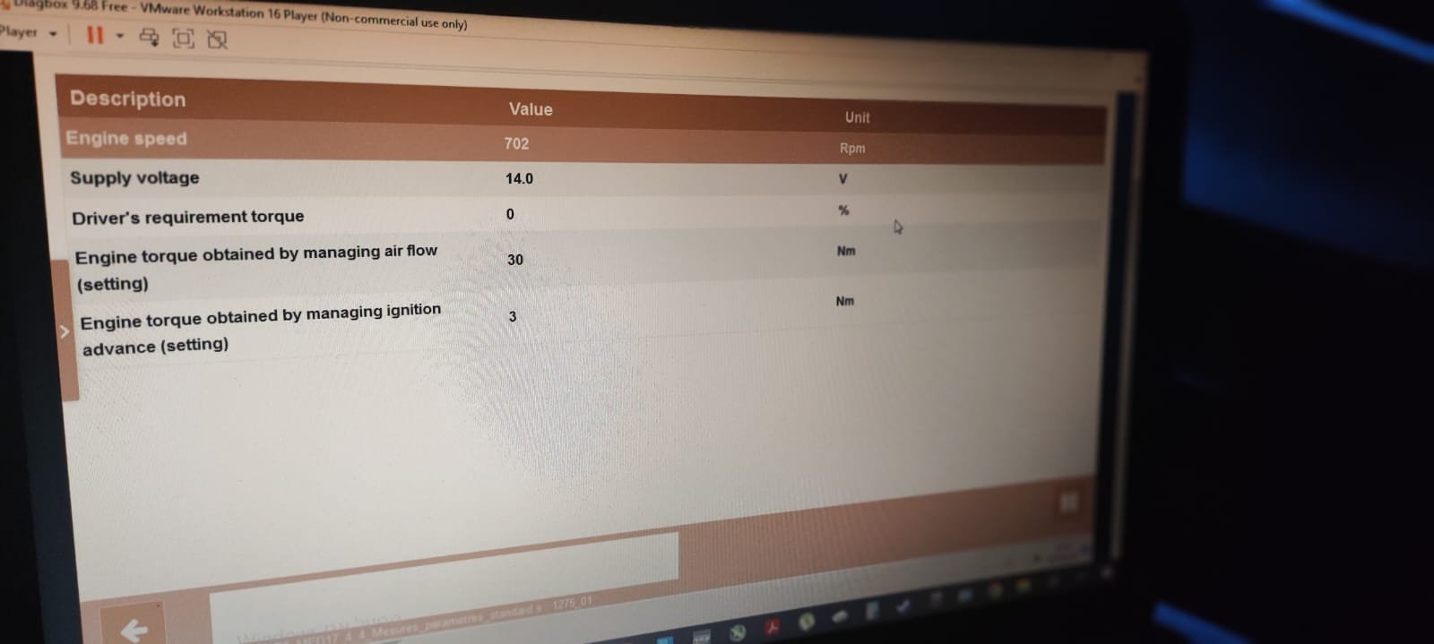

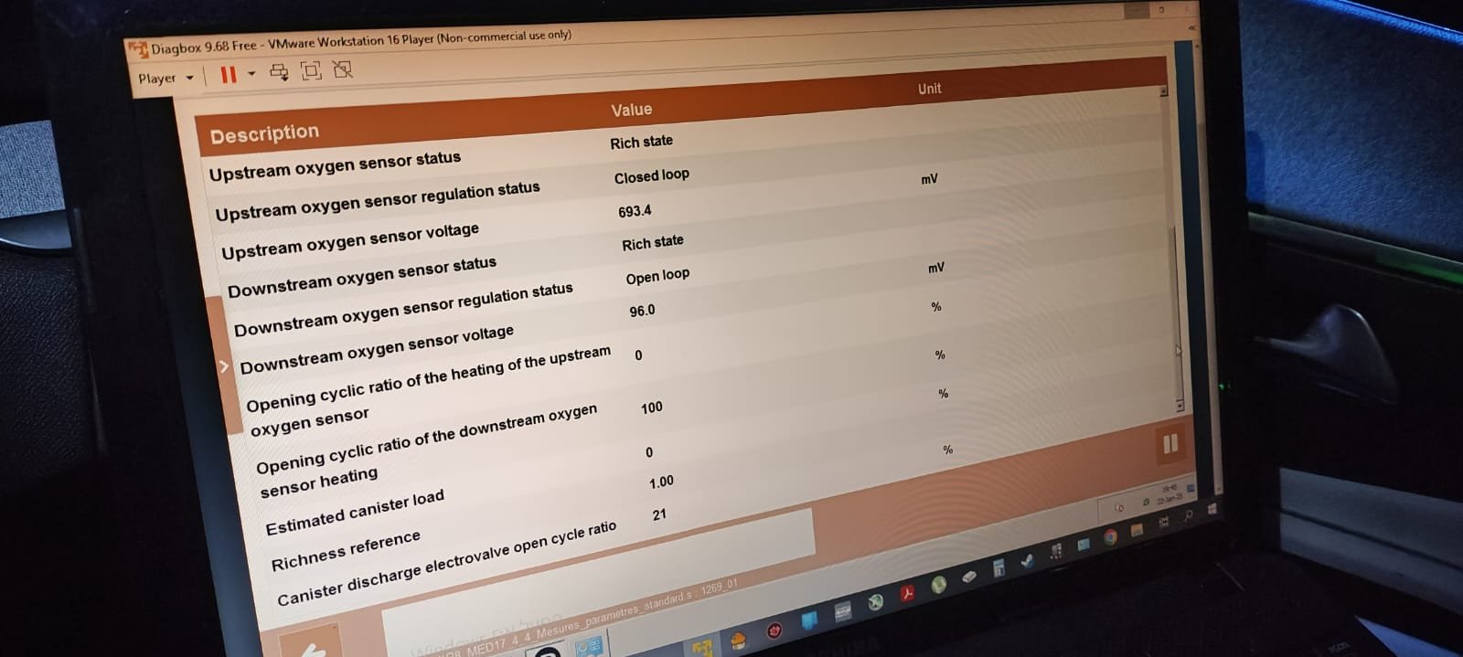

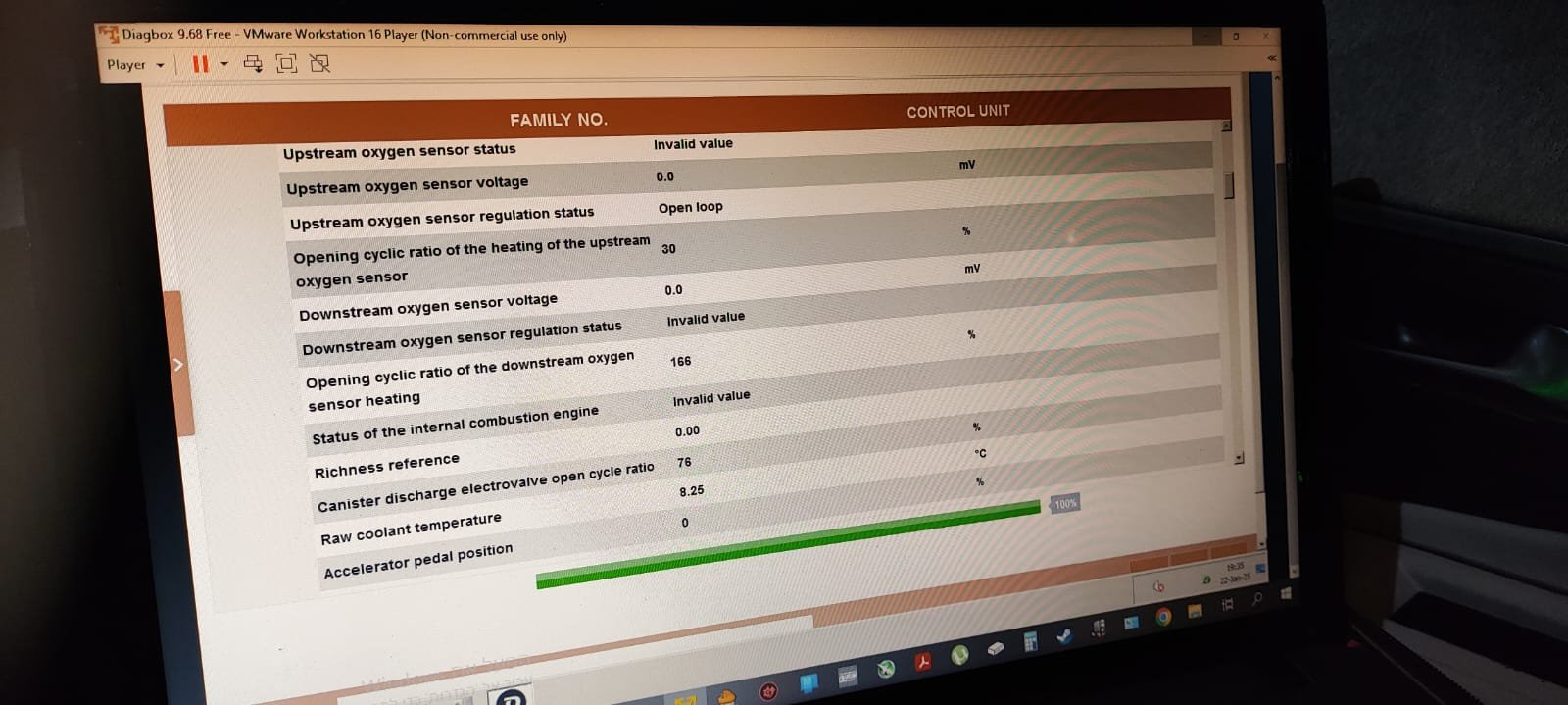

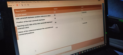

also i looked on the live information of the injection and fuel mixture to see if there is something off and found that some weird values i think.
i would appriciate if you could take some time to look at these pictures and say if you see something off.

It's very difficult to make out what Diagbox says in those pictures and they don't seem to work when going directly to Imgur (I get a blank page each time).
Please try to upload them directly into the post through the attachments tab:

Hi thanksMuir wrote: 09 Feb 2025, 15:37 Hi, welcome to the forum.
Please try to upload them directly into the post through the attachments tab:![]()
i updated the post

Thanks that helped a ton.
I'm not very experienced with newer gas engines but did find another post about the P16A7 13 fault:
viewtopic.php?t=83412
One of the symptoms are presumably like the one you're experiencing, engine hesitant.
It's tempting to think this may also be related to your cat DTC.
My thought is your PCV valve is somewhat defective and is bypassing a lot more oil into the inlet manifold than it should, which in turn is poisoning/has ruined your catalytic converter.
If the cat is defective it would throw off the rich/lean readings.
It's just a guess though and I can't say if the PCV vapor heater being defective could cause this.
You could try removing your oxygen sensor and having a look-see, since it's easily accessible on the left side of the turbo.

I'd check the oxygen sensor first thing.Idan167_ wrote: Thank you for your answer,
A question, since the pcv valve is not expensive to replace, should i start with that?
Also if i remove the oxygen sensor what do i suppose to see?
Another thing, a friend of mine is suspecting the high pressure fuel pump, as he had a same experience but with a whole different type of car. Could it be it?
You'll want it to be completely dry with with maybe a thin layer of greyish/brownish deposits that easily brush off.
As for the PCV you could try removing the intake pipe after the PCV valve connector, maybe the flex part that connects to the turbo inlet (engine off of course).
It's hard to determine if the amount of oil you find in there is abnormal, unless it's downright dripping out of it.
Could very well be a fuelling issue yeah - try comparing desired & actual fuel rail pressure.
