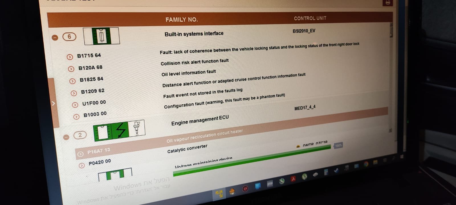

there is a check engine light and the code is p0420 catalytic converter, and p16a7 13 oil vapor recirculation system.

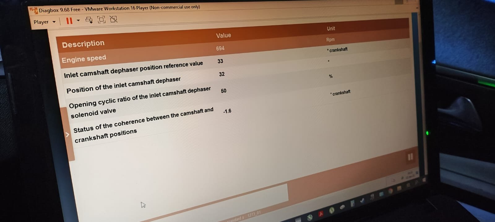

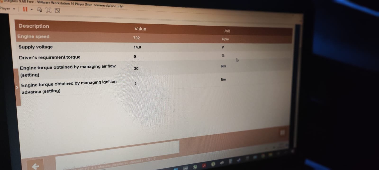

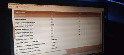

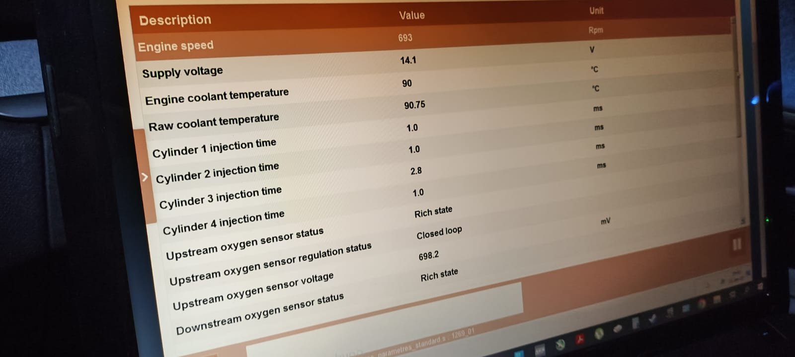

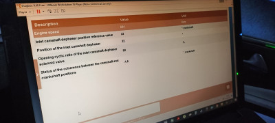

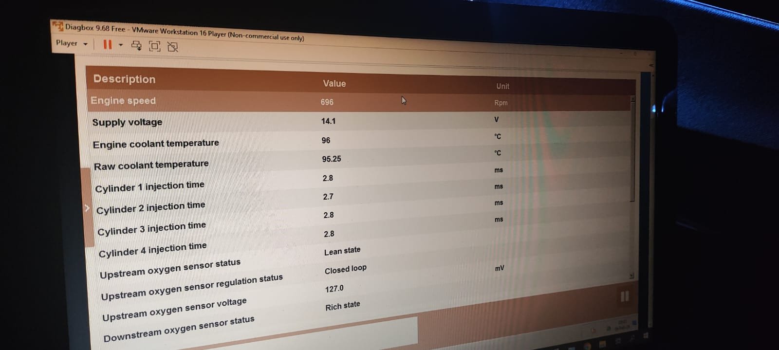

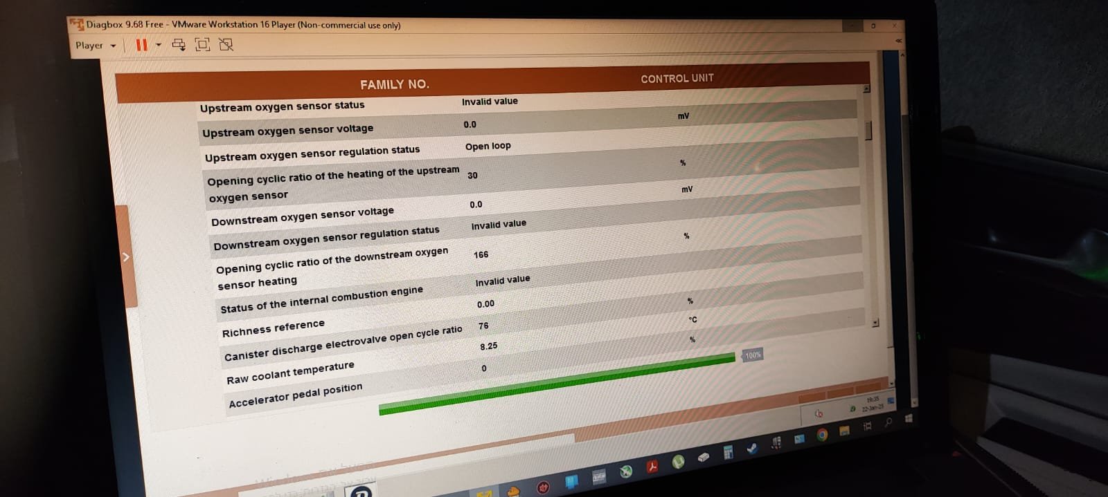

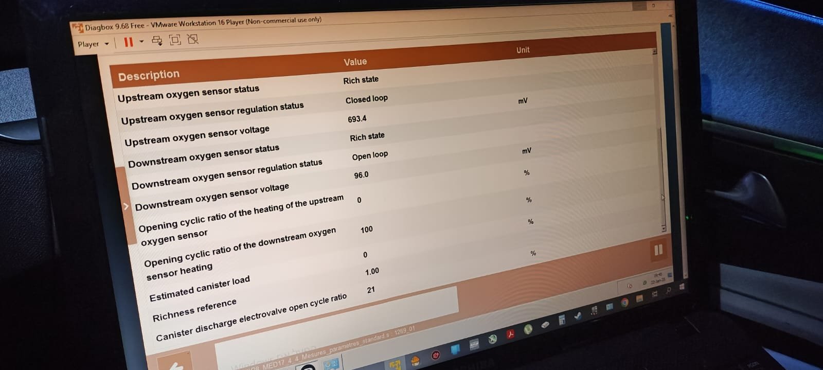

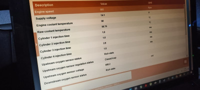

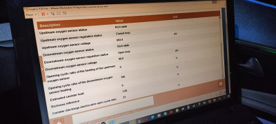

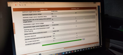

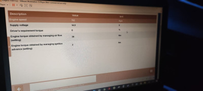

also i looked on the live information of the injection and fuel mixture to see if there is something off and found that some weird values i think.
i would appriciate if you could take some time to look at these pictures and say if you see something off.

Hi, welcome to the forum.

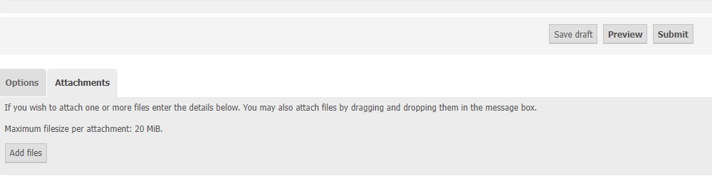

It's very difficult to make out what Diagbox says in those pictures and they don't seem to work when going directly to Imgur (I get a blank page each time).
Please try to upload them directly into the post through the attachments tab:

Hi thanksMuir wrote: 09 Feb 2025, 14:37 Hi, welcome to the forum.
Please try to upload them directly into the post through the attachments tab:![]()
i updated the post

Re: 3008 1.6 thp lakcs power, hesitations and small stutters
Thanks that helped a ton.
I'm not very experienced with newer gas engines but did find another post about the P16A7 13 fault:
viewtopic.php?t=83412
One of the symptoms are presumably like the one you're experiencing, engine hesitant.
It's tempting to think this may also be related to your cat DTC.
My thought is your PCV valve is somewhat defective and is bypassing a lot more oil into the inlet manifold than it should, which in turn is poisoning/has ruined your catalytic converter.
If the cat is defective it would throw off the rich/lean readings.
It's just a guess though and I can't say if the PCV vapor heater being defective could cause this.
You could try removing your oxygen sensor and having a look-see, since it's easily accessible on the left side of the turbo.
