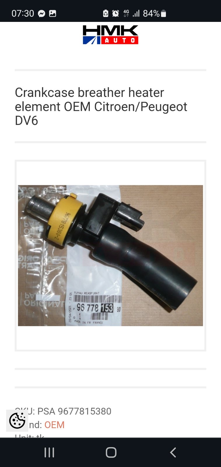

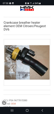

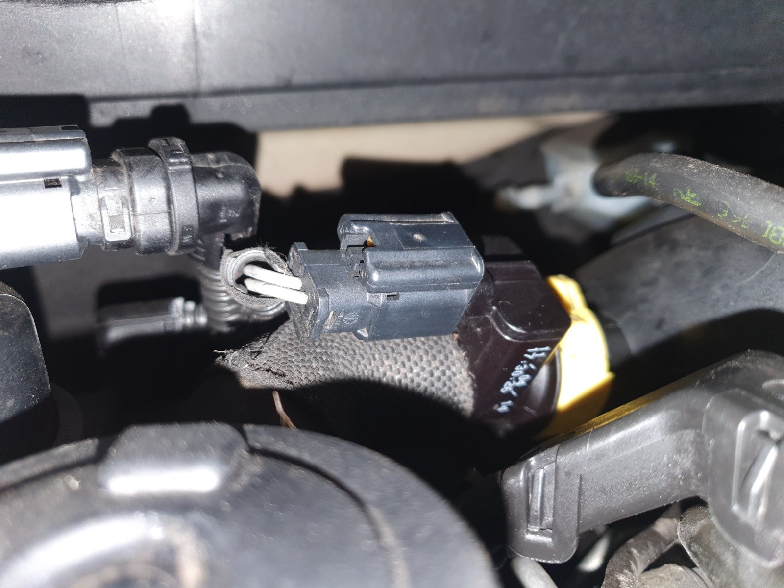

So I have a 2014 picasso 2.0 blue hdi
I have a p16a7 13 fault ...control of crankcase fumes heater
I can't find much info on this but I'm thinking its the yellow thing with wires near rocker cover
Just wondering if anybody can help identify it or know any details

Yes I'm trying to find if this the part as it called lots of different things online
Posts: 42019
x 6955
Re: P16a7 13 very little info
Yes, that's the Crankcase Gas Breather Pipe.
