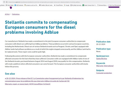

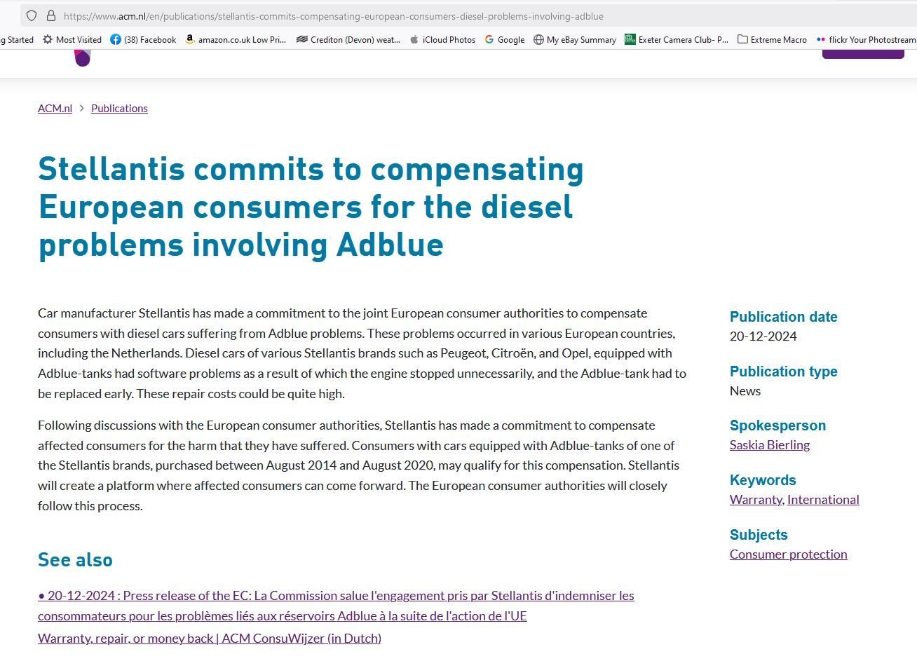

Just to add to this..............
I found a screenshot of a Stellantis publication (as attached) stating "adblue-tanks had software problems as a result of which the engine stopped unnecessarily, and the adblue-tank had to be replaced early"
So now I am wondering what the fix would be?
Would it be a programming update to the ECU?
Or would it be an adblue tank/pump unit replacement because of a pump/controller board chipset software programming error?
Anybody out there with more info on this?

I do understand the compensation scheme.
What I am wondering is what do they actually do when they carry out a repair, as on behalf of all us owners who are, for whatever reason, not covered by the scheme, what is the 'software problem' they refer to?
I ask this because from the details in the announcement I posted, it is not clear if vehicles suffered from the software problem before and then also after the repair. I think we are all aware of cases where the tank has been replaced on more than one occasion and the fault returned.
Here is the actual link to the document I refer to: https://www.acm.nl/en/publications/stel ... 0problems.

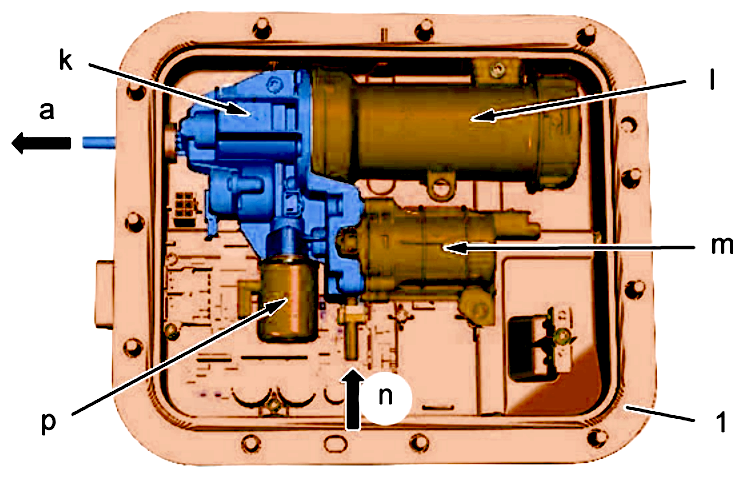

So there can be several issues, but the most common one is a fault code P20E8, which is low Adblue pressure.
For a low pressure issue problem, there are obvious things to check externally first, like:
Checking to see if the Adblue injector itself is clogged with crystals by removing and inspecting it. If this is clean, then you can generally rule that out.
Next you would check for a leak by checking the urea pipe back to the tank for signs of leaks / crystallisation anywhere.
Inside the Urea Reservoir is the pump, a heating system, a temperature sensor, a level sensor, an electro shuttle valve and a pressure accumulator as well as the electronic components on a board.
Internal to the reservoir tank, the pump assembly sits on top with a pick up pipe going to the main reservoir underneath, which also contains a filter, but this can't be checked for clogging without damaging the assembly as it's more ort less sealed and will likely result in some damage if forcibly removed.
In basic terms, the pump operates to keep the Adblue accumulator filled with Adblue at a pressure of between 5-6 Bar. 6 Bar means the accumulator is fully pressurised with Adblue. 5 Bar means it's at the lower end, and this triggers the pump to refill it again.
So if the accumulator is showing as pressurised with a diagnostic tool and shows a pressure of between 5-6 Bar, then that only shows there is pressure in the accumulator, - but this doesn't mean the pump is working, as this will only kick in when the accumulator falls to about 5 Bar.
Taking the reservoir off the vehicle and inspecting the internals will determine if the pump, shuttle valve and accumulator is working - as you will be able to test this operation by connecting up a supply to each and testing the operation.
But if the pump will not activate when commanded to by your diagnostic tool, yet is working when manually powered up, then the most likely problem is the electronic board - which is failing to issue the command to the pump to operate. So in reality, the whole tank assembly is generally replaced.
Here's a typical PSA SCR System Reservoir Assembly:
(1) Urea Pump - Gauge Module.
"a" Urea solution outlet to the Urea Heated Pipe.
"k" Distributor.
"l" Accumulator.
"m" Pump.
"n" Urea solution inlet.
"p" Electrovalve.
Once heated, the urea solution is drawn in at "n" by the pump "m".
The pump "m" supplies the accumulator "l" with urea solution via the intermediary of the electrovalve "p".
