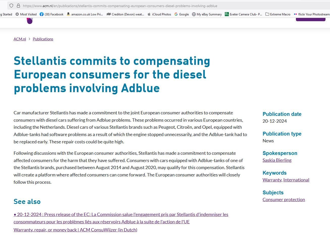

Just to add to this..............
I found a screenshot of a Stellantis publication (as attached) stating "adblue-tanks had software problems as a result of which the engine stopped unnecessarily, and the adblue-tank had to be replaced early"
So now I am wondering what the fix would be?
Would it be a programming update to the ECU?
Or would it be an adblue tank/pump unit replacement because of a pump/controller board chipset software programming error?
Anybody out there with more info on this?

I do understand the compensation scheme.
What I am wondering is what do they actually do when they carry out a repair, as on behalf of all us owners who are, for whatever reason, not covered by the scheme, what is the 'software problem' they refer to?
I ask this because from the details in the announcement I posted, it is not clear if vehicles suffered from the software problem before and then also after the repair. I think we are all aware of cases where the tank has been replaced on more than one occasion and the fault returned.
Here is the actual link to the document I refer to: https://www.acm.nl/en/publications/stel ... 0problems.

The issues have been various and are often conflated, so I can't provide the specifics, as Stellantis simply replace the tank after the specific guided diagnosis yields the results required for a warranty repair. This is why the dealerships have to run the specific diagnostics and tests to determine a faulty tank / pump assembly.
There are other problems, some not related to the tanks - i.e. Crystallisation, Urea Injector clogged, heated Urea pipe fault leading to crystallisation as mentioned, NOx sensor failure for example as well as the actual tank rust / oxidisation, pump failure. The SCR system is managed by the Engine ECU and sometimes a software update to the engine ECU can fix a specific problem.
All we know that there have been replacement tanks over the years and during a model's production run, supposedly improved using less metal parts and other improvements, but they don't make these details available publicly.
My own vehicle will be included in the date range by 9 months of the above mentioned scheme, but mine is just 5 years old with only 26k miles. So maybe too early to have any issues. To date it's been working perfectly, but I always top my tank up every 2-3 months and use an anti Adblue additive as part of the mixture when doing so.
