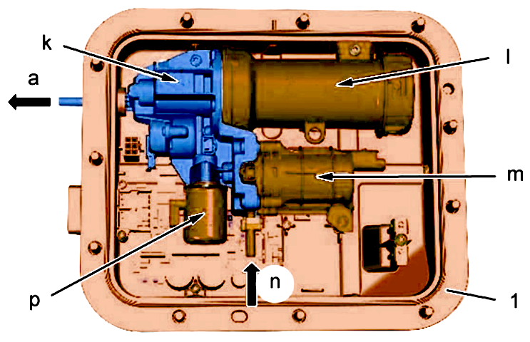

So there can be several issues, but the most common one is a fault code P20E8, which is low Adblue pressure.
For a low pressure issue problem, there are obvious things to check externally first, like:
Checking to see if the Adblue injector itself is clogged with crystals by removing and inspecting it. If this is clean, then you can generally rule that out.
Next you would check for a leak by checking the urea pipe back to the tank for signs of leaks / crystallisation anywhere.
Inside the Urea Reservoir is the pump, a heating system, a temperature sensor, a level sensor, an electro shuttle valve and a pressure accumulator as well as the electronic components on a board.
Internal to the reservoir tank, the pump assembly sits on top with a pick up pipe going to the main reservoir underneath, which also contains a filter, but this can't be checked for clogging without damaging the assembly as it's more ort less sealed and will likely result in some damage if forcibly removed.
In basic terms, the pump operates to keep the Adblue accumulator filled with Adblue at a pressure of between 5-6 Bar. 6 Bar means the accumulator is fully pressurised with Adblue. 5 Bar means it's at the lower end, and this triggers the pump to refill it again.
So if the accumulator is showing as pressurised with a diagnostic tool and shows a pressure of between 5-6 Bar, then that only shows there is pressure in the accumulator, - but this doesn't mean the pump is working, as this will only kick in when the accumulator falls to about 5 Bar.
Taking the reservoir off the vehicle and inspecting the internals will determine if the pump, shuttle valve and accumulator is working - as you will be able to test this operation by connecting up a supply to each and testing the operation.
But if the pump will not activate when commanded to by your diagnostic tool, yet is working when manually powered up, then the most likely problem is the electronic board - which is failing to issue the command to the pump to operate. So in reality, the whole tank assembly is generally replaced.
Here's a typical PSA SCR System Reservoir Assembly:
(1) Urea Pump - Gauge Module.
"a" Urea solution outlet to the Urea Heated Pipe.
"k" Distributor.
"l" Accumulator.
"m" Pump.
"n" Urea solution inlet.
"p" Electrovalve.
Once heated, the urea solution is drawn in at "n" by the pump "m".
The pump "m" supplies the accumulator "l" with urea solution via the intermediary of the electrovalve "p".
The control of the distributor "k" permits alternate:

That is a good summarisation of any potential faults.
Don't forget the pressure sensor issue. With the P20E8 error, the pressure sensor might be faulty and not allowing the pump to operate. There are a couple of possible fixes in that other thread.GiveMeABreak wrote: 14 Feb 2025, 23:30 But if the pump will not activate when commanded to by your diagnostic tool, yet is working when manually powered up, then the most likely problem is the electronic board - which is failing to issue the command to the pump to operate. So in reality, the whole tank assembly is generally replaced.
