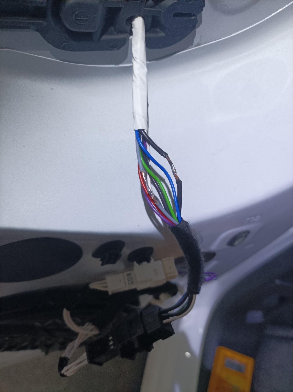

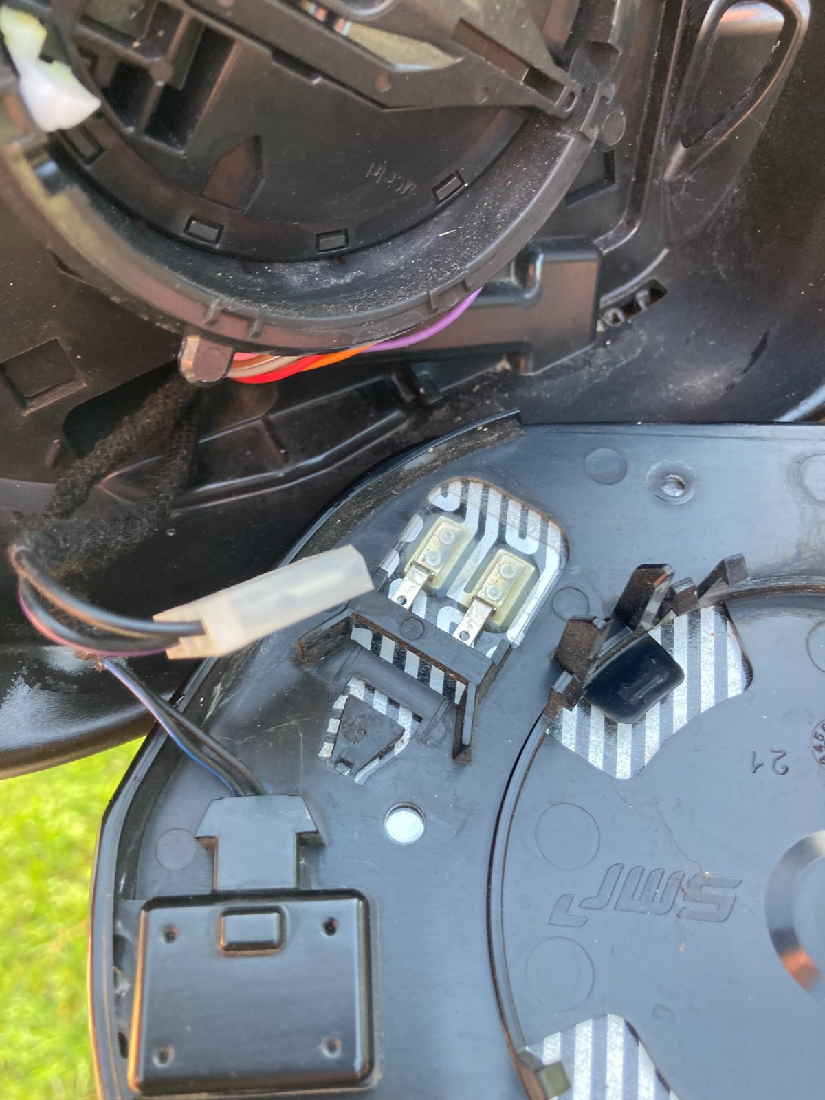

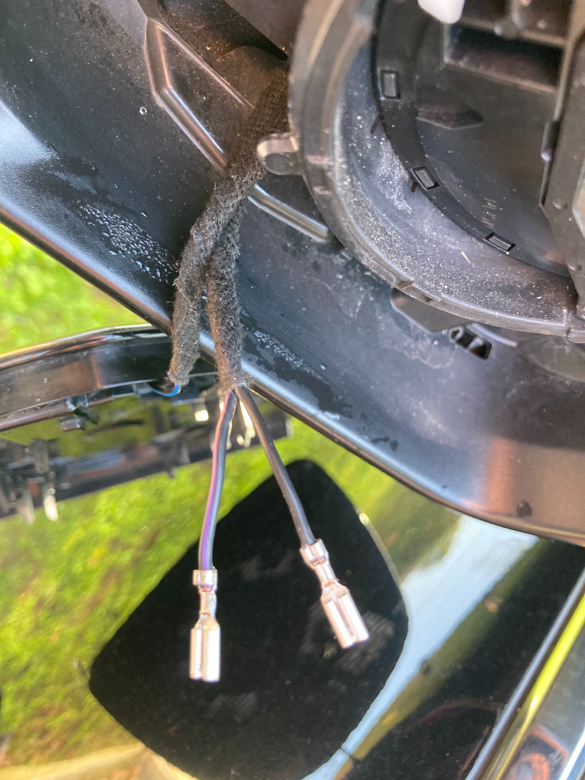

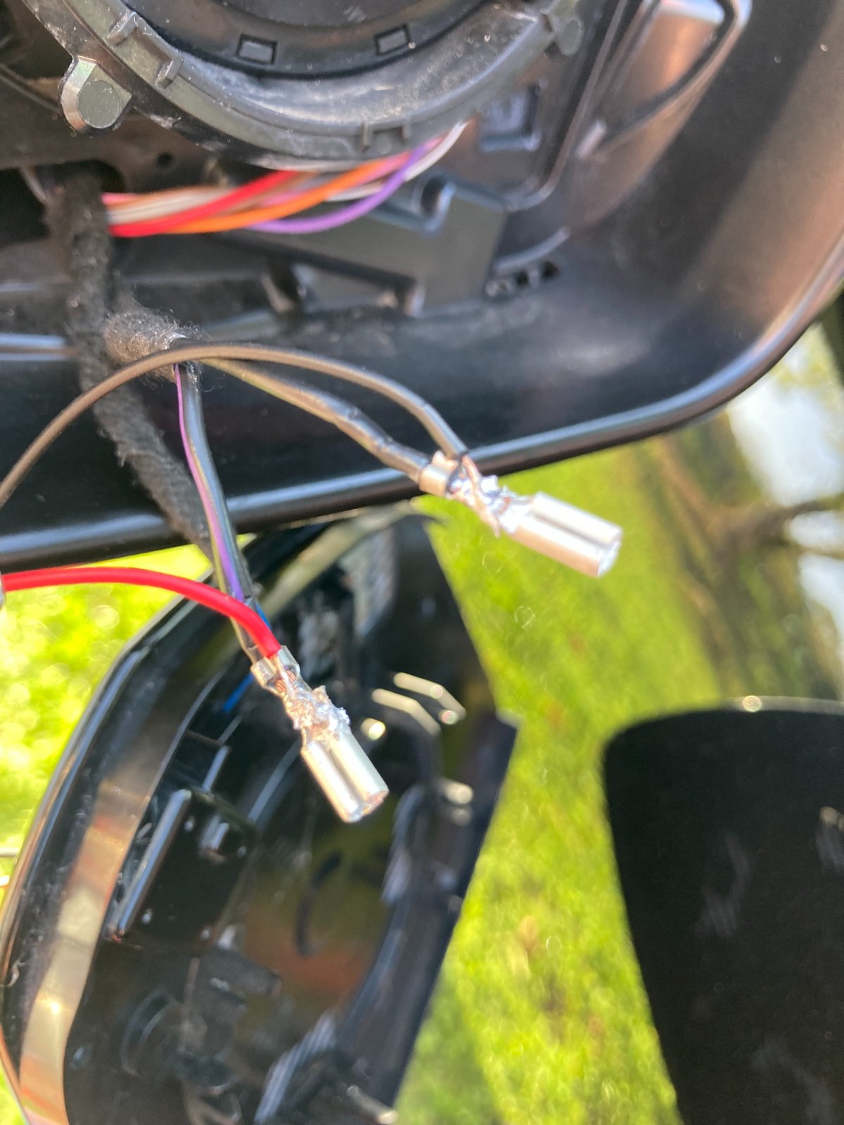

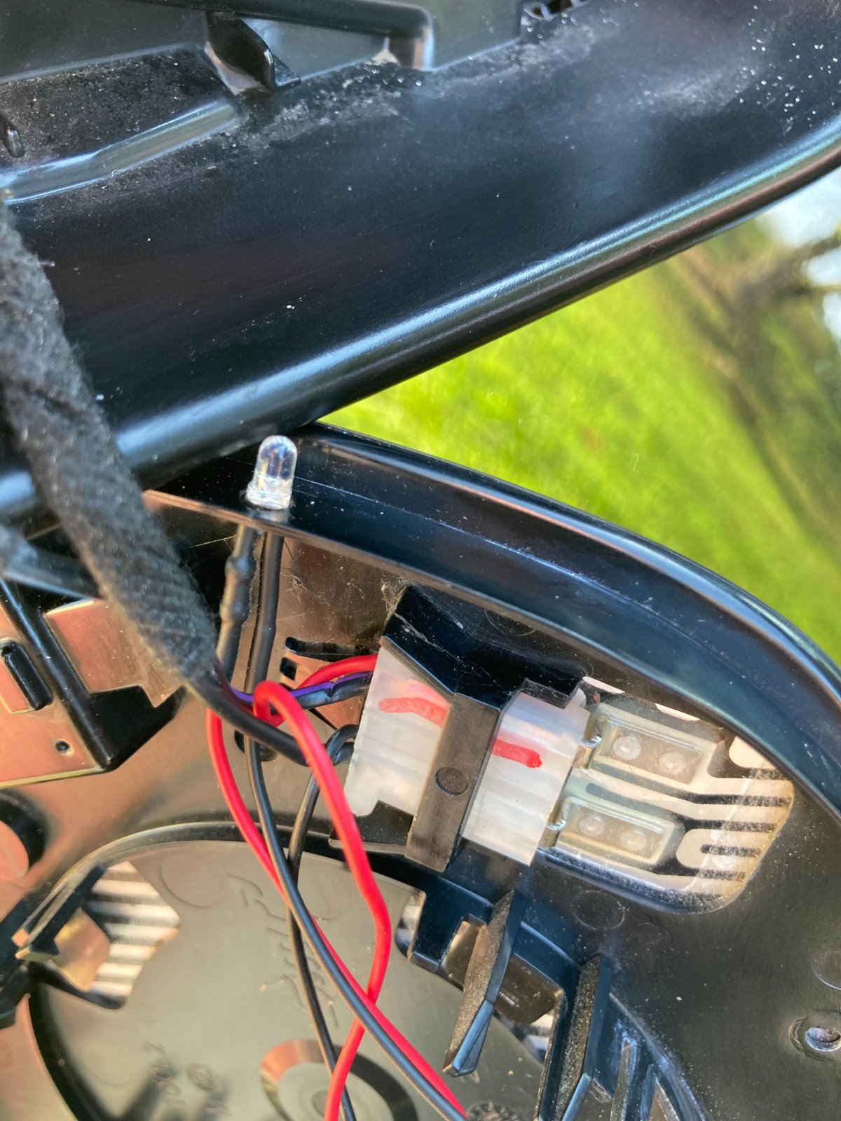

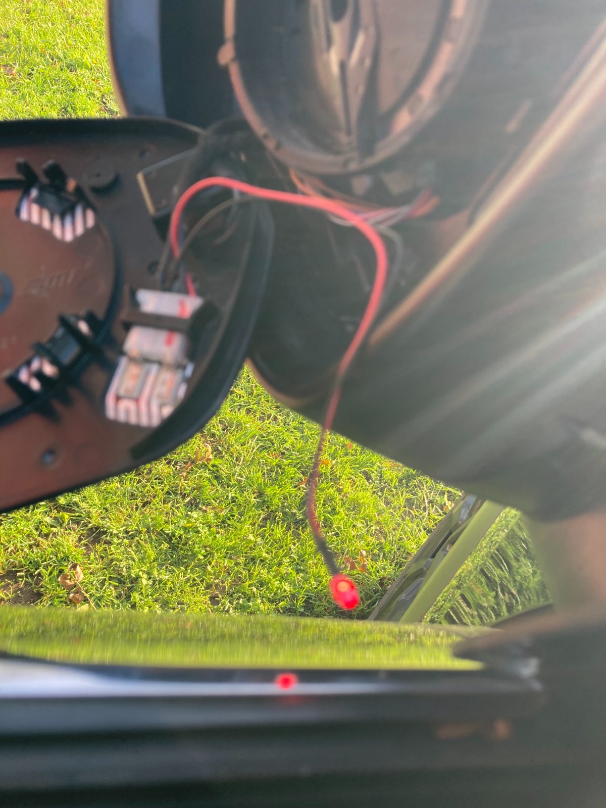

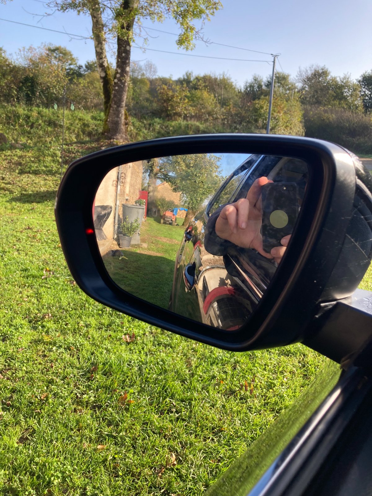

I soldered in a LED behind the drivers side mirror on my last car, connect to the 2 heater wires and attach to the rear of the glass with some glue so that you can see it in the gap between glass and housing..
Planning on doing it to my latest one when I get time
Posts: 3293
Joined: 11 May 2022, 19:54
x 1068
Re: Dpf regen
Unread post by Rp0thejester »
If you do that, could you post a how to with photos, I would be interested in seeing how it's done.
Steve Walsh
Posts: 775
Joined: 25 Oct 2019, 07:20
x 516
Re: Dpf regen
Unread post by Steve Walsh »

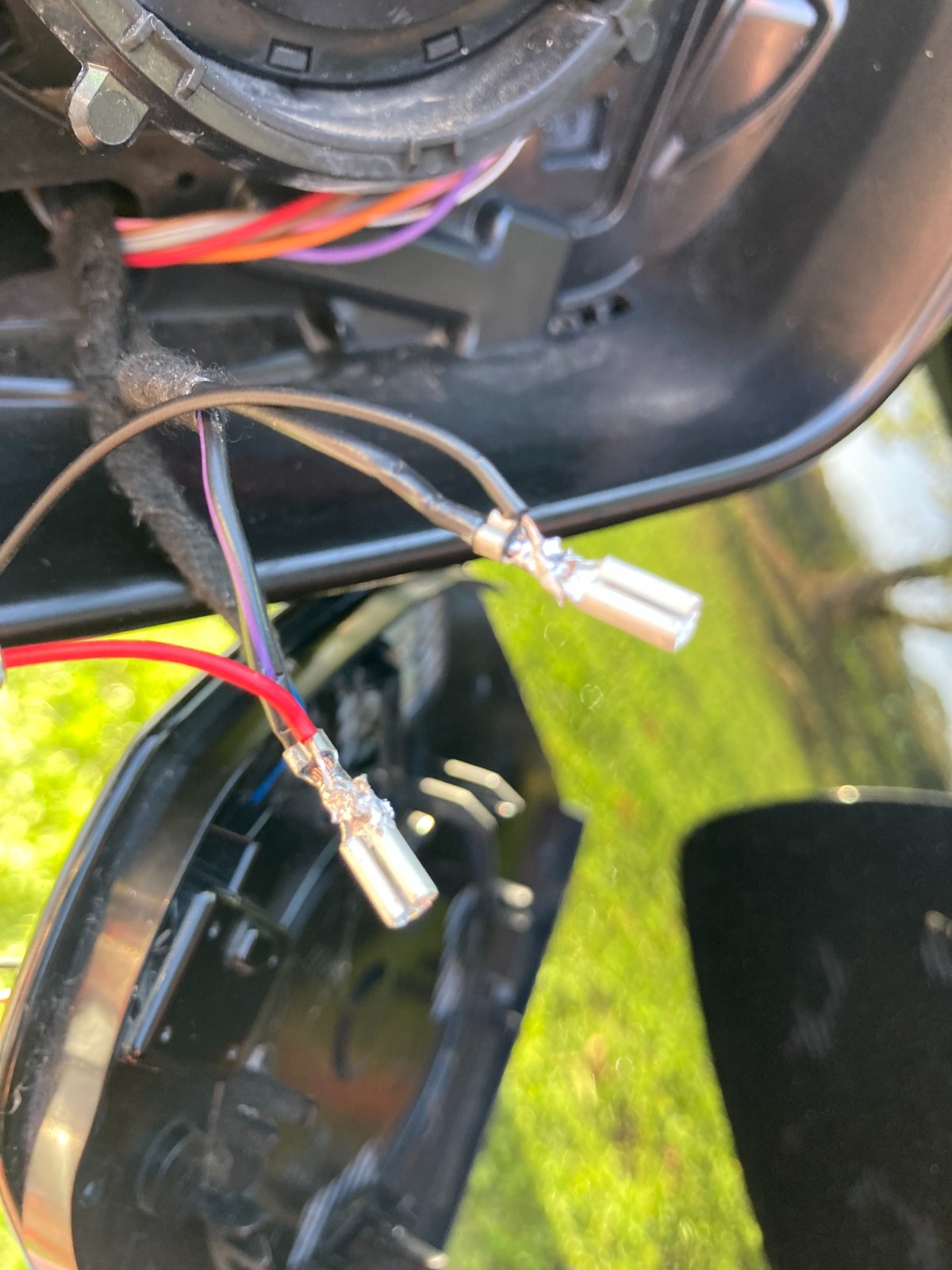

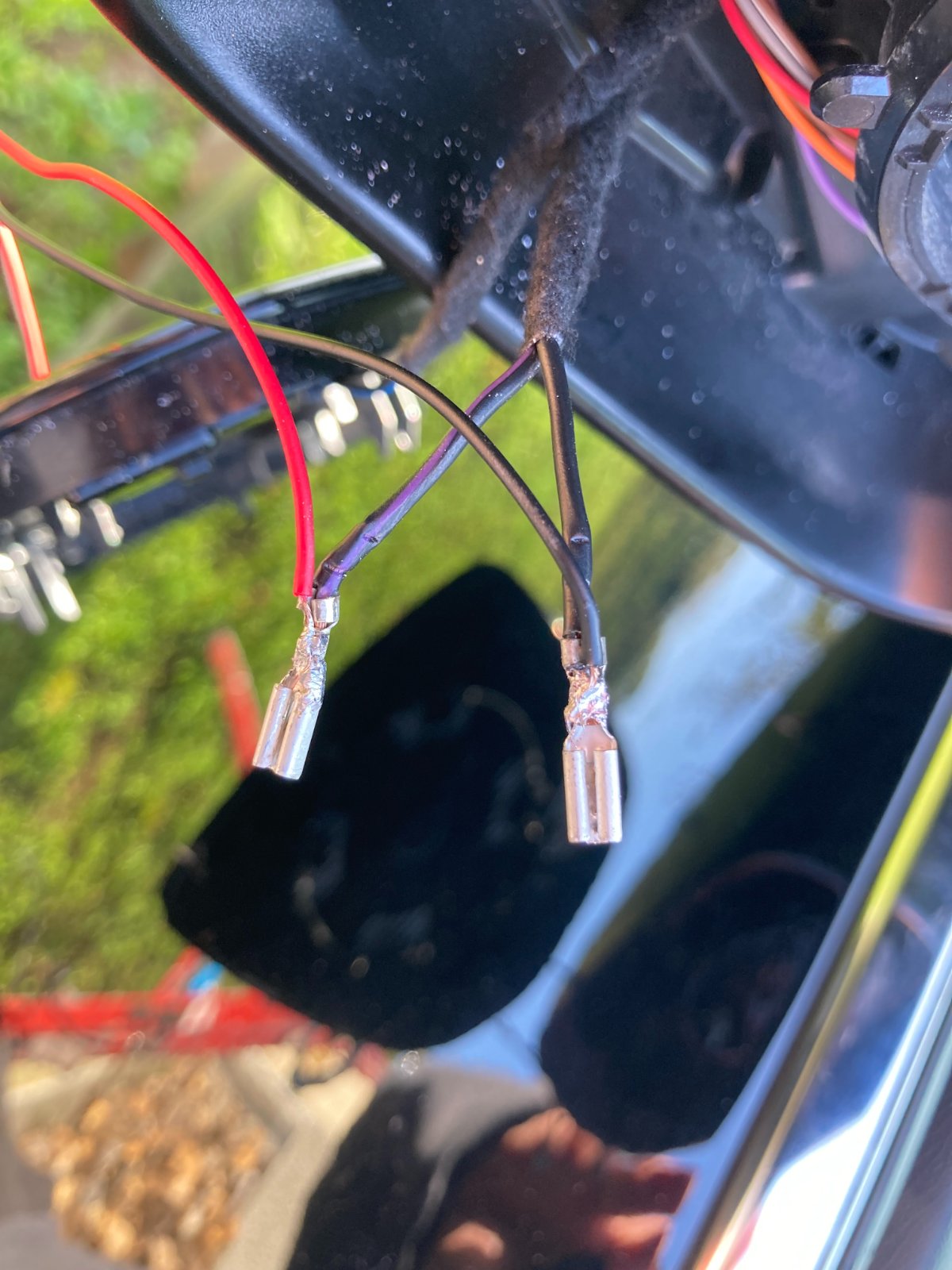

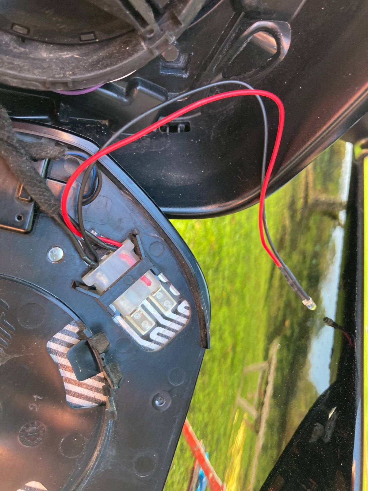

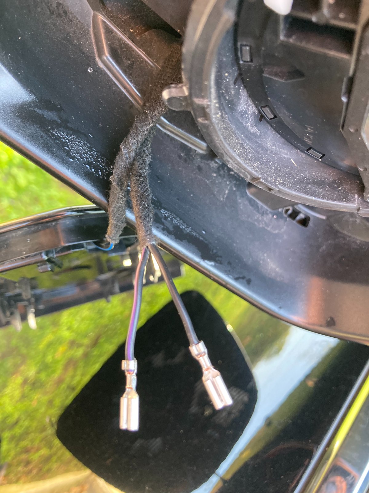

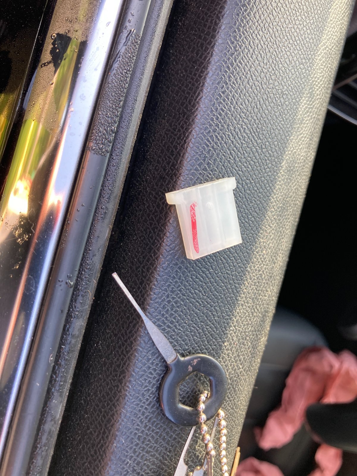

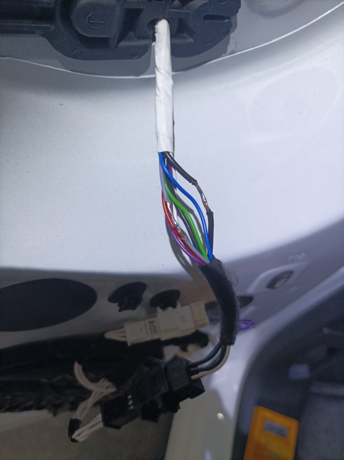

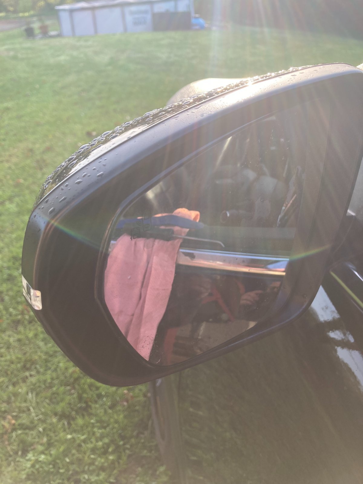

Rp0thejester wrote: 30 Oct 2024, 18:44 by Rp0thejester » Yesterday, 19:44
[/quote
Just done it this morn, 30 mins start to finish.

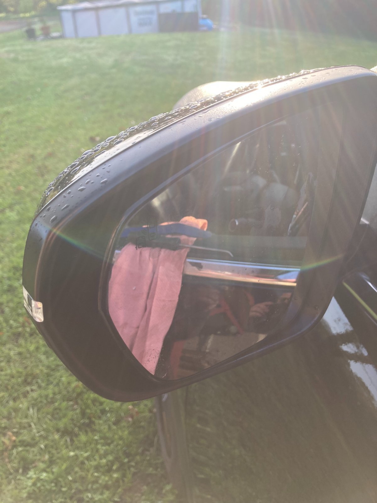

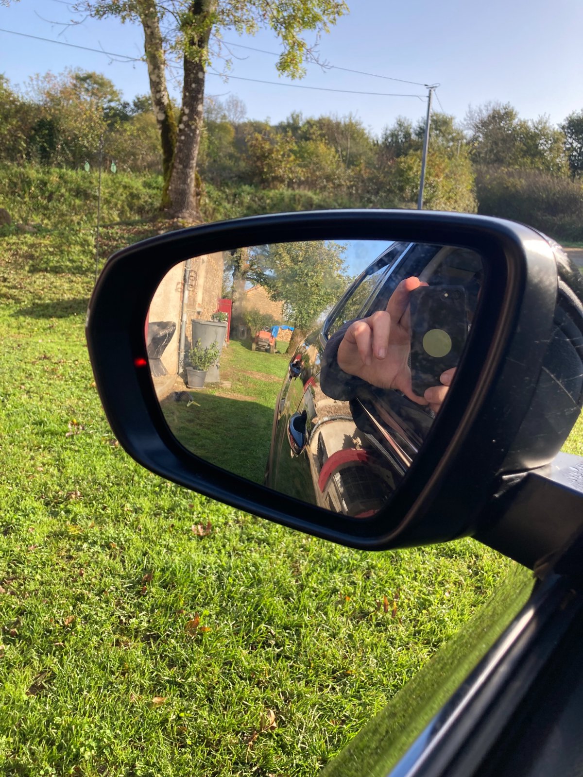

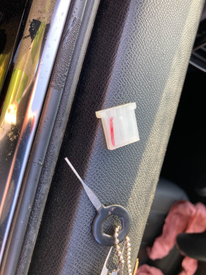

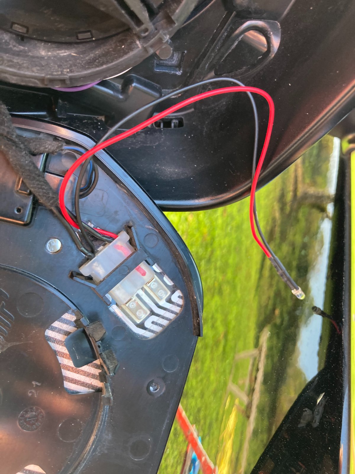

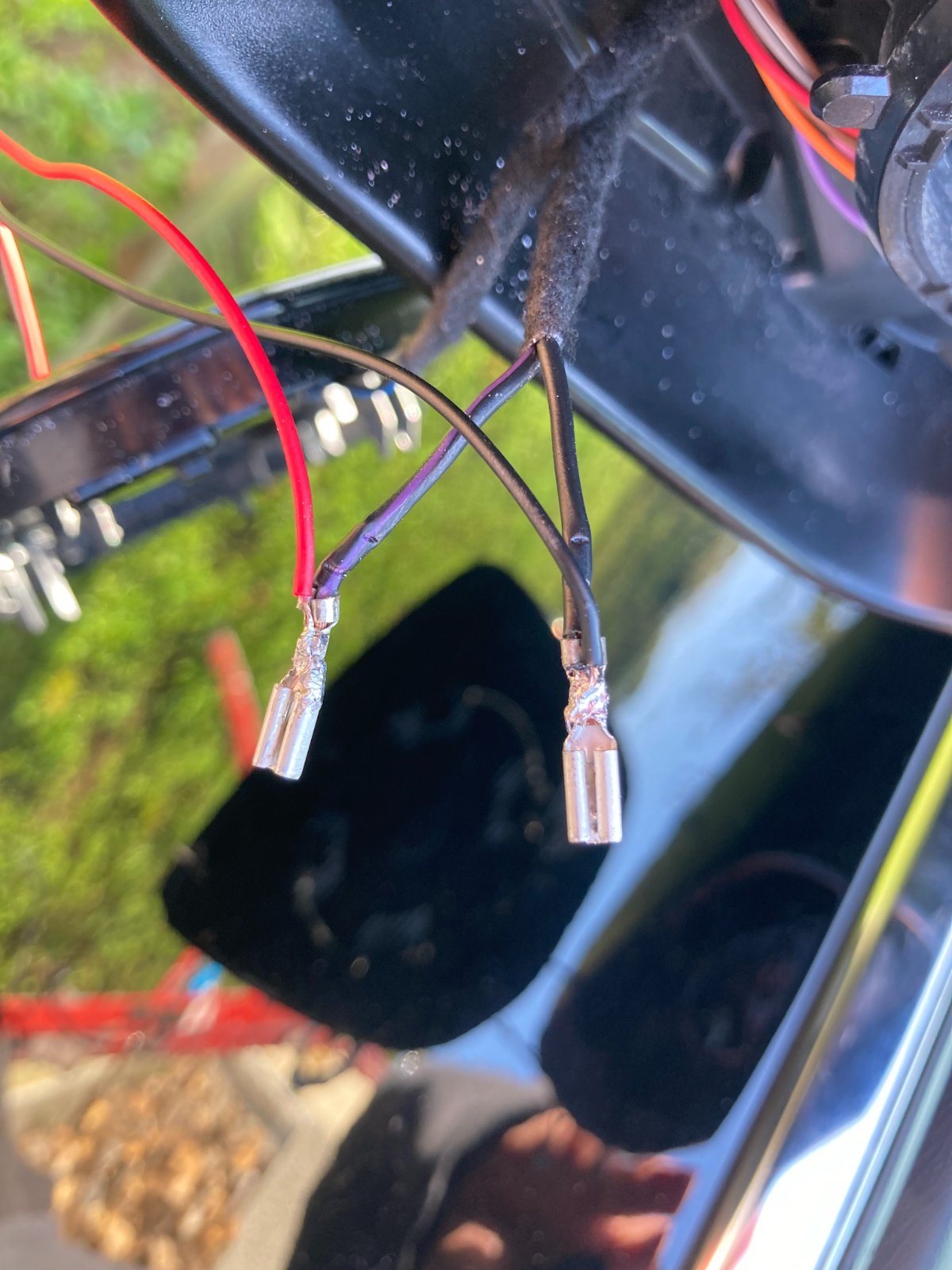

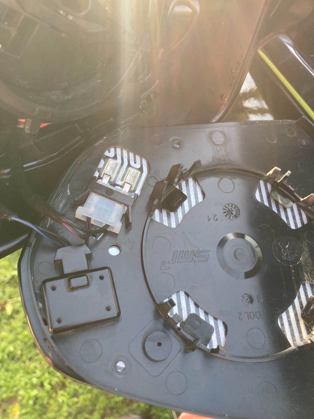

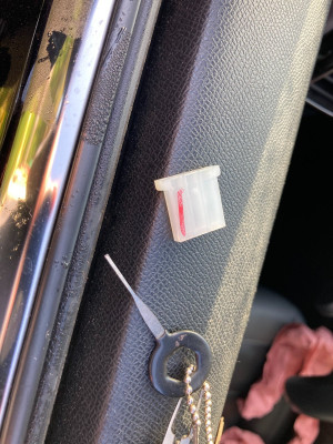

Tilt glass in and up and use fingers or plastic pry tool to pop out glass, The heater wires are the white plug, the one with the stripe is positive but check with a meter or LED, LED will only work the right way, run engine and turn mirror heaters on to identify which one if needed. Mark the positive one on the plug
I used a terminal tool to remove the 2 spade connectors from the white plug, You can bare the wires if you didn't want to do that. You can run the car again to test before going any further. I then measured the LED Diameter and drilled a hole to poke it through so it will be visible when glass back in housing, secure it with silicon or glue gun, I also secured the extra length of wire with a blob from the glue gun. Pop the glass back in and that's it done. When car having a regen red light will come on, also when heated mirrors on.. Hope this all makes sense.

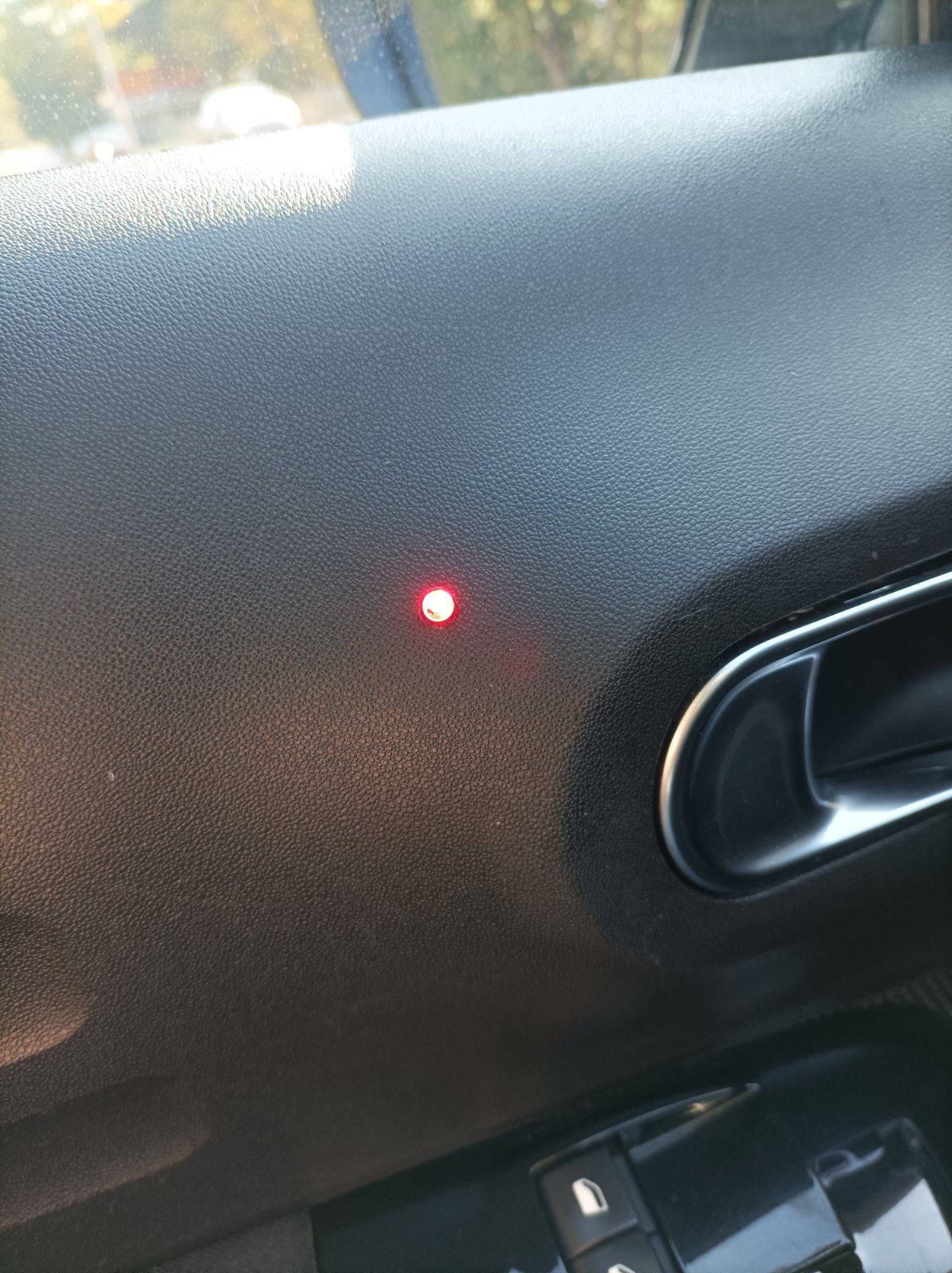

Mihael_M
Posts: 194
Joined: 14 Aug 2024, 18:58
x 37
Re: Dpf regen
Unread post by Mihael_M »
I also installed Led, but I thought that it was easier and better to install it and to see it from the inside of the door. Now it is visible to me even when the sun is bright.
