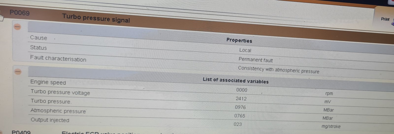

Have problem with a 407 1.6hdi.
The code is p0069 and I have checked the map sensor and its fine. The fault pop up direct when the ignition is turned on, without starting the engine.
Turbo boost pressure seems correct against the actual real atmospheric pressure (976mbar) with the engine off. Checked this value with another car that also showed 980mbar.
But the atmospheric pressure that the ecu reads is way off, 765mbar.

I have changed the map sensor without any luck. I attached a picture from diagbox.

The differens between turbo pressure and atmospheric pressure to big.
But where is the sensor that delivers this atmospheric value?

When the ignition is turned on the ecu compare the map senor value against a other pressure sensor to check that the sensors work correctly. Map sensor seems to be called turbo pressure in diagbox, and I wondering where the other sensor I located that gives the signal for atmospheric pressure.
Most likely it is placed directly on the pcb of the ecu, but I'm not sure.
And MAP = manifold absolute pressure, not atmospheric.

When I have diagbox connected the atmospheric pressure is all over the place. Varying between 600mbar to 750mbar.
Permanents fault are now:
P0069
P0490
P1162
P1351
P0409
New delphi erg valve part number: eg10507 12v1 is mounted and a new intake pressure sensor. The egr is programed with diagbox, but it seems to fail.
Did some measurement between the ecu and egr connector and the cables seems to be okay. When I do the actuator test the valve moves okay.
So what to do next. Could the problem be the Ecu?
