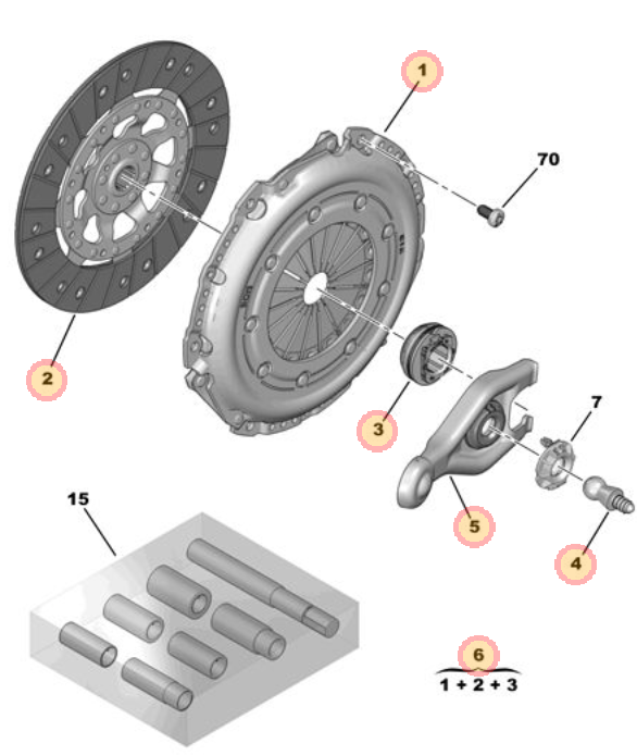

I've only just got round to your post. Thanks for your Forum donation. Any future parts requests, please post them up here:Official Parts Thread
Here are the official part numbers for your vehicle. You can use these to search for cheaper aftermarket alternatives, but these are the original options as fitted from factory:
Clutch
You have choice of components or a clutch kit.
(1) Clutch, part: 2004AN, £225.94
(2) Clutch Plate, part: 2055CL, £185.30
(3) Clutch Release Bearing, part: 1611266780, £46.76
(4) Declutch Fork Ball Joint, part: 212050, £6.76
(5) Declutch Fork, part: 211766, £62.86
Clutch Kits Includes (1) + (2) + (3)
(6) Pro Clutch Kit Valeo, part: 2052L2, £462.26

Clutch
E Clutch Valeo, part: 1636267680, £128.62
Standard Exchange Clutch Kit Valeo, part: 2051T7, £251.16

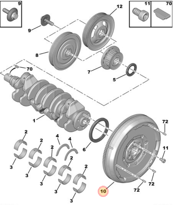

Flywheel / Flywheel with Clutch Option
(10) OEM, Clutch Kit with Dual Mass Flywheel, part: 2052X4, £462.26
Dual Mass Flywheel, part: 0532P7, £509.40
Standard Exchange DMF, part: 1613938580, £577.57
E Clutch PSA, part: 1680364780, £224.59
Flywheel Screw, part: 203708, £2.10
